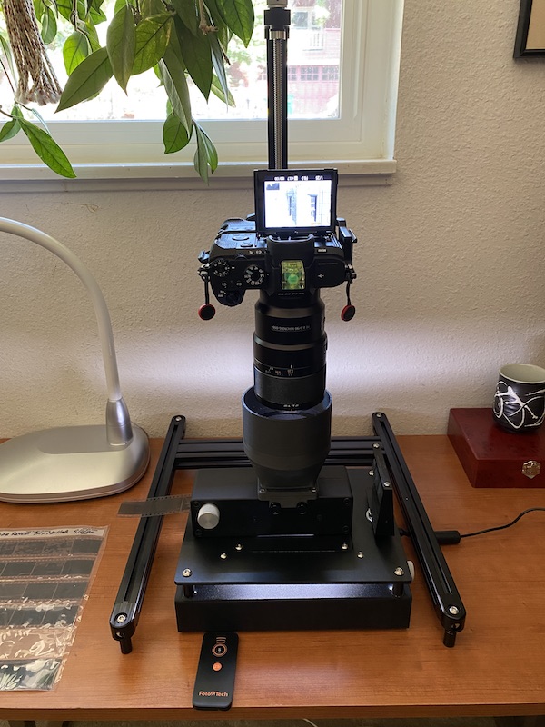

I had sent a bunch of gear to KEH with the intention of buying a A7. While they were processing my quote, B&H offered up brand new A7IIs' for $800 usd. The lens was a Ebay find for $600. The joke is I have three grand worth of equipment to scan the negatives from my two hundred dollar camera.
I never tried camera copying as I used a V600 about $225 and now have a V850 about $1100. So I never compared camera vs flat bed results.
The camera setup seems nice. But it would be better if someone could figure out a way to handle automatic multi copying. The flatbed allows 20 shots at one time including either for 35mm strips or for older slide-mounted 35mm. It also has ICE and other feature camera copying doesn't. The other big advantage for me is that I also shoot medium format 120 film and 4x5 large format film now. Of course the latter needs the V850 which is more expensive.

If you can come up with a decent quality "box" that handles the illumination and film handling and optical requirements and only requires me to mount my wife's micro 4/3 camera to it, then we can talk.
Even illumination is not that hard. Especially if you have plenty of light to waste in diffusion, as with a flash.
You are essentially doing 1:1 or larger macro, so not anything a projector or enlarger is not also doing.

And you mean something like the Filmtoaster?https://www.filmtoaster.photography/
Problem with most people designing stuff like this, is that they implicitly also want to get rich quick, and have no idea about industrial production design or market research.
The film toaster is a prime example of that. Designing it with all these extras and options and even a toilet roll holder on the side is just at the same time glaringly arrogant and naive.
We need a simple box with a universal body mount, an enlarger lens screw-mount inside and with a backlight and a piece of liftable AN glass on top of the light.
And then a way to slide either the mounted camera or the mounted film around in a rigid plane.
Shouldn’t cost much to make or be too hard to get funded, if you look at the much more complex but much narrowly target grouped stuff that is crowdfunded several times over on a regular basis.

While we wait for someone to do that, it doesn’t need to be that expensive (or hard) to do your own.
In fact a smaller higher pitch sensor is preferable. Exposure time and sensitivity is not the limiting factor it is with live stills.
A used M43, a macro or reversed enlarger lens, an old enlarger bed and column with the appropriate tripod mount and a backlight is really all you need for more than good enough results.
Far better than anything scanned on current consumer scanners.

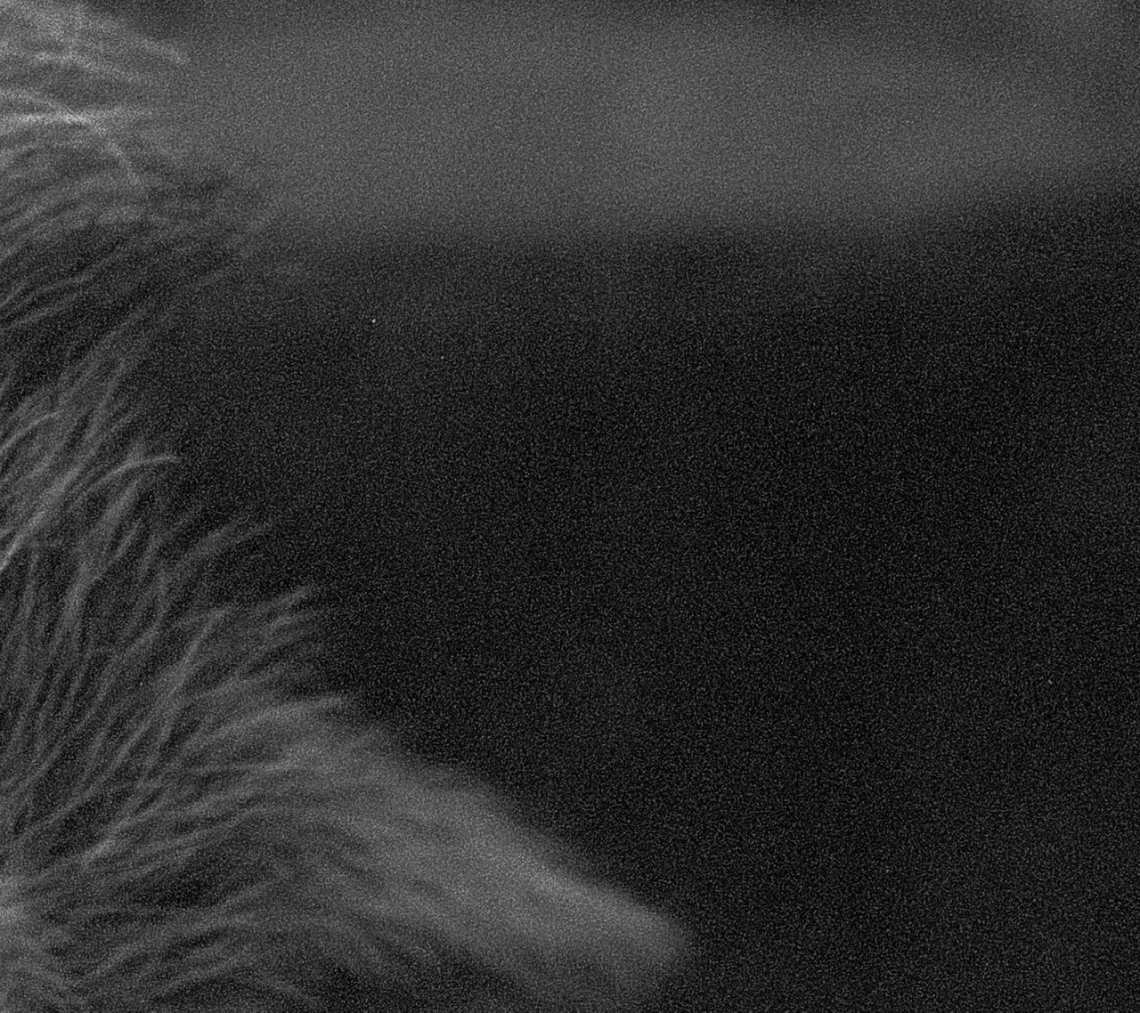

I use silver fast exclusively and love the results.
The pig and Hamon pictures I posted are silverfast
Do you not see the vertical banding in your scans? That's unfortunate because the photos themselves are cool. I hope you kept the negatives to be properly re-scanned later with a camera :smile:
Where?
Smooth/blurry background areas are severely affected, the textured parts of the photo mask the banding somewhat. BTW, this is a well known issue with your scanner. The 120 versions of Plustek are also badly engineered.
Point to it. This is 645. If there is vertical banding “which some flatbeds have” “mine is not a flat bed” it should be horizontal. so unless you see horizontal banding you are wrong.
You can see horizontal banding (blurred/defocused bands). Not terrible, but definitely there.
There is both horizontal and vertical artefacting.
Also, I’d say clear grain aliasing. If this is Delta 100, that is very grainy. And/or you developed it in Rodinal 1+24.
The photos are fine, (maybe a tad less greedy with shallow depth of field would have been good) and the exposure looks good.
It’s the rest that looks wanting.
