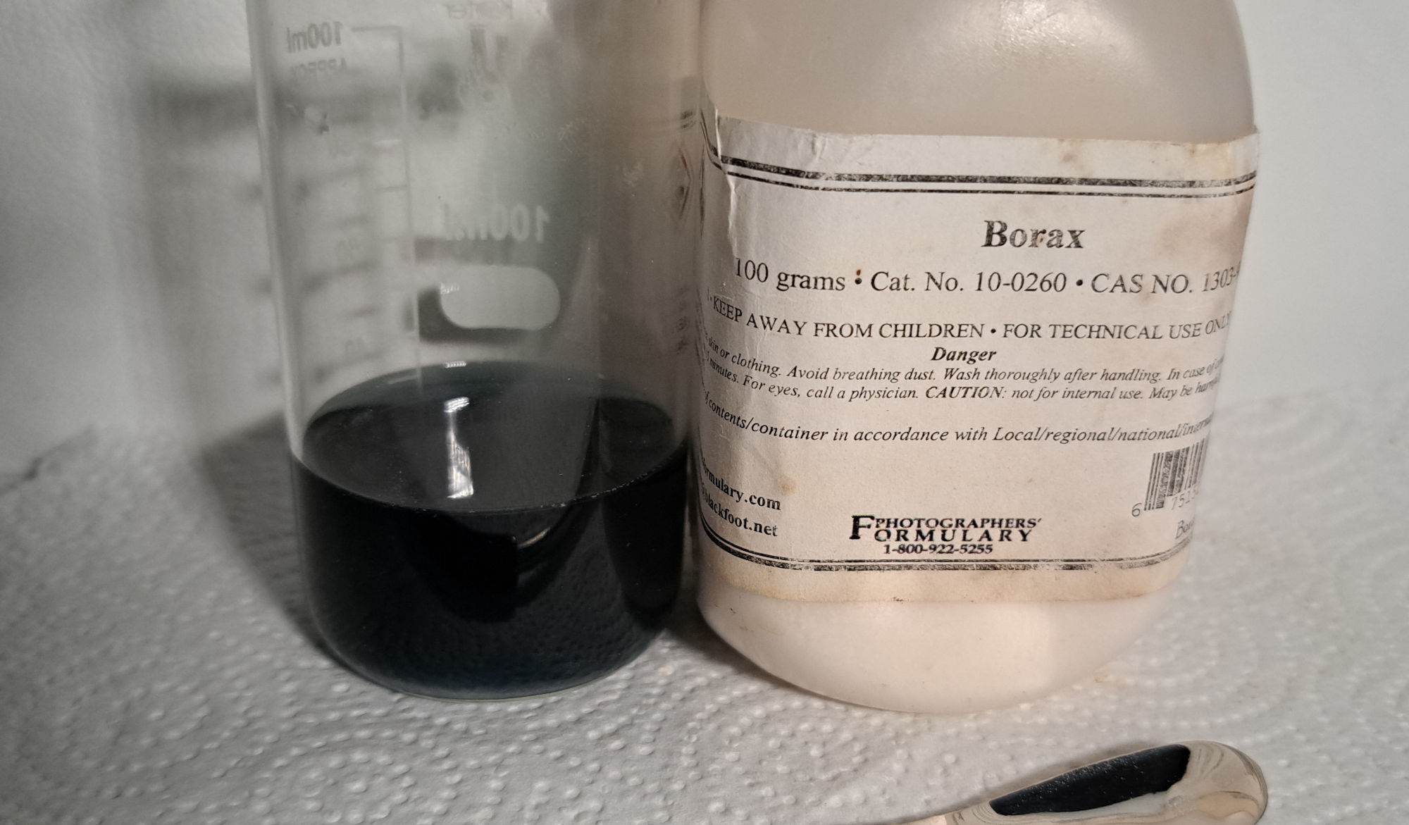

Sorry to bring this issue up again, but I had a moment today to test the idea posted by @Donald Qualls to add alkali to the dye solution to see if it would change color. I added some borax to the solution, and the color remained unchanged. I kind of expected that, but I just wanted to be thorough.
