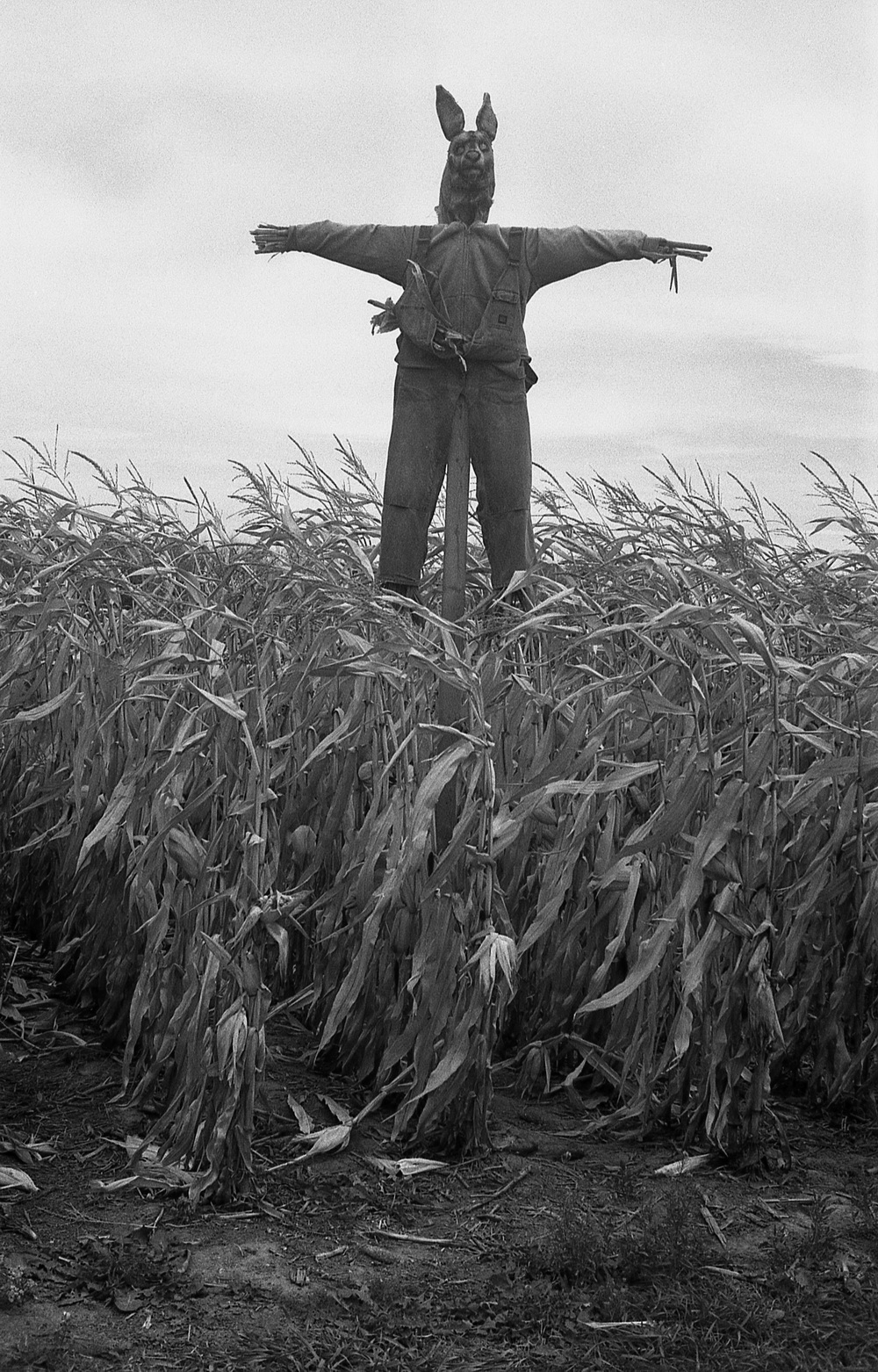

My contribution. First roll. I got a number of underexposed but most were fine. I rotary developed for 10 minutes in D76 1:1 but did a 5 minute borax bath after that was done - which is exactly what I do with Rollei Superpan 200 (Aviphot 200) (well, I go for 10 minutes 45 seconds with that, shot at iso160).
Canon VL. Can't remember which lens was on it for this.
That is an authentically scary scarecrow. It’s giving me the creeps!
Excellent result!
