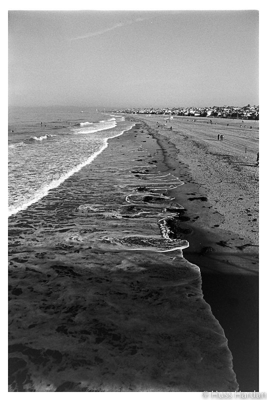

Another one shot at ISO 200. The darker foreground area is shadow from the pier I am standing on.
Everyone as their own taste, but for me I would use this film to embrace its contrasty vibe. I don't see the point in fighting it to make it something it is not.
IMO - remember IMO! - just use a different film if you want wider exposure latitudes etc. There are so many out there - cheaper than Catlabs - that for actual use why wrestle with this one if that is the result you want?
I understand it is cool to see what can be done, but after that?

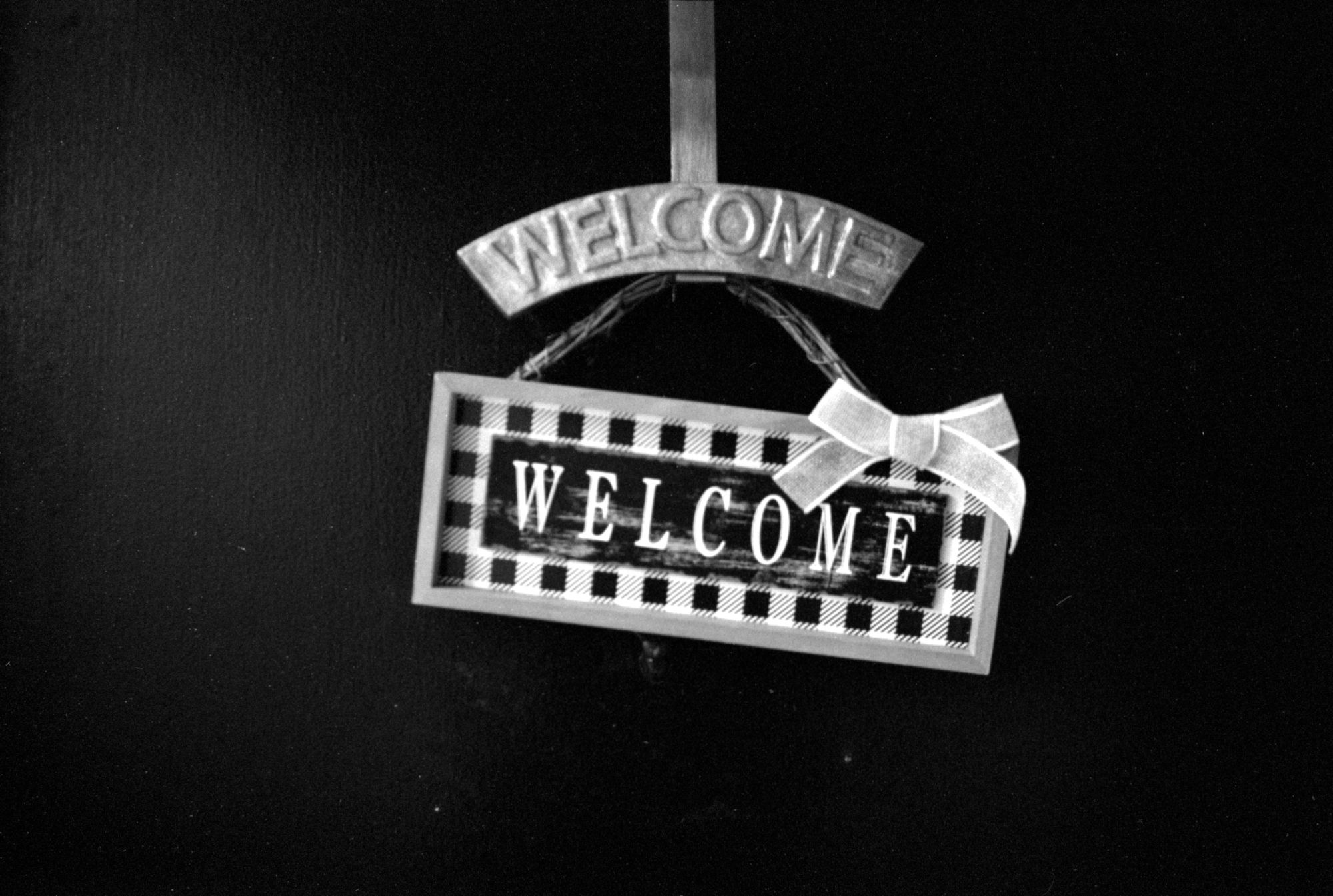

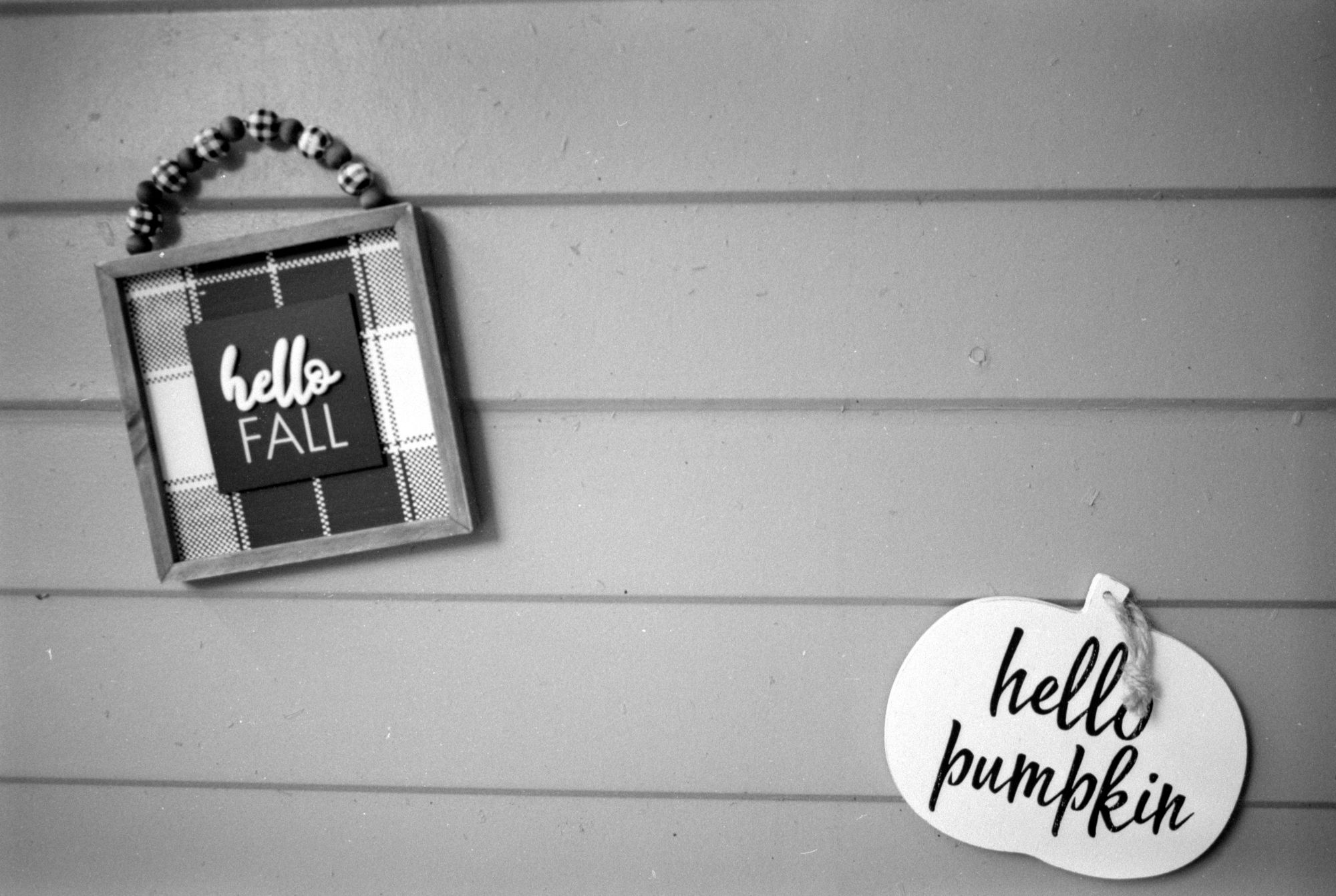

I have two more frames of the Catlabs Pro 320 to share showing how the long toe, the steep transition to the lower mid-tones, and the extended ZV and ZVI tonality can produce nice separation in dull, low-contrast scenes. These two were taken in deep shade, wide-open at f/2.8 1/60s. I really like the (unmanipulated) contrast here. In that regard, I agree with @warden that the results are similar to those of the Ferrania P30, which I shot just the other week and which I happen to really like. Its spectral response is quite different, but it's capable of producing nice contrast when needed. I also confirmed that the Catlabs film seems compatible with the Edwal Anti-Stat cleaner, which is one of my favorite darkroom accessories. It can rescue negatives from fingerprints, dust, water drying marks, even grease spots.
In principle, I completely agree with you. I suppose most people here would choose a film and processing combination for a specific purpose or vibe to suit their creative choice. Having said that, when I set out to test this film, I had to choose a set of widely known and accepted criteria so that the results of the tests would be generalizable. If I just said, "hey, this is a punchy film" without any familiar frame of reference, such a statement would be meaningless, as it would just be an opinion.
It's not about seeing what can be done, it's about seeing how the film responds to exposure and development within a broadly accepted frame of reference. After that, it's up to the photographer to decide what they do with it.

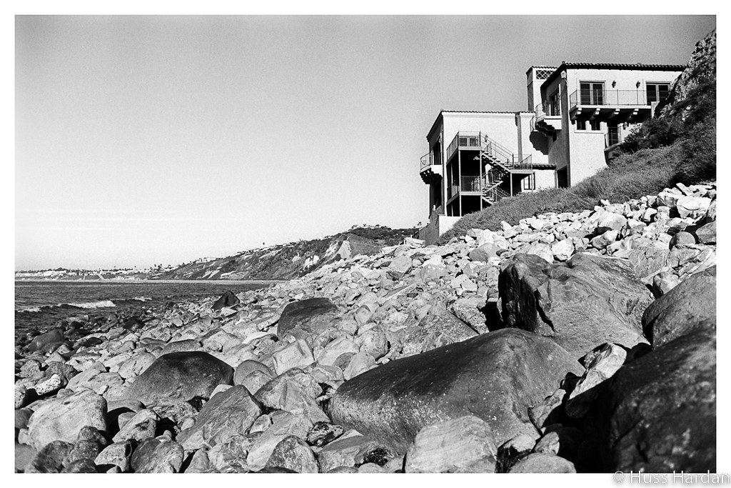

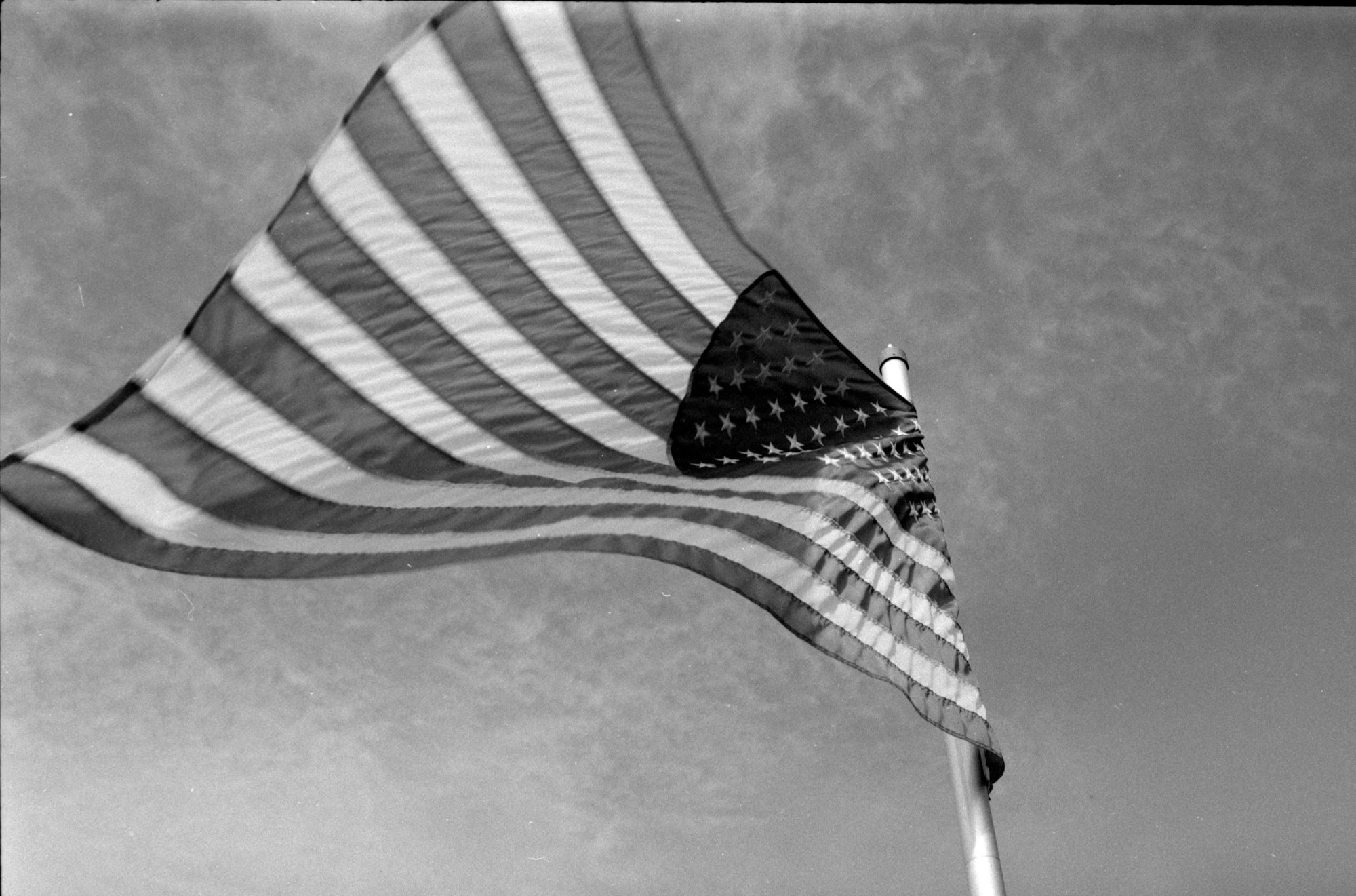

Thanks for sharing the flag image! Here is a wet print I made while experimenting with P30. See what it does to the flag? 😄
It's a gorgeous print, with beautiful tonality all the way through. As to the flag, wow!
ISO 200 + bromide streaks.
I love it! Everything works here, from location to composition, to tonality. I don't even mind the streaks. Could you reveal the part of the world this is?
As the flag is relatively small I found it was difficult for me to determine if the blue on it was darker than the red or about the same but it seems to me that it is a good example of the case for a spectral sensitivity curve or information to be provided so users can determine where an appropriate filter is necessary
In the case of most films blue and red are different but if I were using this at a sports event such as soccer match I may not be able to rely on the usual difference between red and blue shirts on b&w film to show up
pentaxuser
Yes!, and in lieu of that a simple “experiment “ as was done in post 251 gives good clues.

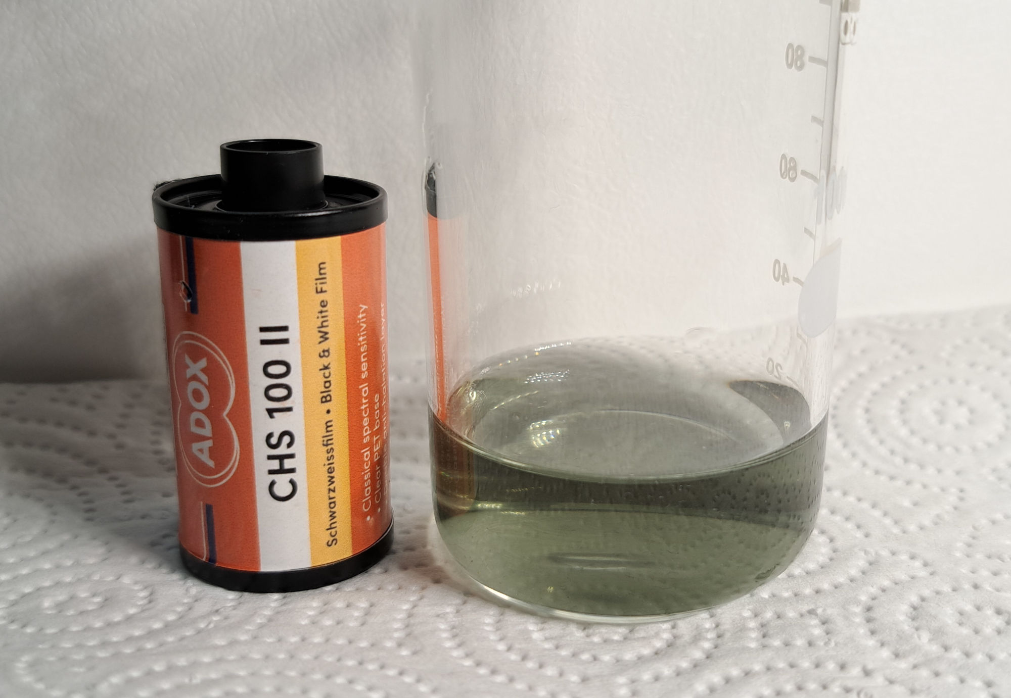

Thanks! He shot the 120, and I shot the 35 mm film, so the gray dye might be the layer coated on the back side of the film to prevent fogging through the film leader sticking out of the canister. That seems to be a requirement for films coated on polyster base, according to Adox. I have an Adox film and will test this hypothesis soon.
Thanks! Taken by Palos Verdes Estates, which is next to Redondo Beach just south of Los Angeles.

I put a small piece of Adox CHS 100 II in water for a couple of minutes, and got the same color dye as the Catlabs Pro 320. It would not surprise me if this film was made by the same manufacturer and/or designed by the same people, using a similar technology. I cannot recall there being a similar dye in the 35 mm films from Kodak, Ilford, or Foma. Does anyone know?
