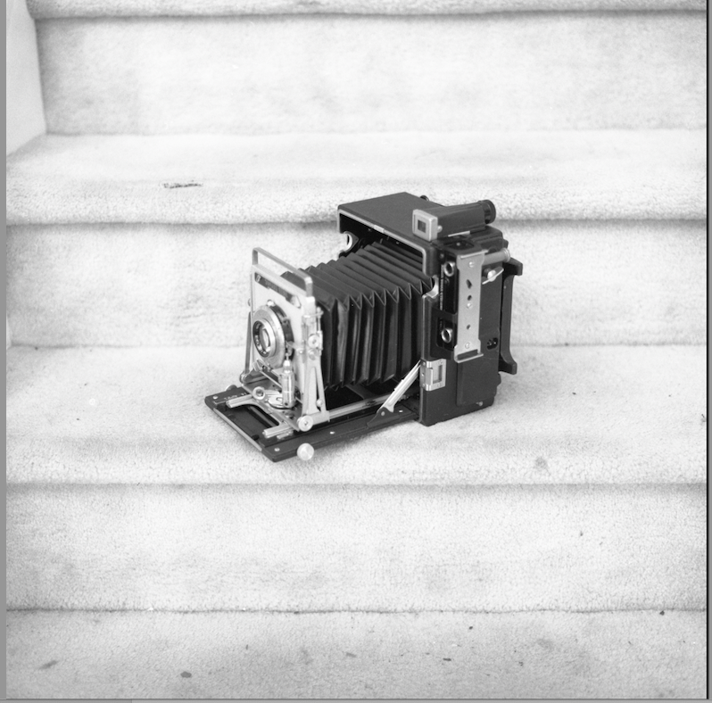

Graflex speed graphic in my foyer - lots of mid day sunlight
1/500 handheld, Tmax 400 film, f/8 Focused dead nuts on the front (3rd) bellow

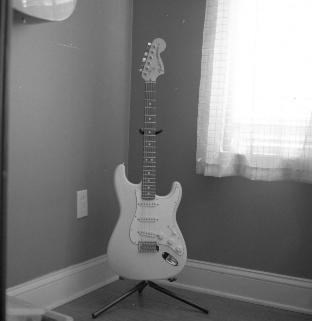

Fender strat in my office
1/125 handheld, Tmax 400 film, f/5.6 focus dead-nuts on the 12th fret.

1. DOF in medium and large format is shallower than full frame/APS C sensor/ 35mm film.
2. Lathe photo=camera shake!
3. DOF; first Graphic I've seen with the rangefinder, optical viewfinder, FPS control on the left.:smile:
4. Guitar=DOF.

The tree image looks pretty good, as well as the Graflex, but I bet they would be sharper with a tripod, and a cable release. That could be the problem.
1/500 and 1/125 shouldn't be camera shake (although photo #2 does look like camera shake). And if the shutter were sticking, the pictures should be heavily overexposed. And if the focus was being missed, I would expect there to be a plane of sharp focus somewhere in the image.
