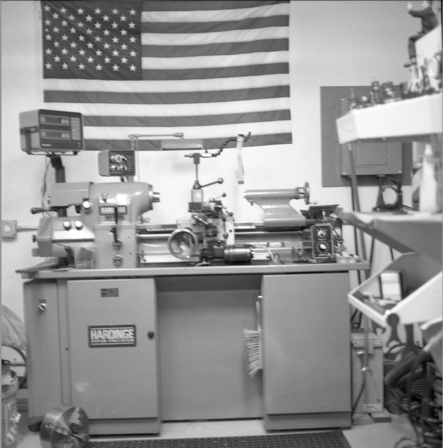

Hardinge lathe in my shop: 1/125 handheld, Tmax 400 film, f/8. Dead nuts focused on the middle tool post.

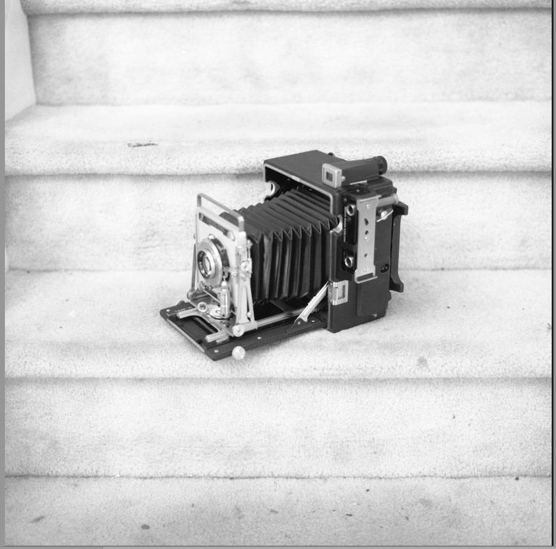

Graflex speed graphic in my foyer - lots of mid day sunlight
1/500 handheld, Tmax 400 film, f/8 Focused dead nuts on the front (3rd) bellow

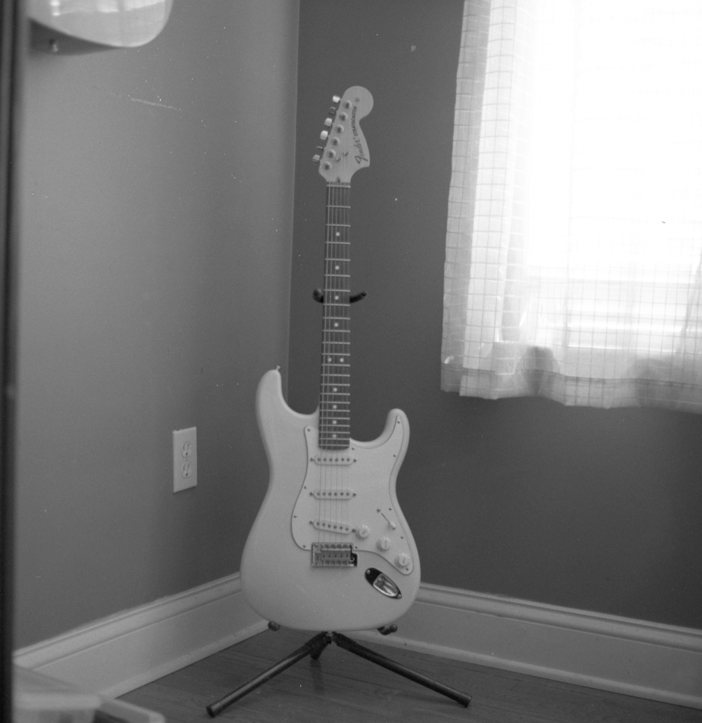

Fender strat in my office
1/125 handheld, Tmax 400 film, f/5.6 focus dead-nuts on the 12th fret.
