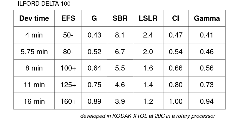

And here's the summary table:

For 8 min dev time (and a few other cases), gamma is lower than G or CI. Seems counter intuitive since G or CI include part of the toe.
Can you please comment. Even better mark on the 8-min D-logE curve the segments actually used to derive gamma, G, CI.
Thank you.
Where do all you guy come up with all this, "looks like digital" nonsense?
I use this film in 4x5 and I don't have near the experience that you have with it but these observations on TMX I find are somewhat of a head scratcher myself. It's odd opinion........imo, 🙂. To each their own.
Thank you.
That's a great observation! Thank you for bringing it up. Gamma is a parameter that does not always fit the characteristic curve well. It relies on identifying the "straight-line" portion of the curve. Back in the 1940s and 1950s when the research into film was at its peak, the mathematical model of the film curve assumed the existence of the toe and clearly-defined straight-line portion of the curve (and a shoulder, if needed). With such curves, Gamma works very well. It's easy to unambiguously identify the portion of the curve. However, with more complex curves, especially those with significant curvature in the midtones, the statistically derived straight-line portion of the curve may not always correspond to what, typically, the photographer would identify as such. There's an interesting discussion of that issue in this thread. I hope this helps.
So, to sum up, because of the problematic nature of Gamma, other measures of the slope were created, with the Contrast Index and Average Gradient being the two most dominant models over the years. And finally, my program computes Gamma by identifying the straight-line portion of the curve statistically, so it may not always be the best "fit" for the photographer. That's why the Contrast Index and Average Gradient are probably more useful in this type of analysis.

@aparat I suspect the maximum value of the derivative of the function that describes the characteristic curve is a very good approximation of gamma. I can only see it fail if the film doesn't shoulder at all and has an upswept curve at the highlights. Perhaps disregarding that area can take care of this.

(...snip...)Gamma is a parameter that does not always fit the characteristic curve well. It relies on identifying the "straight-line" portion of the curve. Back in the 1940s and 1950s when the research into film was at its peak, the mathematical model of the film curve assumed the existence of the toe and clearly-defined straight-line portion of the curve (and a shoulder, if needed). With such curves, Gamma works very well. It's easy to unambiguously identify the portion of the curve. However, with more complex curves, especially those with significant curvature in the midtones, the statistically derived straight-line portion of the curve may not always correspond to what, typically, the photographer would identify as such. There's an interesting discussion of that issue in this thread. I hope this helps.
(...snip...) And finally, my program computes Gamma by identifying the straight-line portion of the curve statistically, so it may not always be the best "fit" for the photographer. That's why the Contrast Index and Average Gradient are probably more useful in this type of analysis.
@aparat,
I have digitized (with suitable freeware) your curve for Delta100 in Xtol 8min, as shown in your post #210 above. Using basic software LibreOffice Calc) I have plotted
  • all digitized points : small blue dots
  • points selected by me as representative of the "straight-line portion"; choice did not seem critical or problematic
  • a least-squares fit of a linear relation to the above-mentioned "straight-line portion", and the corresponding equation
Rounding up by 0.002, the gamma results as 0.70. Not 0.56. And identifying the straight-line portion is not problematic, as one can see at a glance from the near-perfect agreement between the fit line and the red crosses.
I don't know what is (what might be) a statistically derived value of gamma, when there is one data set to work with.
A separate point. In my opinion, CI and G-bar were not created because the straight-line portion of the D-logE curve was difficult to identify. But rather because in actual use for pictorial photography, the scene values are not generally placed entirely in the straight-line portion (except maybe for reproduction work). But rather with some shadow values in the toe; so that for the purpose of translating scene brightness range to density range, CI or G-bar are more useful.
Might sound like I'm nagging at your valuable work. Not so. You have provided lots of excellent and useful data. My remarks aim to help you correct what I perceive as errors.
Obtaining the derivative of a function defined by experimental data is tricky, because differentiation amplifies measurement noise. To avoid this one must replace the actual data by a model with suitable "smoothness". See e.g. https://www.photrio.com/forum/threads/comparing-paper-characteristic-curves.171700/post-2235872
But this is a tricky business; if one is not careful, soon one is discussing properties of the chosen model, having nothing to do with the data and he real world.
