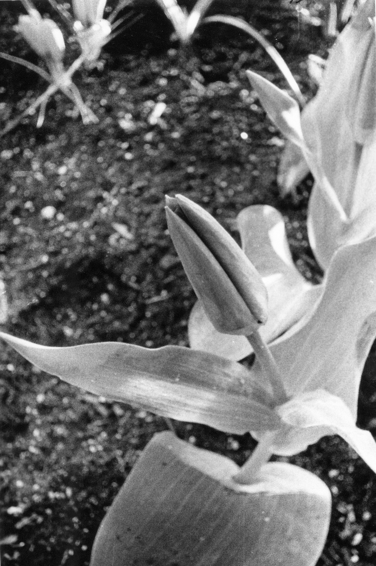

When I began my second period of shooting with a Minox submini in 1995 (I'd first had one back in the late 60s), I started with the Agfapan APX 100 factory loads Minox was selling at the time. In a quest for better results, I tried nearly all the 100- and 125-speed films of the 90s, and a number of developers... though I always came back to D-76. I ultimately settled on T-Max 100 as my Minox film after first trying it in a Nikon F2. There was no question, it had the finest grain... which essentially trumped every other concern with the pinky-nail-sized Minox negative.
(T-Max 100, scan from a 5x7 print from an 8xllmm Minox negative)
But there was literally nothing else I liked about T-Max 100. Contrast was harsh, with frequent blocked highlights. Exposure latitude was very narrow compared to old-tech emulsions like Plus-X and Agfapan - which was significant, because I was estimating exposure. (So, I often bracketed: film cost was negligible because I was loading my own Minox cassettes for about a dollar a roll.) Development had to be MUCH more precise re time/temp/agitation vs. the older films, with far more time spent in fixing and washing to get that purple dye out. Enlarging was often a challenge because of the strong contrast...
I just never liked the LOOK of T-Max 100 compared to the older films. But I kept using it in the Minox, since the fine grain allowed for 5x7 prints (a rarity with the other emulsions, I mostly printed them only as 4x5s). But wherever grain wasn't the big concern, I didn't use it. I've never shot it in 35mm, apart from that one test roll (I tried a roll of TMY once too - and found it too contrasty). I finally stopped shooting with my Minox about five years ago and haven't used TMX since.
