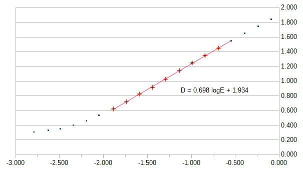

I have digitized (with suitable freeware) your curve for Delta100 in Xtol 8min, as shown in your post #210 above. Using basic software LibreOffice Calc) I have plotted
  • all digitized points : small blue dots
  • points selected by me as representative of the "straight-line portion"; choice did not seem critical or problematic
  • a least-squares fit of a linear relation to the above-mentioned "straight-line portion", and the corresponding equation
Rounding up by 0.002, the gamma results as 0.70. Not 0.56. And identifying the straight-line portion is not problematic, as one can see at a glance from the near-perfect agreement between the fit line and the red crosses.
I don't know what is (what might be) a statistically derived value of gamma, when there is one data set to work with.
A separate point. In my opinion, CI and G-bar were not created because the straight-line portion of the D-logE curve was difficult to identify. But rather because in actual use for pictorial photography, the scene values are not generally placed entirely in the straight-line portion (except maybe for reproduction work). But rather with some shadow values in the toe; so that for the purpose of translating scene brightness range to density range, CI or G-bar are more useful.
Might sound like I'm nagging at your valuable work. Not so. You have provided lots of excellent and useful data. My remarks aim to help you correct what I perceive as errors.

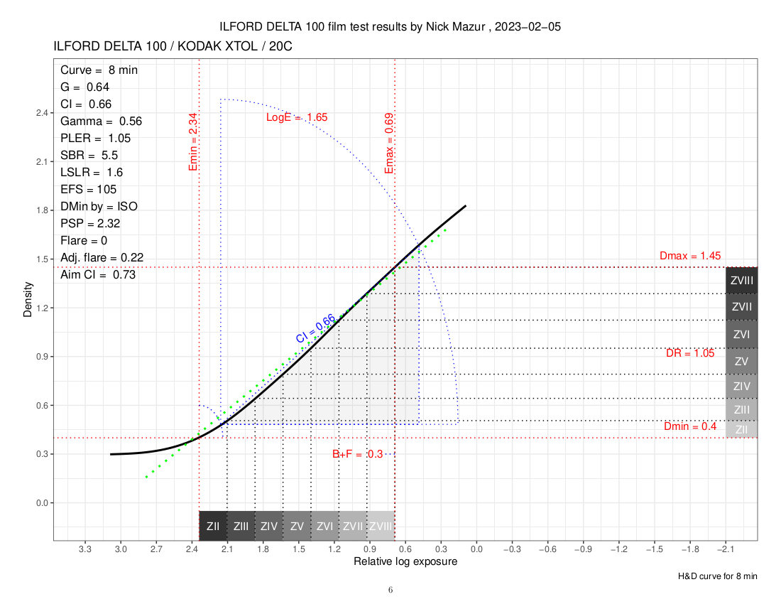

Thank you for your thorough questions and comments. I appreciate them very much, especially as a learning opportunity! As @Anon Ymous pointed out, Gamma is a tricky parameter to calculate. I am sure you've seen lots of curves where it is not obvious where that straight line is, thus making it subject to interpretation. I decided to use a K-Means Clustering Algorithm that seeks a pattern (clusters) in an unknown data set, basically. Is it perfect? Absolutely not. My program does everything automatically, which is both a good thing and a bad thing. The model of the characteristic curve is often to blame. It works very nicely with most curves, but it fails with "lumpy" ones (especially with multiple local non-linearities) in sometimes producing spurious values. It's rare, but it happens. There will always be photographers who find this unacceptable, and that's perfectly fair. In my program, the user can manually specify which part of the curve to use, so you can just click and drag over the portion you specified, and you will obtain the same result as you did. But then, one opens another can of worms, so to speak. I prefer to not do that myself.
Here's a more detailed plot of that eight-minute curve you mentioned. It shows the Contrast Index calculation (in dotted blue lines) and Gamma (dashed green line). The green line does not coincide with the line you identified, but, as far as the algorithm is concerned, this line represents the "straight-line" portion of the curve. Which one is more correct? That depends on the point of view, unfortunately. I wish this was a simple thing. This is why, I almost always use the CI to estimate contrast. It's just a lot more unambiguous.
There is a lot more to it, and I would be more than happy to discuss it with you, but perhaps a new thread would be needed, or off-line. I am afraid, details like this aren't relevant to this particular thread. The last thing I want is for photographers to be dissuaded from quantitative analysis because it appears way too complex. The idea is to hide a lot of the complexity and present a view of the data that is easy to digest and implement in practice.

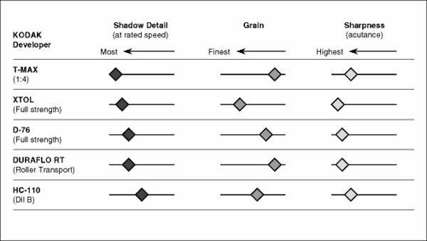

Kodak has a history of using similar brand names for entirely unrelated products. Think of all of the products that have Ekta or Ektar in the name. I wonder if Kodak was thinking that Tmax was their hot new brand name, and they wanted to slap it on as many products as possible.
According to Kodak's developer comparison chart, Tmax developer has the best shadow detail (film speed), but only by hair over Xtol. But in grain size, it was the worst. Maybe there was a rationale that if the initial versions of Tmax films were touchy about exposure, some extra speed would allow a greater margin of error when shooting at box speed. Since Tmax films were fine-grained, maybe it would be okay to lose something in grain size.
But that rationale only goes so far. I have not used Tmax developer, but my impression is that it is a speed-increasing developer in a convenient liquid form. So, it may be roughly similar to other speed-increasing developers like Ilford Microphen. So one might use Tmax developer for the same reason they would use other speed-increasing developers, but it not may not be categorically different with Tmax films.
