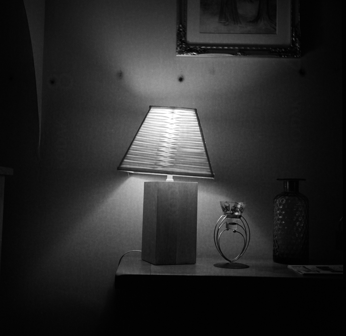

The OP has been quite forthcoming with info on the latest reported experience. Perhaps one more piece? What camera were you using?
Answered earlier in the thread, a Mamiya C330. I've run multiple rolls of Portra 400, XP2 and Neopan 400CN (Fuji branded XP2) before with no issue. This was the first roll of TMAX400 through it.
Other rolls from this batch of TMAX I've run through a Zeiss Ikon Nettar without issue.
Checked on my Amazon order, and the film was from Amazon themselves rather than a third party seller.
Thanks and sorry I missed that piece of info.
Not based on reports, but based on ONE single report that contains little or no evidence except for the reporter's claims that it is a case of THE backing paper problem. IMHO, you are jumping to conclusions.
Given the breadth and depth of the information provided I wouldn’t know what else to suspect. What do you think caused the problematic images?

Sorry to drag this back up again, but just to report that I've just developed a roll of TMY-2 in the lab, emulsion code 0155-001 it has the problem (backing paper mottle and number imprint) - this is clearly visible in the negative, not just when scanned
please please contact Kodak Alaris and see what they can tell you. (then report back to us)
Backing paper mottle is usually a sign of exposure to excess humidity - long a known potential issue with all 120 films. Often a result of insufficient warming up time from colder storage conditions.
I've contacted Kodak Alaris, will report back when they reply. Here is an example frame
