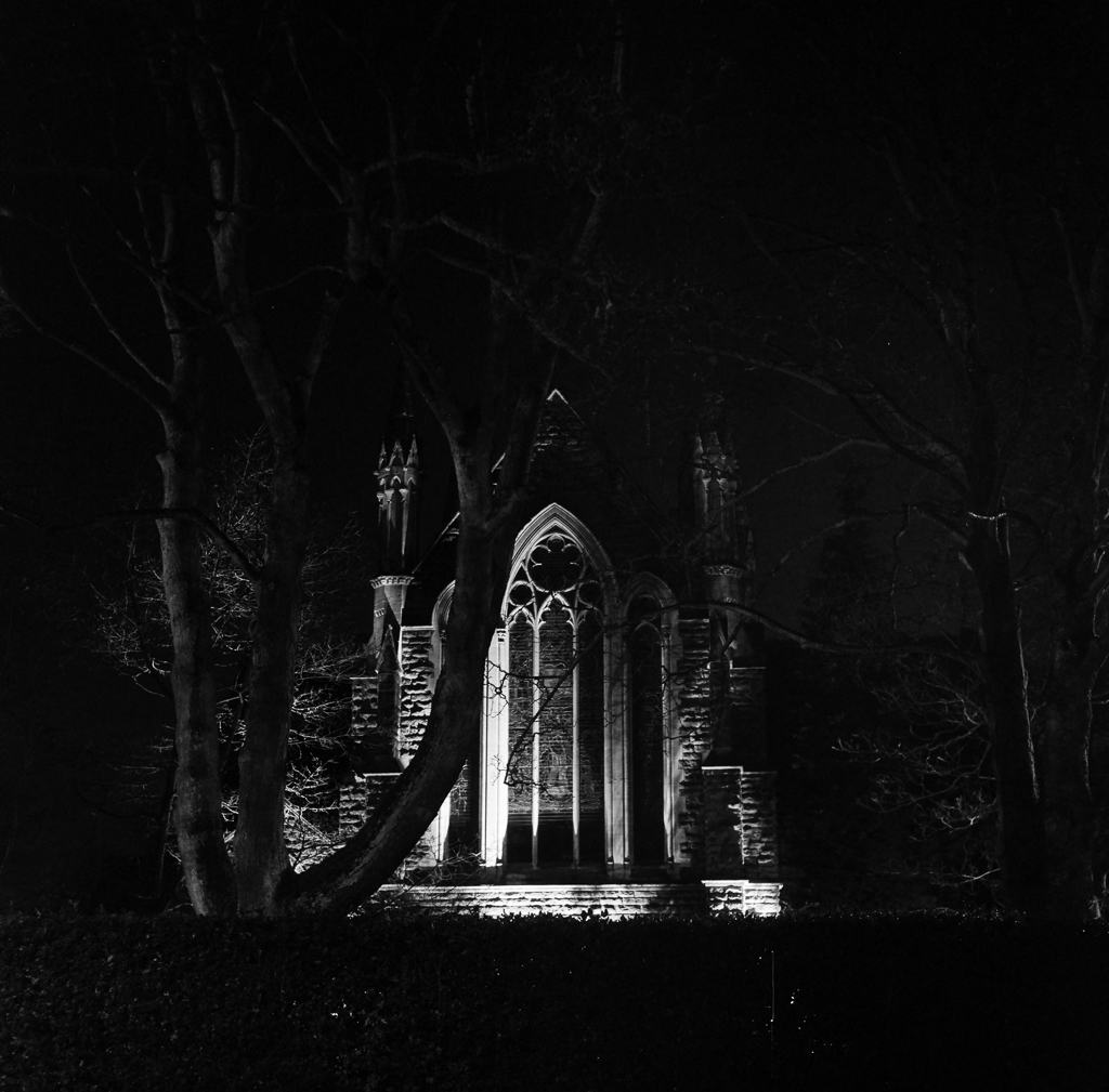

All photos taken with a Mamiya C330. All shots from the same roll. Stored at room temp (15-22C), it's winter here in the UK so no extremes in heat here.
Developed two weeks after exposure.
The photo in question. A failed shot at roughly 5min exposure.

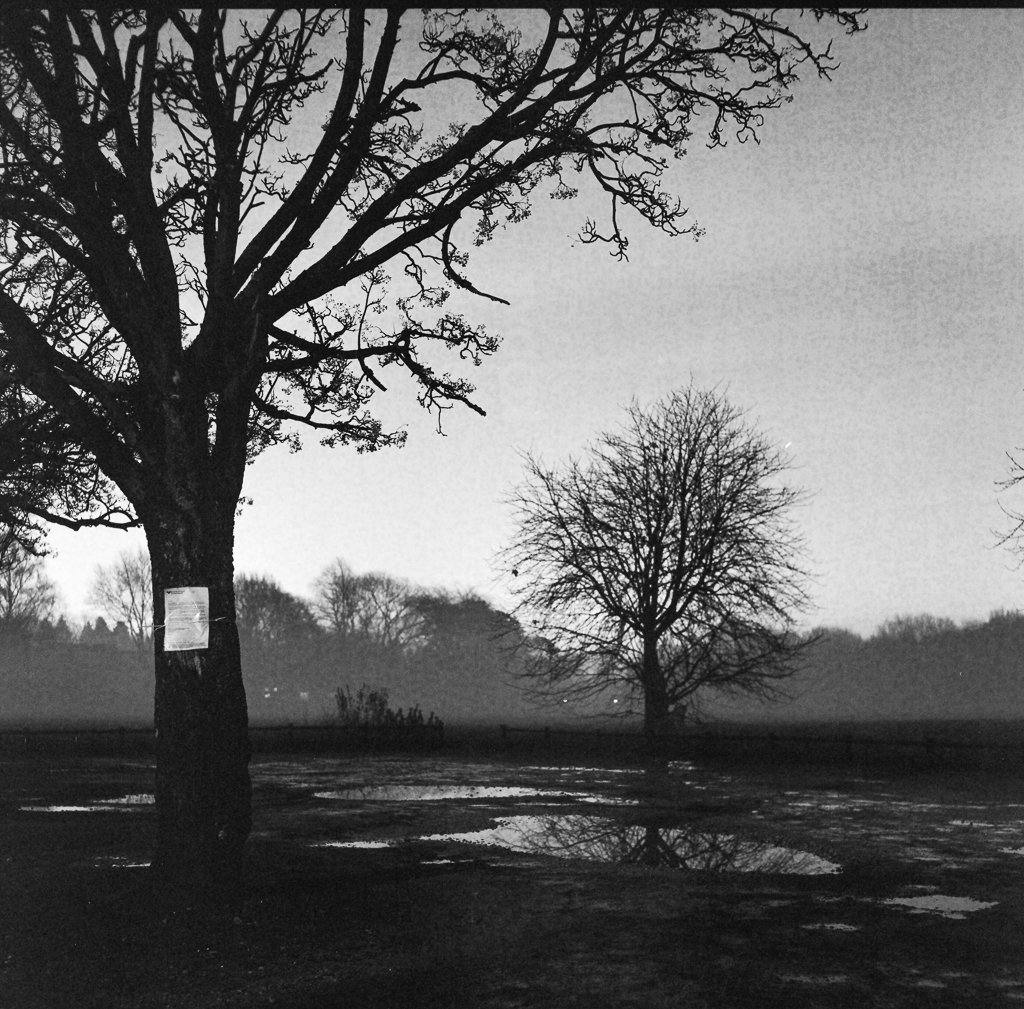

Second, another shot from the same roll. 3min exposure

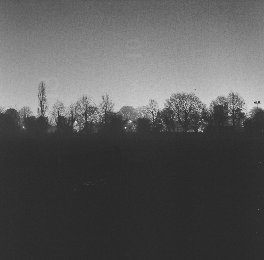

And another image from the same roll, sub 1min exposure
In your first shot, is the mottling in the sky a scanning artefact, or on a wet print also? The sky pattern almost looks similar to X Ray damage.
Difficult to tell from the third photo if there is anything there at all. It might be, but swallowed up by the dark sky.
