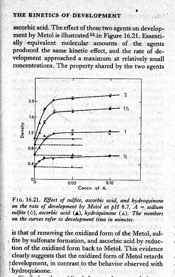

If I can figure out how to do it, I will attach the graph and some text from the The Theory of the Photographic Process.

Patrick;
Generally, any reaction product in chemistry will retard any further reaction to some extent. So, the graph is perfectly reasonable. That is what happens with oxidized HQ which turns into HQ-mono sulfonate. The quinone vanishes from the equation and therefore the reaction speeds up.
The conversion of oxidized ascorbic acid back to ascorbic acid is through an electron transfer that oxidizes the sulfite to sulfate. These two types of reaction are not identical and yet do involve oxidation and reduction reactions.

I think you misread the graph. Hydroquinone, sulfite and ascorbic acid are treated separately. There is no effect of hydroquinone on the development by metol at any concentration of hydroquinone that was tested, as you can see by the fact that the empty triangle symbols fall on a straight horizontal line originating at the 0 concentration point. The development by metol is accelerated by either ascorbate or sulfite.
The reaction products of hydroquinone accelerate development by hydroquinone, according to the same reference. Ascorbic acid "tames" hydroquinone.
I did what I promised. I mixed a solution of borax, metol and hydroquinone. A snip test of HP5+ with this solution yielded a density above base of 1.3 after 2 minutes at 70 F. I added 3.5 grams of sodium sulfite (anh) to this solution and got a snip test density of 3.04. I added the molar equivalent of the sulfite, 4.9 g, of ascorbic acid converted to sodium ascorbate by 2.45 g of NaHCO3 in a small amount of water. I let the effervescence subside before adding it to the other ingredients. The snip test from this solution measured 3.03 density. I then prepared a solution of metol, borax and sodium ascorbate in an amount equivalent to 6 g of the acid, with the same amounts of metol and borax as the original solution but no hydroquinone. The snip test measured 3.02 density.
I developed a strip of pictorial negatives, all taken from the same roll of the same scene, in each of the three solutions for 8 minutes at 70F. There were slight differences in contrast, about as one might expect from the differences in snip test density. The grain in 10X enlargement is quite good.
I will give a more complete report when I can get around to scanning the prints from each concoction.

Patrick;
It explicitly states that the oxidation products retard development, and their removal accelerates development rate. Therefore, they state that sulfite addition accelerates HQ and Metol development. That is what I was referring to as well as the reference to the superadditive effect between Metol and HQ. The utility of the Elon Ascorbic acid developer (Metol=Elon), known at Kodak as EAA is well know as well.

"Therefore, they state that sulfite addition accelerates HQ and Metol development."
I saw no such statement. I saw no place where they even implied such a statement. They did no tests that could be interpreted in that way. Those who produced the graph I sent did not present any evidence that HQ adds to the development by Metol, either synergistacally or simply. They did present evidence that sulfite accelerates development by Metol without HQ. I see no place where these researchers stated that sulfite accelerates HQ and Metol development.
The graph clearly shows that there is not even an additive let alone superadditive effect between Elon and hydroquinone without the presence of either a sulfite or ascorbic acid. The activity of Elon is approximately doubled by the addition of either sulfite or ascorbate.
My own experiments, which anyone can repeat, show that either sulfite or ascorbate at the same molar concentration stimulate the same degree of superadditivity between Metol and HQ, and at the same pH. The pH of a 10 g/l borax solution is bountifully sufficient for either an MQS or an MQC developer. The molar concentration of S need only be the same as that of the C. If you do not want stain, you can substitute as much sodium ascorbate as you want for the Q.
At any rate, I learned what I set out to learn. Ascorbic acid, which is soluble in glycol or TEA, can be substituted for sulfite in such developers as the Pyrocat series and also in PMK in quite small amounts. There is no loss of activity if, OTH, sodium ascorbate is substituted for hydroquinone in the usual MQ or PQ developers.
I doubt that Kodak had much interest in creating or promoting staining developers in glycol solution.

Patrick, the comment I reference is at the bottom of Page 366, right column which describes the experiment in figure 16.21 in detail. "oxidation products.... retard development" and then "activity returned by addition of sodium sulfte".
This is the problem with a non chemist reading an argument on chemical reactions. This is A + B = C where C buildup retards development.
If C has nowhere to go the reaction can virtually cease, but if C + D = something else, the reaction speeds up.
Now, lets write Silver halide + HQ = Quinone + Silver metal. Silver metal is a solid, but quinone is in solution and blocks up the furhther reaction of HQ, all by itself or by making Quinhydrone.
If you have Q + sulfite = HQ monosulfonate, then the reaction speeds back up again. QED.

The experiment on the precending page plus the other data show that the oxidation product of metol inhibits further development. Cross oxidation to remove the oxidation product of Metol speeds up the reaction. Either sulfite or ascorbate can act in this capacity.
This is stated clearly in that paragraph. (At least to a chemist). Sorry Patrick, but that is my professional read on it. You are misinterpreting the data.

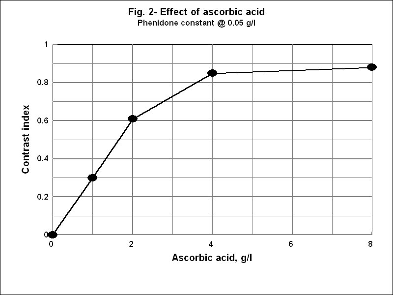

But Metol and hydroquinone are not superadditive without sulfite. That also is shown in the graph in Mees and James.
The ratio of ascorbic acid to Phenidone in PC-TEA is about 40 to 1 by weight. I don't know the molecular weight of Phenidone but that of ascorbic acid is 176. That was the ratio at which the increase in activity levelled off as ascorbic acid was added to 0.05 moles/liter of phenidone. I dont remember where I got the molecular weight of Phenidone for that experiment, nor what value I used. I am looking at the graph. I will look up the text. I'm sure you know the MW.

I didn't even read my own plot right. The weight ratio is about 80/1 ascorbic acid/Phenidone. I do not know the MW ratio.
