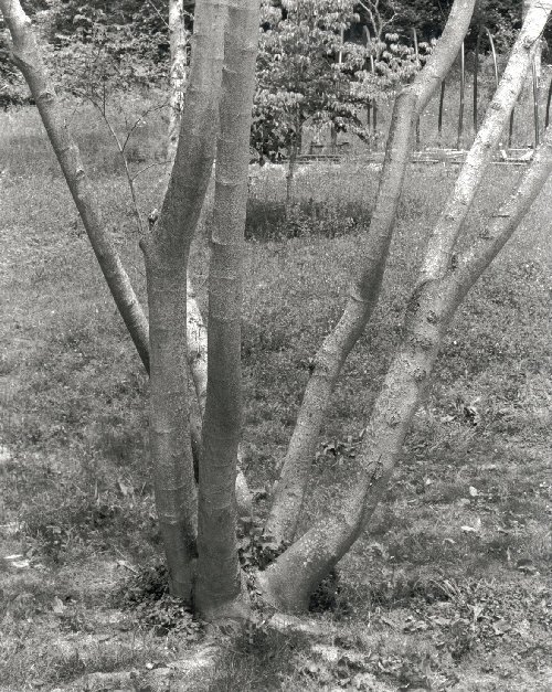

METOL-ASCORBATE
I should also have said that this solution is not awfully much different from D-23 in activity.
I DON'T KNOW WHAT I'M INTO HERE, BUT HERE GOES.
gainer
Sep 20, 2002
3,699

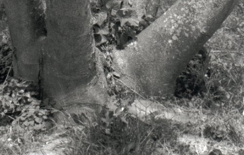

Metol-ascorbate
This is my third try to get the attachments attached.
gainer
Sep 20, 2002
3,699
These attachments really belong with the article and chem recipe about Metol and ascorbic acid.
