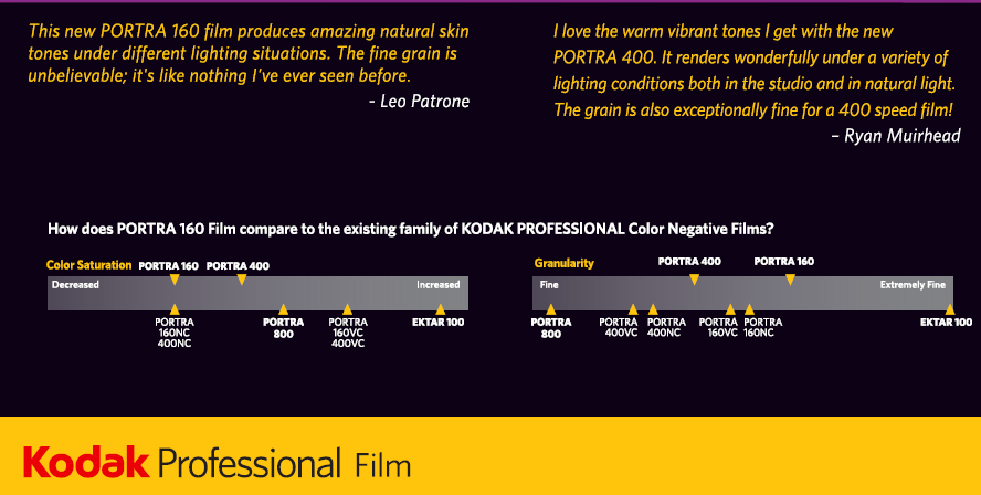

This is from the updated Portra 160 and shows the "inherent characteristics" of both the original; Portras and the updated/current Portras. One can easily use their judgement as to where Gold, ColorPlus or Ektar might fit in these continuii.
But the question in this thread is not about the characteristics of Portra; the question is what film is a step up from Gold/ColorPlus. I think the answer has been given much earlier in the discussion: Portra or Ektar. :smile:
The Kodak graphic confuses me. Portra 400 has less saturation than 160 in my experience.
P 400 has a little more saturation than 160. Kodak states it correctly. But the posted chart is out of date, and refers to NC and VC versions no longer made.
