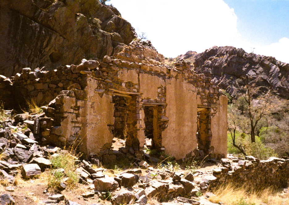

Alright. I dug around for an example, and I found evidence that I did something wrong in the digital processing step.
While my previous post referred to infrequent cases where I have both crushed shadows and blown highlights, I want to show you a different example with just blown highlights, which is a much more frequent problem for me. I often have trouble with the sky and clouds. The shot below is one I was particularly disappointed with. Complete loss of detail in the clouds, and weirdly grainy sky.
The film was sold as "Fuji 400" bought at a time when everyone already suspected that, at least in North America, Fuji 400 is just rebranded Ultramax.

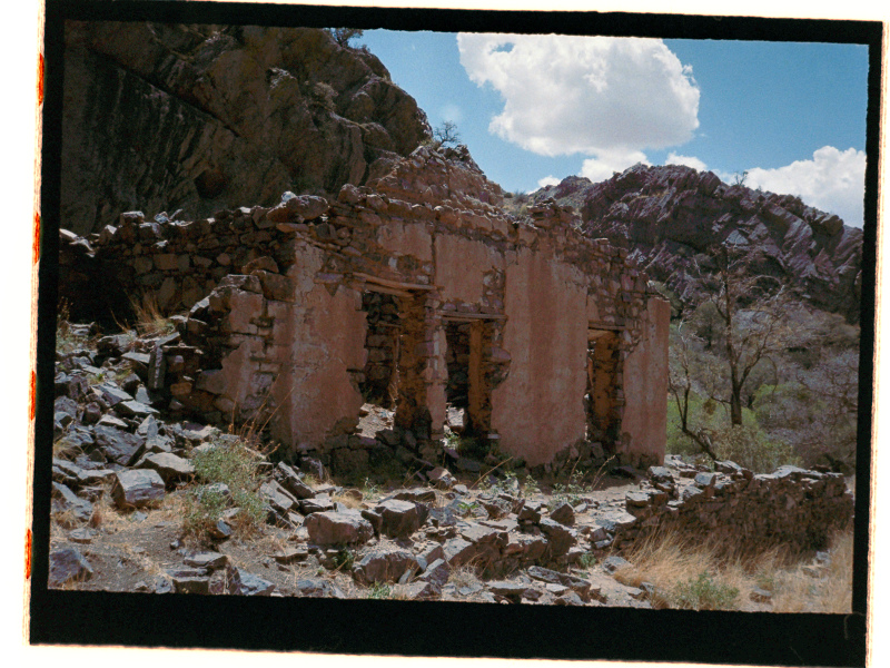

I digitized the negative with my DSLR. I dug for the negative (included below), and it clearly shows plenty of detail in the clouds. This was the first roll of film I ever scanned, so it probably has a maximum amount mistakes in it. I should go back to it and see what I can do now that (1) I have a bit more experience with the software and (2) I am aware of the issue.
I am still going to try other films --- I do very much want to try other films and see what they look like for me. But this bit about how blown highlights point to scanning + processing issues rather than film was a useful tangent.
Thanks for including the illustration; it does indeed demonstrate what I hoped you'd take from this - that there's plenty of room to play with the film(s) you've been using so far.
As you observed, the clouds are not the problem in that negative (or indeed its digitization). The lack of shadow detail is a more pressing issue, in my view.
Evidently, it's a tricky scene with a rock face that's hidden in deep shadows adjacent to sunlit clouds. The main issue here is metering.
Of course; I can only encourage this. I've had a lot of fun doing the same; I wouldn't want to discourage anyone from doing so. At the risk of waving the normative finger some more - as long as you keep a clear eye on what kind of characteristics you're really looking for, and what the effect of handling/processing the film is. The latter is such an overpoweringly strong set of factors that it's easy to draw a wrong conclusion about the former.
