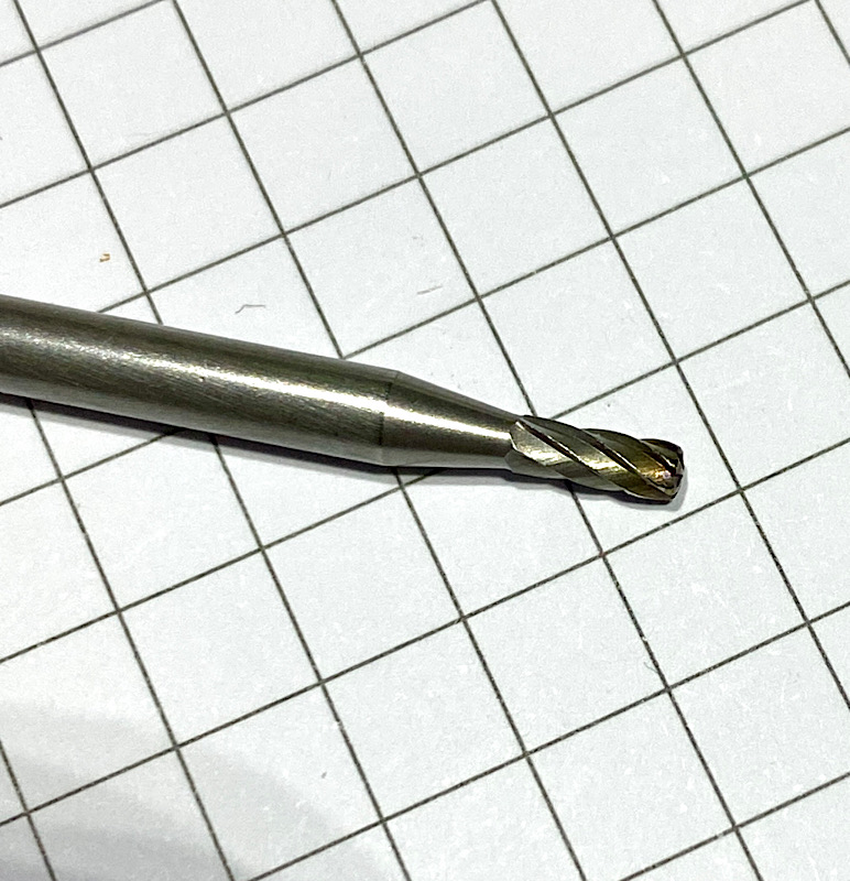

When it comes to removing steel screw heads - as a last resort when all else fails - I now rely on milling freehand with Dremel diamond milling bits.
This allows me to work in a controlled and precise manner with the Dremel without damaging the surrounding area too much.
Beforehand, part of the screw head can be drilled out, which is more precise and quicker.
The remaining screw thread can then be unscrewed using the Nejisaurus pliers. Or it can stay in the camera.
This approach is often the only way for me to be able to continue working on the device.
I recently did this again with a Canon T70 where a screw in the bottom of the camera refused to loosen.

It depends on which tool you attach to the Dremel and what skills you have to work with it.
The tungsten carbide cutters mill out the screw heads too quickly and are therefore difficult to control. That's why I switched to the diamond cutters, which are smaller and finer. This allows for much more control.
Like is said before, they are meant for work round the house and used free hand - also suggested more than once in this thread - it certainly gives a big risk of not providing a professional result......but that is - with all respect - perhaps not really what you are striving for?
What is wrong with the result, see last picture? The screw head is cleanly severed with minimal collateral damage all around.
