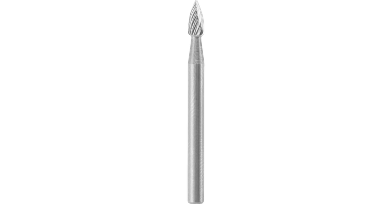

Stuck screws, secured with adhesive, that I can't loosen with solvent or heat have put one or two of my projects at risk.
Because if a screw doesn't come loose, you can't go any further, e.g. dismantling a lens bayonet.
To make progress, I tried using a screw extractor and a drill, but that was almost unsuccessful.
But I can continue with a tungsten carbide milling cutter on the Dremel.
I mill off the screw head that holds two parts together. The rest of the screw can be unscrewed comfortably with the Nejisaurus pliers (see below). This way, the thread is retained.
I work with the egg-shaped tungsten carbide milling cutter from Dremel:
I'm very happy with it, it works through metal like it's butter, and the shape is also suitable for my purpose.
It is just a bit too big for my application and this usually causes damage around the spot I am working.
The two adjacent screws were milled out with the tungsten carbide cutter on the Dremel causing some damage to the tripod plate.
With the PZ-57 (Nejisaurus) pliers I removed the stuck remainders of both screws.

Do you have any recommendations for smaller tungsten carbide milling cutters?
If you use a HANDHELD high-RPM grinder, it won’t be possible to precisely control the tool path. Some damage to the surrounding area is almost inevitable. Used in a handheld grinder, brittle carbide tools are especially likely to shatter due to vibration or if the cutter digs in to one side of the work.
If you can obtain the use of a small milling machine and have a way to hold the workpiece safely and securely, the screw head can be milled away precisely without damaging the part. This allows feeding the spinning tool into the stuck screw head in tiny increments that makes the process controllable and prevents damage to the workpiece and cutter.
For such occasional work, it isn’t practical to buy a milling machine. But you might be able to get the services of a small machine shop for such tasks. The amount of setup and machining time for such tasks is quite small and should be relatively cheap. You might get this done for free if you could submit it to a vocational school that trains student machinists. Many high schools and junior colleges have such programs.
For the task of milling off a screw head, you might need to drill a small center hole to clear away the central material slightly deeper than the depth of the screw head. Then mill away the head with an end-cutting milling cutter (plunge cutter). There are many sizes of small diameter carbide milling cutters available in catalogs of milling machine cutters. These are available via Internet from industrial suppliers. [This won't work properly in a handheld grinder.]

An approach I have used on small brass screws that are not under 'high' load is to drill out the screw with a drill smaller than the body of the screw. Then dig out the wall of brass against the threads of the main body. Chase the threads with a tap. A cutter like in your dremel is a good way to make a starting hole. Hand-held center bit, really. If you do set up in a mill or drill press and can get good clamping, a center drill bit could be useful to create the start hole for drilling out.
Now this kind of stuff is fine for side panels and holding parts that aren't much force. If the threads end up a little deformed or trimmed back a touch, everything will be fine. And the screw being brass means that the metal left in the threads will deform and be removable with a pick and such. I've seen people drill out a 10mm bolt on an engine block and chisel the remaining tube out by collapsing to the center. They plan on chasing the threads to clean out the metal and reshape the threads. A lens mounting flange is subject to gravity and jolts from walking/motion, and hand pressure, so you want to keep thread reduction or damage to a minimum, of course. But still, this isn't a rocket or car suspension- the forces are pretty small.
By the way, if you get a similar cutter but with a 3mm head, not 6mm, it's easier to do tight-in work. Like bit #SG-41 in the top group (expand picture, upper right column)
https://www.victornet.com/alphabetic/Carbide-Burrs-1-8-quot-Shank/37.html
Or here, pointed tree SG-44 is my choice because the head is 1/8" (3mm) like the shaft-

The egg-shaped Dremel cutter cannot be placed vertically on all screw heads, as this causes bouncing. I imagine that if it is placed vertically at an angle it would be too inflexible on the stand.
But I will clamp the camera to be worked on in the Dremel vice. It has gentle plastic jaws and is very stable.
Guide the cutter with a well-supported hand and magnifying glasses over safety glasses.

I have probably collected all the miniature cutters from Dremel, but I can only make progress on all the screws with the ones made of tungsten carbide.
The egg-shaped one is the only one that suits me in terms of its shape.
I am really looking forward to the 0.5 mm tungsten carbide cutters from China.
My experiments with various tungsten carbide cutters (Dremel) on the Dremel 4250 on the drill stand of the manufacturer:
The steel of the screw heads on the bayonet of my training Nikon F4 is removed well, but none of the cutter shapes cuts the screw head completely off.
Perhaps the 0.5 mm tungsten carbide cutters will help to rework this.

So far, I've had the best results with the egg-shaped tungsten carbide cutter on the Dremel, which I use freehand.
But from what I've read here, there are much better solutions.
My limit is that I don't want to buy any equipment other than the Dremel because I work on the move. If I had a workshop, it would be easier, but I work in our kitchen.
With the Dremel cutter, the screw head can be milled out in a cone shape down to the screw shaft. If I sacrifice some of the material around it, see photo, I can remove the screw head.
I want to try this second step with the 0.5 mm tungsten carbide cutters from China. If I can work more finely here than with the Dremel cutter, it should work.
