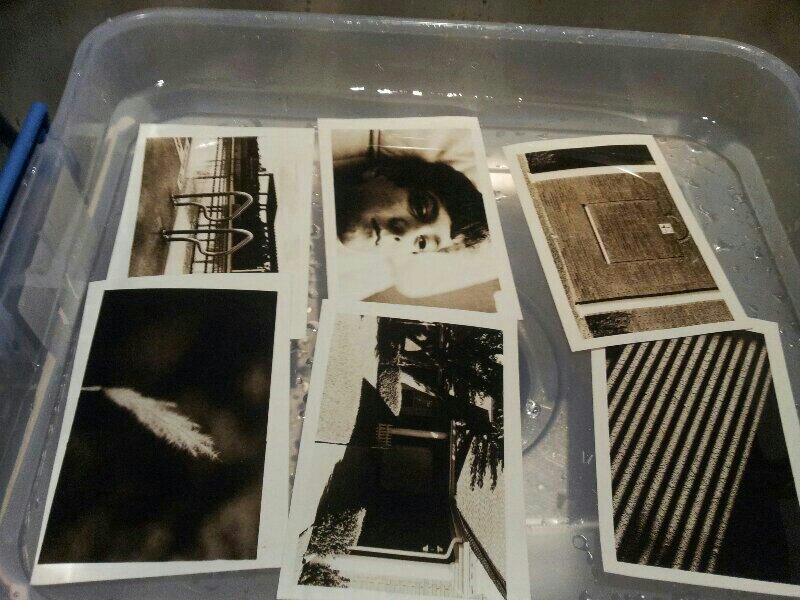

However, it's difficult to scan because of the velvety sheen. Here are two from last night with parameters above, ~20s in selenium (thinking of diluting for more control, it's 1:10). It's also hard to get the right tone on the scanner.....These are straight with no dodging or burning. It may be hard to see but the second one held the shadows well and it was a low light exposure.

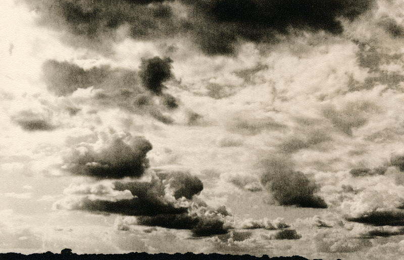

When I tried 1.5 minutes to get the clouds in that first print, the highlights started breaking up.
Not really splotchy like I saw with the MGWT contact printing but I can see they are relatives.

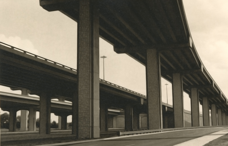

I love the overpasses... It's a beautiful print with a wonderful color... (i'd love to see that in person)

Sure can get a variety of colors. Thus may be only effective with fomatone for whatever reason. The real grey print is adox vario classic.

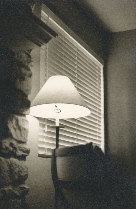

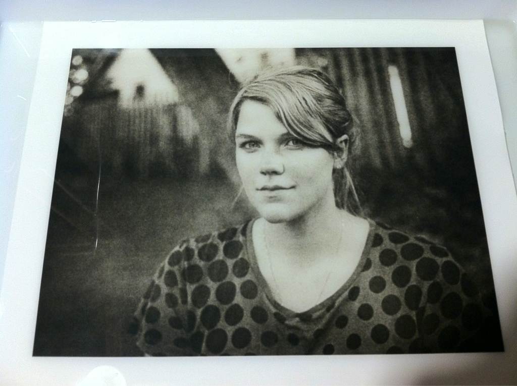

Hey y'all. Really having fun with this strength and this paper. I was/am having fun just cranking out 'contact sheets'. Just chose the ones I sorta liked and hit em. Dev times were close 2:30 to 3:00.
I do want to pop up my high end. So I'm going up 30s on the next film development.

this is the key to good lith printing, pump up the contrast or lighting ratio of the negative my friends, normal negs are ok but boost the contrast and your world of lith will be complete, screw 20 minute development I yawn just thinking of that method.
The second source flash is what tames the contrast so go for it, I use HC110 with a long dev.... ie I recommend underexpose or normal expose then over develop by one three more stops to build up a very strong neg.
Your flash will become necessary but watch for the creamy beautiful highlight detail to come into your prints at the snatch point..... Ilford Warmtone pre snatch.

Thanks for the tips Bob. What do you mean by second source flash? Pre flash? If so, with an exposure of 1min what kind of pre flash is a good start?
I've been shooting Delta 100 at 50 and developing in rollo pyro. At 8min it was just a bit too much and I was losing the highest highlights. These were at 7min so I think I'll bump it to 7:30 and see what I get...
I'm really liking this combo because 1min exposure with these negs is giving me a nice print without dodging and burning. Last night I just had to snatch somewhere between 2.5 and 3min depending on the negative. With the volume and size I'm printing I get three 'normalish' prints and then they get lithy. I think this was the fourth on a run last night:

I'm not Bob, obviously, but flashing the paper controls your contrast and gives those highlights an opportunity to get proper tone. With this technique, the 8 minute negs would still be ok, and after experimenting, you might prefer even more!

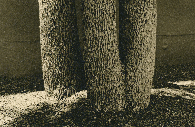

Here's the arista with a preflash. I was able to get highlight detail in the bark and some in the ground to the left.

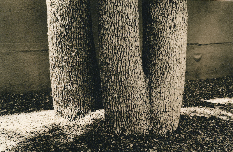

Here is the LD20 with a preflash. Like I said the highlights are too much of a shift in tone for my taste.
Scott,
The intensity and duration of preflash determines whether you get highlight detail or not. It isn't necessarily the developer's characteristics alone; you have to think about it as a system.
With more practice using LD20 I bet you could get highlight detail with it too.

Here's one of the prints I made today. It's a crappy iPhone snap of the print in the second fixer, so quality sucks, but this is Ilford Warmtone glossy, 9x12 print on 11x14 paper.
Arista Lith at 250ml A + 250ml B +2,700 ml water + 1,000ml old brown.
Seasoned with three sheets of useless 8x10 until completely black.
Nice grain, and color is untoned as of yet. Got a few test prints that I want to try Moersch MT3 and then selenium, and a couple in just selenium. I'm also curious to see how the paper works in Moersch Carbon. ImageUploadedByTapatalk1378174751.587755.jpg

Here's one from yesterday. I've been skipping the selenium to see what kind of blacks I can get with a better snatch and dry down.

Scott,
I have traditionally mixed 100ml A + 100ml B + 2,800ml h2o + 1,000ml old brown, so about 1+19 or so. The mix of 250ml A + 250ml B + 2,700ml h2o + 1,000ml old brown is more like 1+8.4. So more than double the strength.
While printing, I also tried some really old Kodak paper, and I was surprised to see that it was OK in the stronger mix also. Happy too, because at the weaker dilutions I've had some pretty nasty anomalies in the paper that has looked very poor with respect to grain, etc.
Bold negatives, like Bob says though, is definitely the way to go. Makes a ton of difference. I tried printing a flatter negative, and it just wasn't the same at all.

I should also add that I got slightly less color in the paper this way (which I am very happy about). The Ilford Warmtone looks better than I can ever remember.
I actually started out the printing session with 150ml A + 150ml B + 2,700ml h2o + 1,000ml old brown, which is a little stronger than normal. But I figured 'what the hell', and poured in another 100ml of each solution. It was a fairly long printing session, about 5 hours, and the developer was still going strong after six 8x10 sheets and eight 11x14. I have a feeling I could have kept going for a while yet, and the colors were getting so warm and cozy for portraiture.
