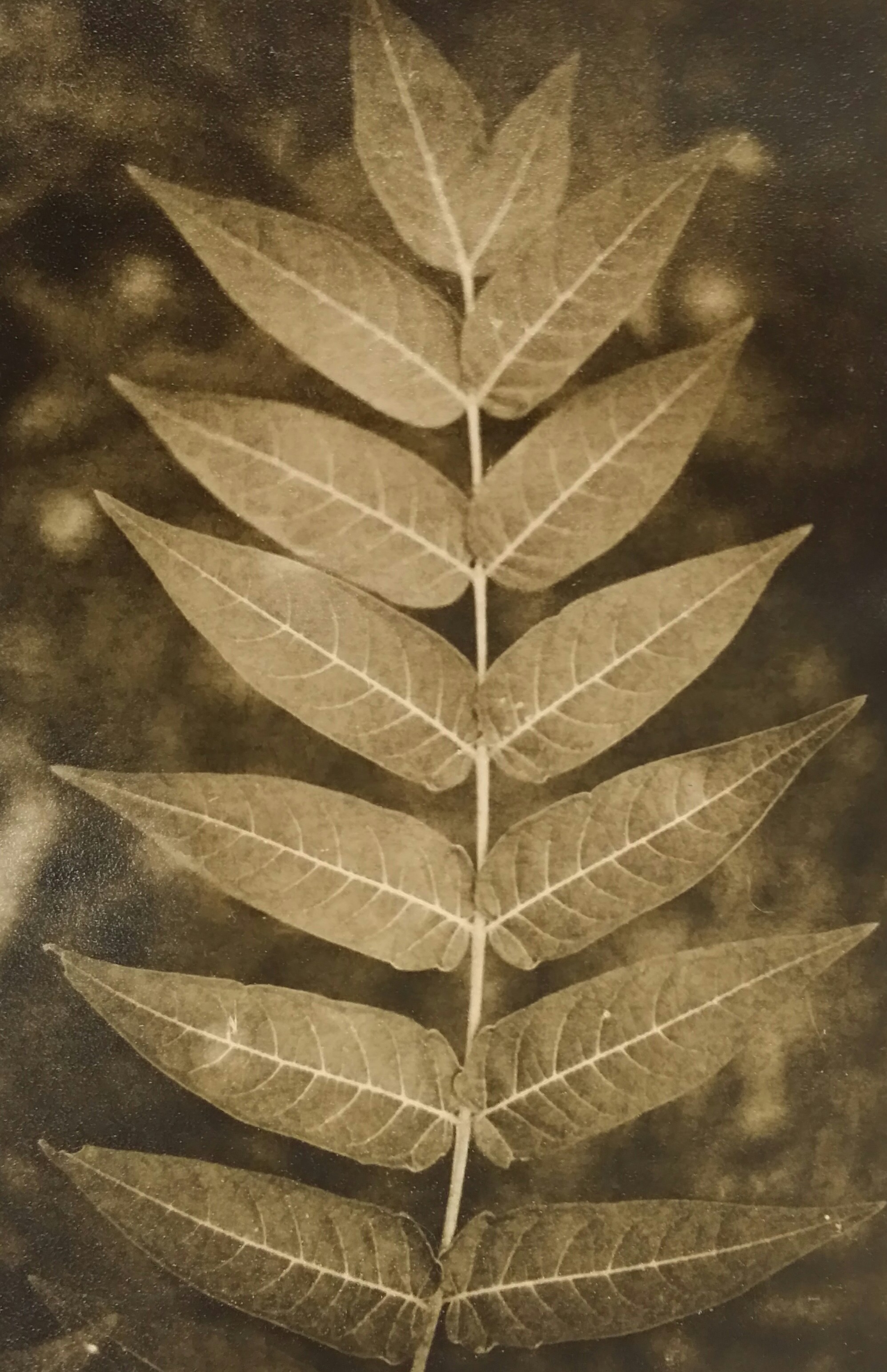

More playing around tonight.
Crazy variety.

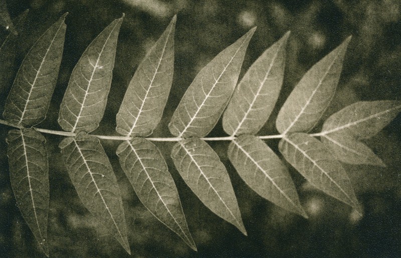

How time flies...
I didn't have a darkroom set up for a year...wow.
Anyway, thanks to this thread I knew what I did last ;-)
I have modified it just a little.
The strong lith chems do a good job of taming fomatone pretty well but you can still get into the pinks.
So what I did was add a little concentrated LPD.
This is the formula I'm currently playing with 30ml Arista A, 25ml Arista B, 120ml water, 2ml [LPD]
Here's an example of 3X4ish print f5.6 for 10s. Film was Delta 100 at 50, developed in rollo pyro for 7.5mins

I haven't played too much with it but it definitely starts to shift toward olive-ish the more lpd I added. I did 5ml. The lpd was made over a year ago.... I think development was maybe 1.5minutes. Still have a snatch point. I also can't say what the water temp was. It was on the warm side ;-) more playing to do. I wish I had a better Enlarger... The cadet II does the job but it's a rickety thing.

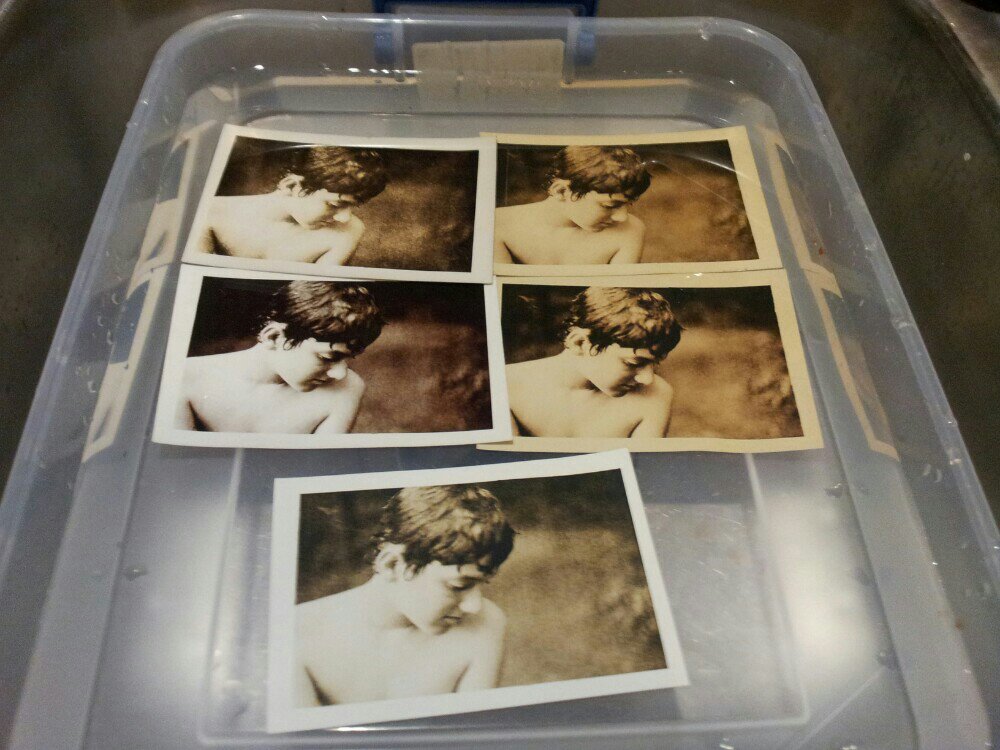

Couple more. It's really hard to get the scan and color correct....

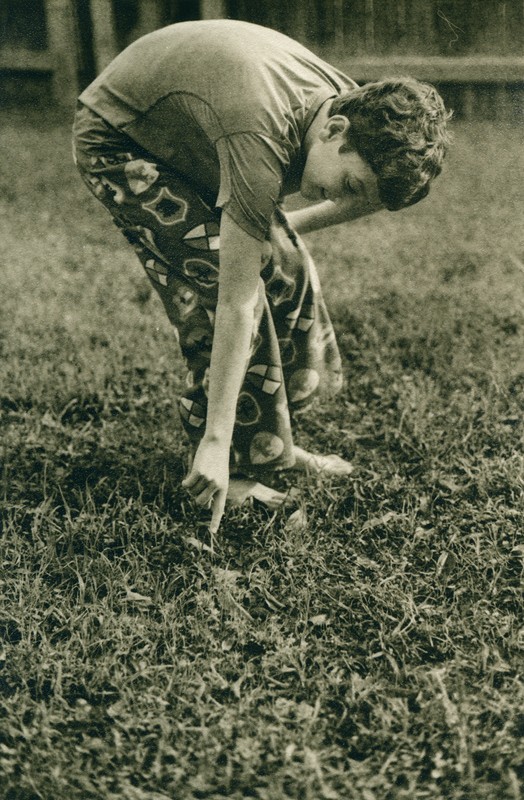

Real hard time dealing with the satin surface and the color. Here's a phone pic of the print.
Sent from my SM-N900V using Tapatalk
