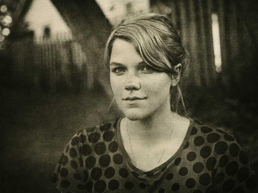

Here's a scan of the print that I took an iPhone snap of last night.
Ilford MGWT, 9x12" size (so it's scanned in two pieces and stitched together), Arista Lith 250ml A / 250ml B / 2700ml aqua / 1000ml old brown. Negative with strong contrast. Dev time about 4 minutes.

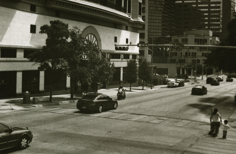

Lots of fun last night.
It's just cool to get a wide variety of prints. I was working with the same negative and my small batch of developer. It will shift it's properties within 3-4 prints.
I did some fomatone and got similar results to those posted above.
I switched to fomalux and several more stops of light....development for it was more in the 5min range.
However, it has some great color. Selenium kills that color fast.
Before starting over with fresh strong developer I made this one.
It's definitely lithy but I LOVE what it's doing with the light. i'm just mesmerized by how subtle some of the light play is. Check out the to strong rays to the left on the side of the building. Those were downright cool in some of the more contrasty prints.

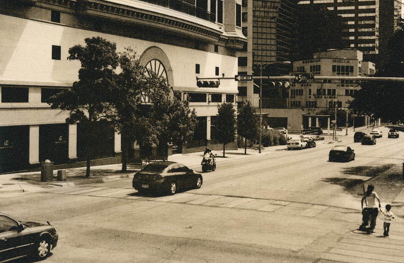

Here's fomalux in 'fresher' dev
Here's the fomatone variant

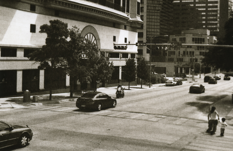

Another variant. Fomalux, fresher dev, probably a very quick dip in selenium, then bleached and toned in IT8
