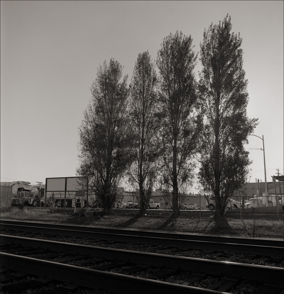

Nothing special here but notice my streak-free sky! (Rolleiwide, FP4+, D-76 1-1):
attachment.php
  • West Berkeley near RR tracks Rolleiwide 55f4Distagon IlfordFP4plus D-76 1-1 10min 20C 1minAg2x 2.jpg

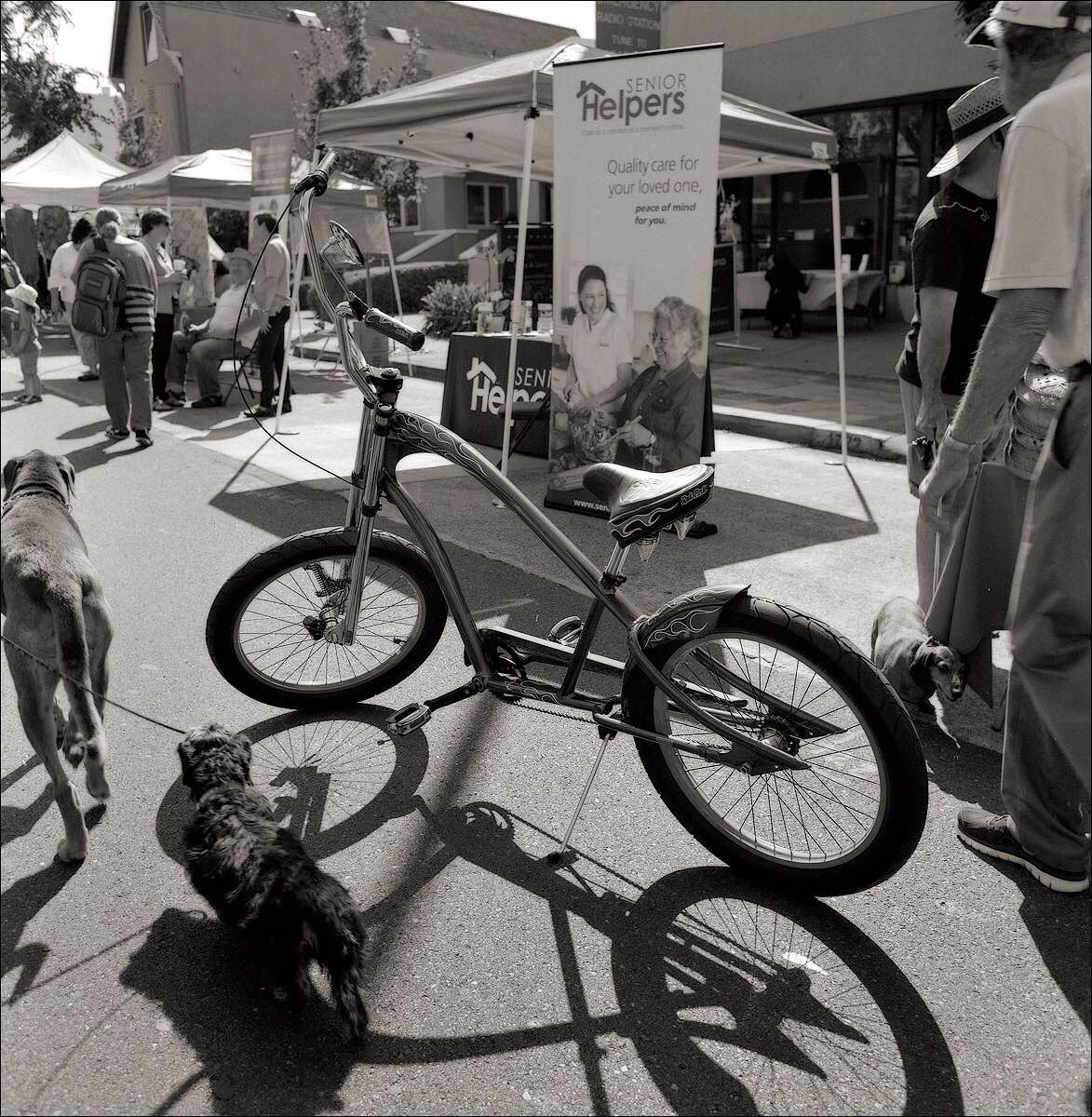

Alrighty. Got a hold of a JOBO 2502 reel so as to load and develop two rolls of 120 at a time in my JOBO 2521 tank (which until now I used exclusively with a 2509n reel for 4x5). After practicing every night for a week with the lights on using two old expired rolls of Shanghai GP3 and then with the same rolls as "dry runs" in the changing bag I finally braved it with a couple non-practice rolls of FP4+. Other than taking a little more time than I'd usually take to load on SS reels (which should get better with more experience) I developed them in D-76 1-1. Problem SOLVED. My skies are as even-toned and smooth as a baby's tush. Looks like I'll be doing my 120 film development this way from now on. Just loaded two more rolls of film for development (Delta 400) and the loading went much faster this time.
attachment.php
  • Solano Stroll Rolleiwide Distagon IlfordFP4plus D-76 1-1 10min 20C JOBO 1minAg3x 2014-09 VSmac 9.jpg
Alrighty. Got a hold of a JOBO 2502 reel so as to load and develop two rolls of 120 at a time in my JOBO 2521 tank (which until now I used exclusively with a 2509n reel for 4x5). After practicing every night for a week in daylight with two old expired rolls of Shanghai GP3 and then with the same rolls as "dry runs" in the changing bag I finally braved it with a couple non-practice rolls of FP4+. Other than taking a little more time than I'd usually take to load on SS reels (which should get better with more experience) I developed them in D-76 1-1. Problem SOLVED. My skies are as even-toned and smooth as a baby's tush. Looks like I'll be doing my 120 film development this way from now on. Just loaded two more rolls of film for development (Delta 400) and the loading went much faster this time.
