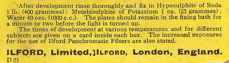

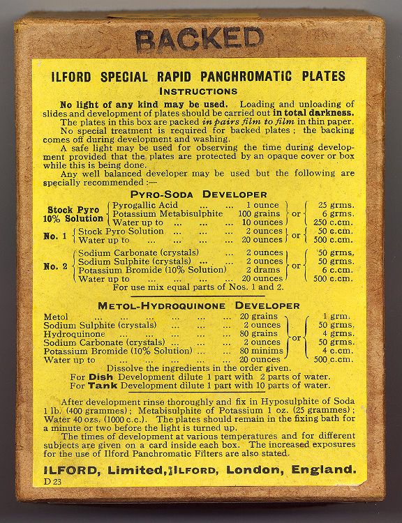

No access to my 1890's Maunal of Photography (Ilford) or WWI copy but my 1910 Agfa data and this Ilord box from 1923 suggest a water rinse :D
I can't believe all this anti-stop bath nonsense lately
So are we anti something that was once not recommended for films ? Ron Mowrey (PE) summed it up well. But modern films are much thinner so what worked in the 20's with far thicker emulsions must be OK now. We are talking fresh water. with prints that's too wasteful so stop-bath has long been recommended.
I've boxes with similar instructions from other manufacturers as well :D
Backs up what you're saying nicely John. Note the D23 - Ilford code indicating 1923 which was only dropped in the 90's - the box was marked 1923 & Rouen, France where the plates taken.
Ian
A cynical person might suggest that it was in Iford's interest to sell Ilford stop bath!
