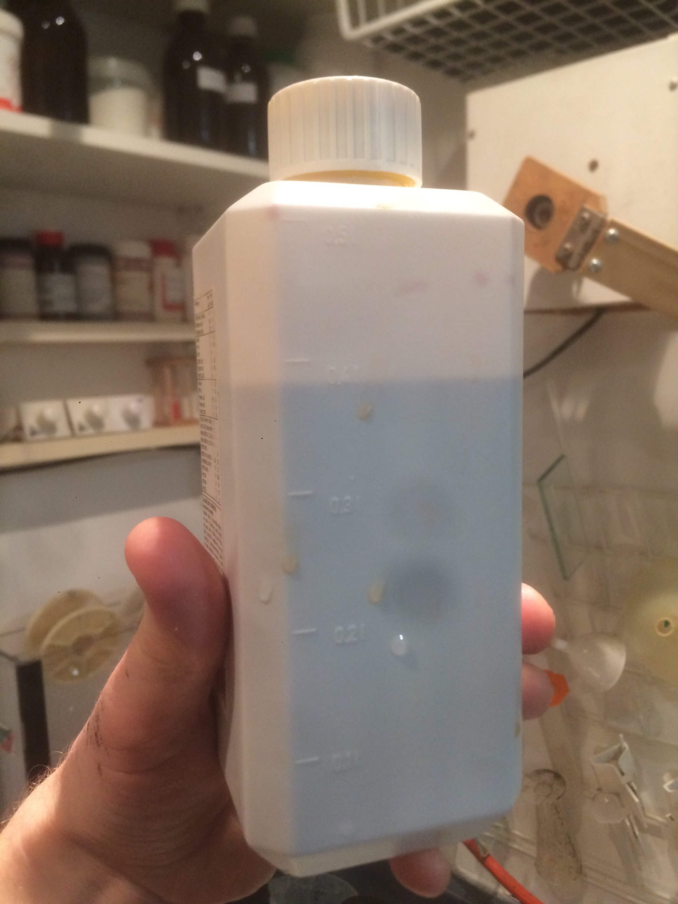

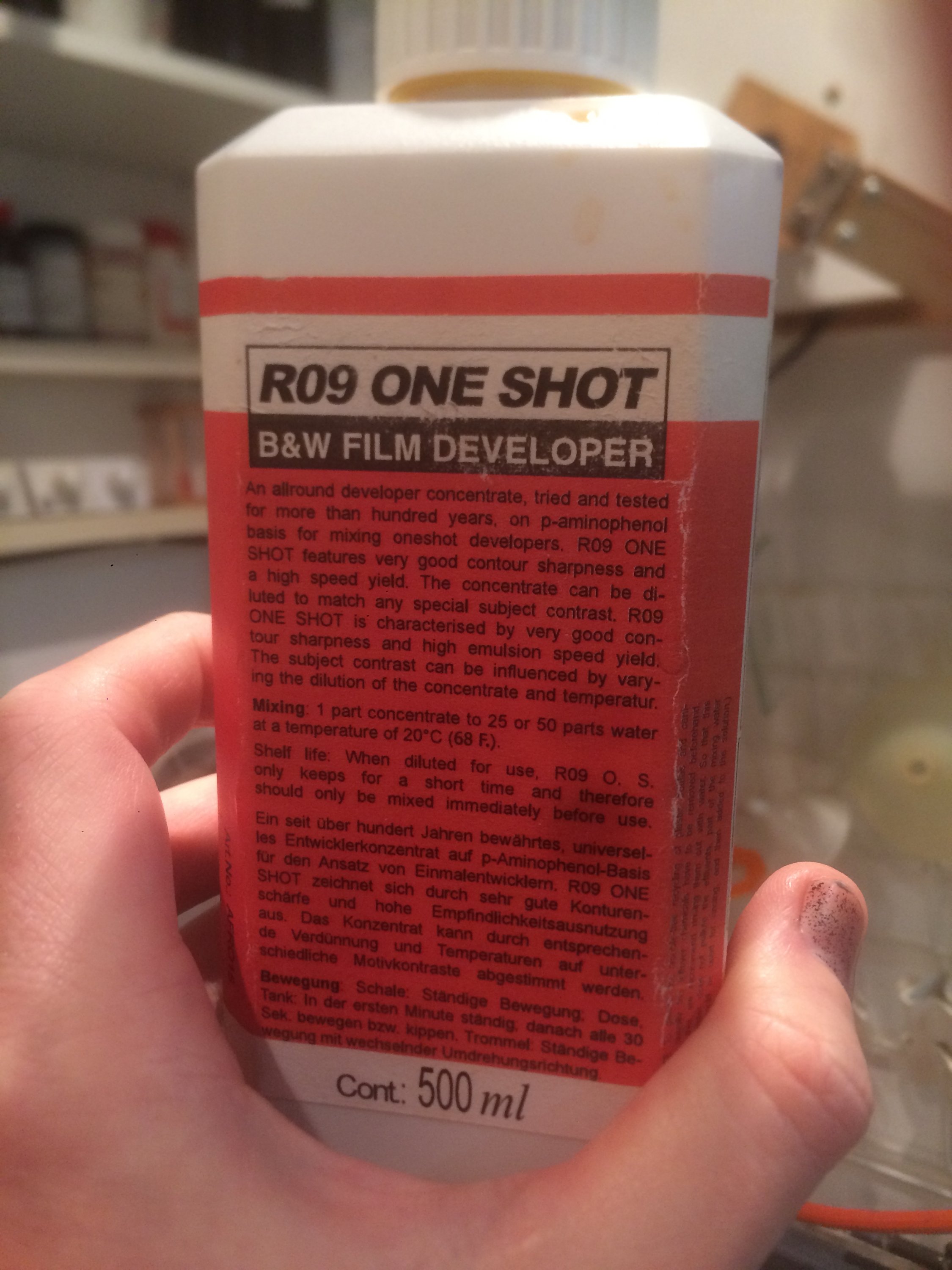

So weird. The directions on the bottle suggest 1+50 so this is only twice as diluted. Should be doing something no? What’s the keeping properties on a 3/4 full bottle? It’s not ancient. Will try and find out when I bought it.

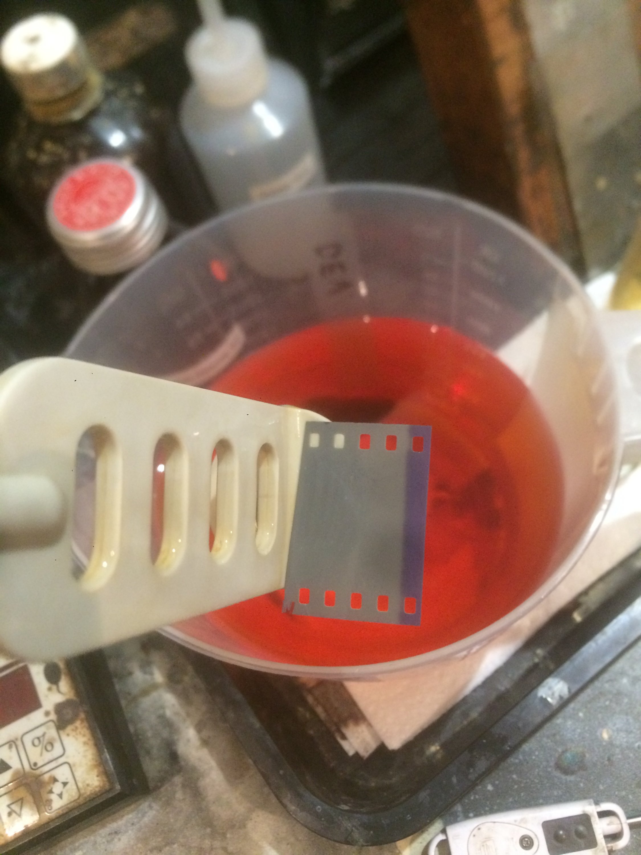

Here is how the dev looks. Burgundy in concentrate but irn bru orange when diluted 1+100. I left a piece of exposed leader in a litre jug of developer and after an hour nothing has happened. No darkening at all.
That's a very strong colour! How old is that developer? Mine is about 15yrs old, dark brown, crystals rolling around in the bottom and I don't get anything like what you have in terms of solution colour.
Is it possible the film was unexposed? There was a period when bulk loaded Tri-X had no edge markings, and you mention this was old film that had been standing around waiting for processing. Exposed leader portion would be the final determinant here -- if that didn't show some density, then there was no development at all. Even bad developer generally won't leave the exposed leader blank...
EDIT: Okay, I'd missed the leader piece standing in the jug. Yep, I agree, that developer is all done. Even at 1:100, you should see some darkening when developing leader in the light in no more than ten minutes, and full black in under twenty.

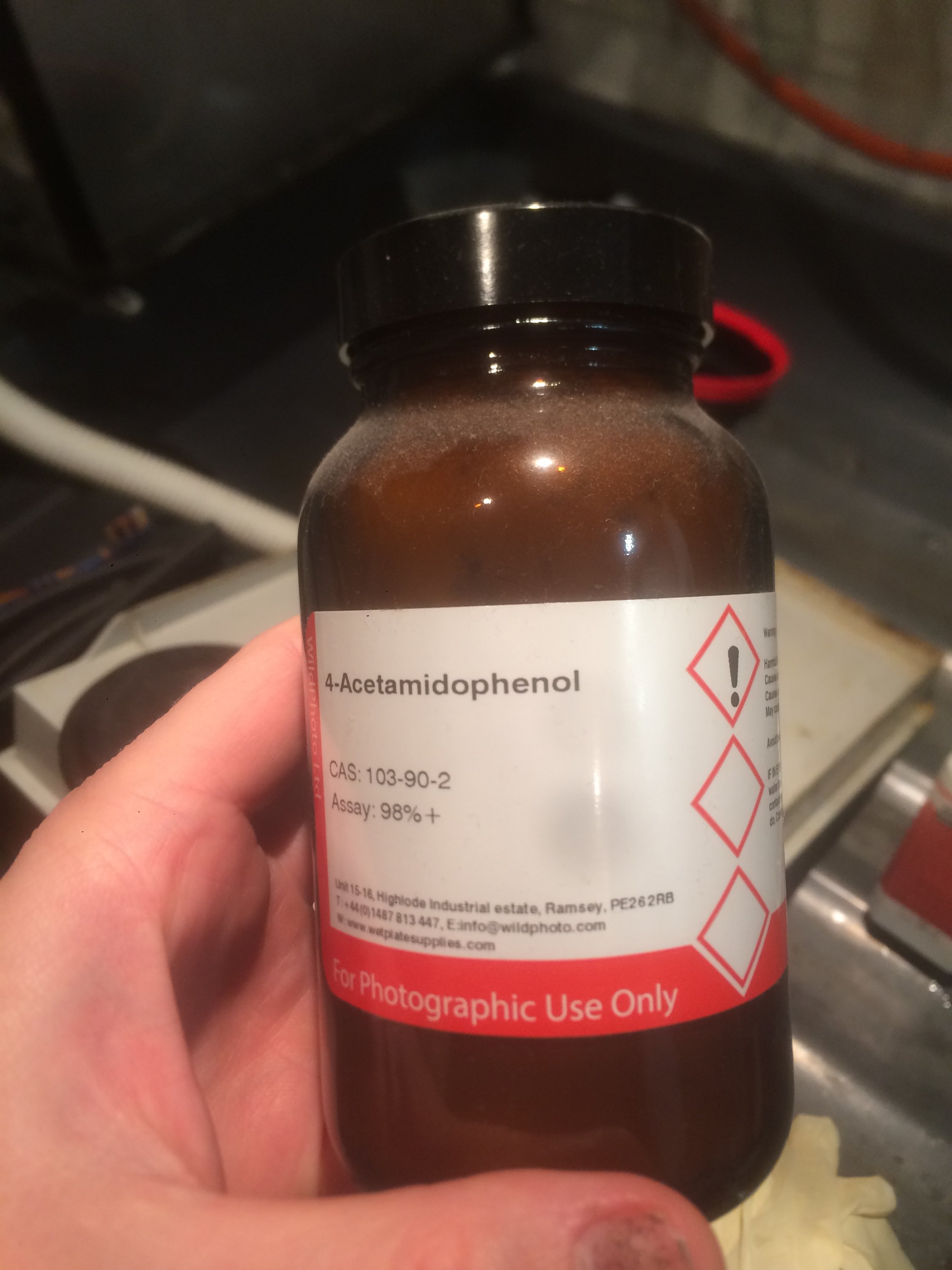

Seems like R09 doesn't do as well as the last version of Agfa Rodinal that was actually made by Agfa. Honestly, you'd be better off with Parodinal -- acetaminophen headache tablets (or powder, if you can get it at a good price), lye drain cleaner, and sodium sulfite. I used this for years, same times and dilutions as commercial Rodinal, went as high as 1:200 for microfilms, and the concentrate would work correctly when it was the color of Coca-Cola, six months or more after mixing with 200 ml in the bottom of a 600 ml glass jar. Had to be at least pink to work at all.

I can’t actually find out how old it is. 4 years at least. Certainly not 15. No crystals in it. Thought it would keep better being 3/4 full. Does yours still work?

when my bottle of Rodinal expired it produced solution that bright orange color when mixed 1+100. The new bottle produces a very, very light lavender solution at 1+100. Your developer is dead.

Yeah. Used it a fortnight ago. There's about 1/3 left and because the bottle is so stiff the air hasn't been squeezed out. It was made by compard and didn't come with crystals.

Thanks. Well that was a waste of a bottle. Maybe I should decant the next one into smaller bottles.

This ^^. Get the Adox version if you can' t mix your own Parodinal. If you can get lye and sodium sulfite, I'd suggest mixing your own. I used to get my acetaminophen (might be labeled as paracetamol where you are) quite cheaply at a membership store, but even getting the generic at the local supermarket, and ordering the lye and sulfite from Amazon, I can process with Parodinal for six or seven cents a roll -- and if you mix at most half liter at a time, you'll use it up before it goes bad, even if you don't process much (it'll last at least six months, and I've had reports of more than a year).

I have this. So I can effectively make Rodinal? How close does it come to the original?

An open bottle of R09 does not last 4 years. The original Agfa Rodinal can last decades and still work well. The Rollei-Compard R09 version (modern, which is what you have) does not last long once the bottle has some air space in it. Don't expect a 3/4 full bottle to last more than 2 years and remain reliable. Depending on storage conditions (exposure to light and/or high temperatures) that time may be reduced to as little as 12 months from the time you opened the bottle.
This modern replica of Rodinal does not have the same shelf life as the original formula. (I have a 1/3 full bottle of original Agfa Rodinal from 1984 and it still works, believe it or not) I strongly recommend that once the bottle has been open one year, you do an activity test on the prepared solution before actually using it on a roll of film. IE: clip a piece of leader and sit it in the diluted developer for at least 10 minutes to check for development. Only then should you use it on exposed film. With R09 I suggest you not dilute it more than 1:50 for reliable results.

As others said, R09 does not have the life of the traditional Rodinal. Sorry for your loss, hopefully it was of nothing important.
That's pretty much the colour that a number of expired developers go - it's quite distinctive. Not going to suggest a comparative taste test however.
