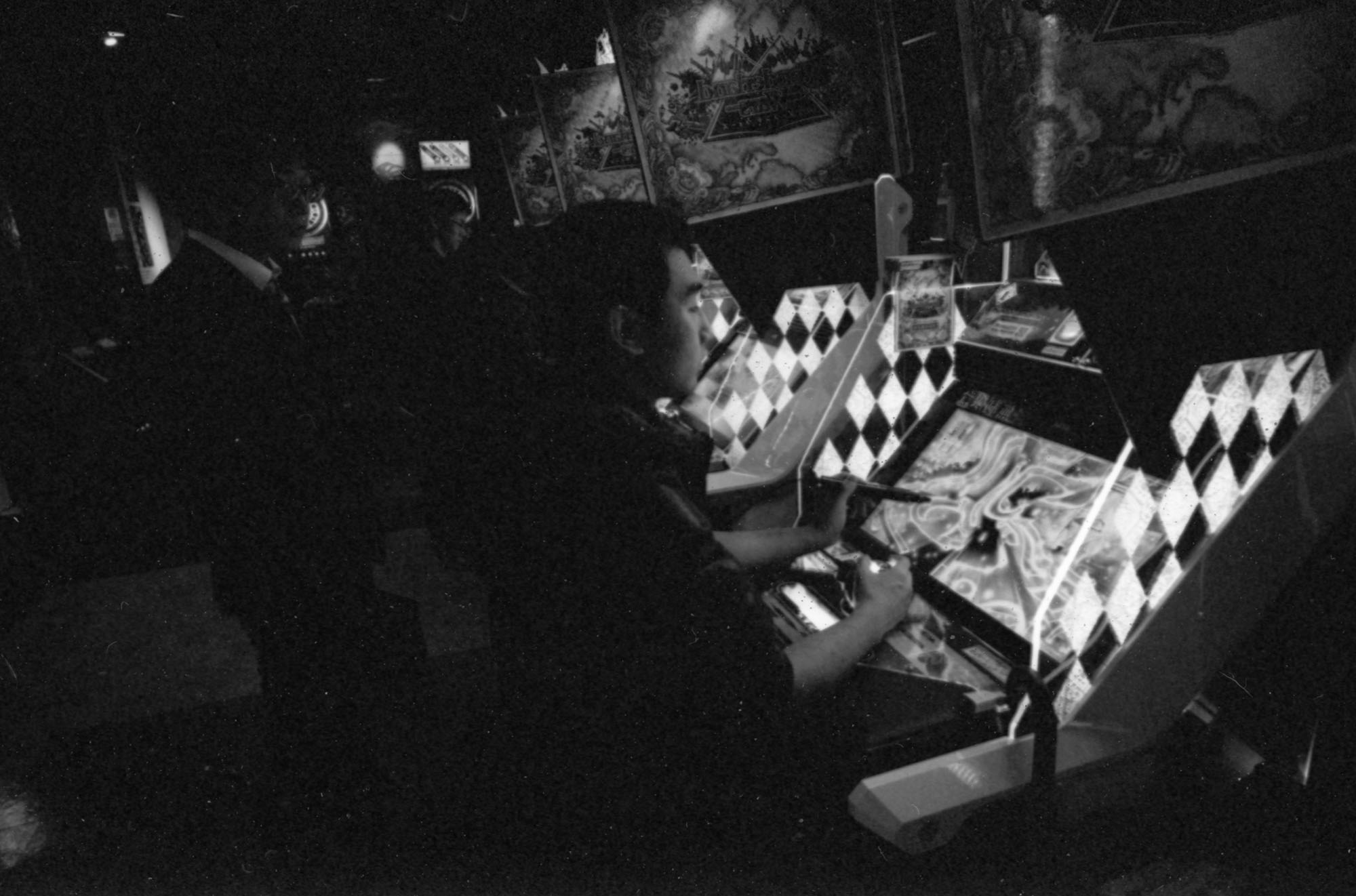

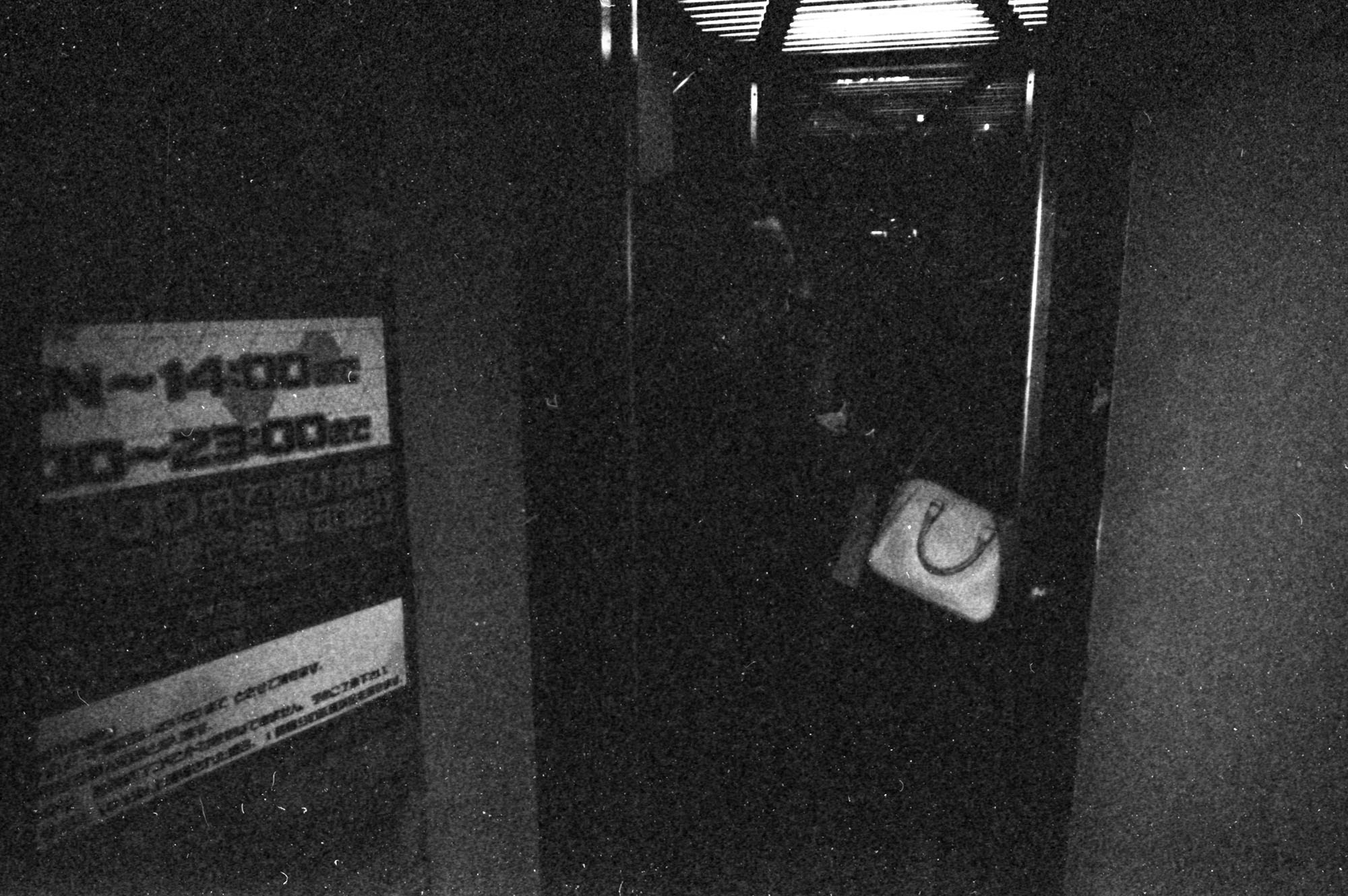

These are the scans from the film i developed in HC110 pushed to 1600
Some detail can be seen in one of the shots but I can't make out very much in the other
I think it was too much to expect from the film in such a dark environment, even with push processing.
