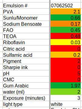

Last night and this morning I tried making test emulsions and I kept having them turn into polymerized blobs in the beaker. You have to keep the pH controlled at all times with this. Looking for a solution (pun intended) I decided to again separate the emulsion into two parts.
Emulsion: PVA+Monomer+Pigment, pH5
Activator: 2ml H20+SB+FAO has a pH of 5. light green. TEOA turns it almost red with pH 10. Adding sulfamic to drop pH to 7. Riboflavin doesn’t change pH. Add GA. Final pH5.
The emulsion having PVA, monomer and pigment haven't given me any issues and they mix really well. I actually checked this morning and starting with PVA, as soon as you add the monomer you do get a white colored cloudy mix. I assume that's billions of tiny non soluble monomer bubbles mixed with the rest of the stuff.
Then I mixed my activator. My tap water has a pH of like 8 to 9, its bad. then I add the Sodium Benzoate and FAO to a pH of 5 and that turns the milky white to milky green. TEOA boosts the pH to 10. Adding sulfamic drops it to 7. Next I add Riboflavin which doesn't change the pH and finally the GA which may or may not bring the pH back down to around 5, It was hard to read the pH strips. I'm pretty sure that it did change the pH. If you don't do it this way you're pretty much guaranteed that you'll get a blob.
Anyway, this is the best combination so far which results in a good image via visible light (strong LED flashlight). The Gum Arabic makes the development really easy. I spray with 0.3% peroxide, then immediately (this is important) dunk into dilute acid and then finally wash the ink away in water. You can keep the acid relatively clean for a while if you just dunk quickly, might as well spray it on probably. I think CMC also works but I haven't found a good mix yet with it for visible light. the role of the gum is to prevent the pigment from going into the paper fibers to stain them permanently. As I explained before, very fine carbon/pigment and or inks just go right into the fibers. In fact, looking at a NewCyanotype under 1000X magnification you can see that its practically an ink that penetrates into the fibers there it changes color... that is why its so good. PS if you write : PVA, it works but :tongue:VA give you a smiley face LOL.

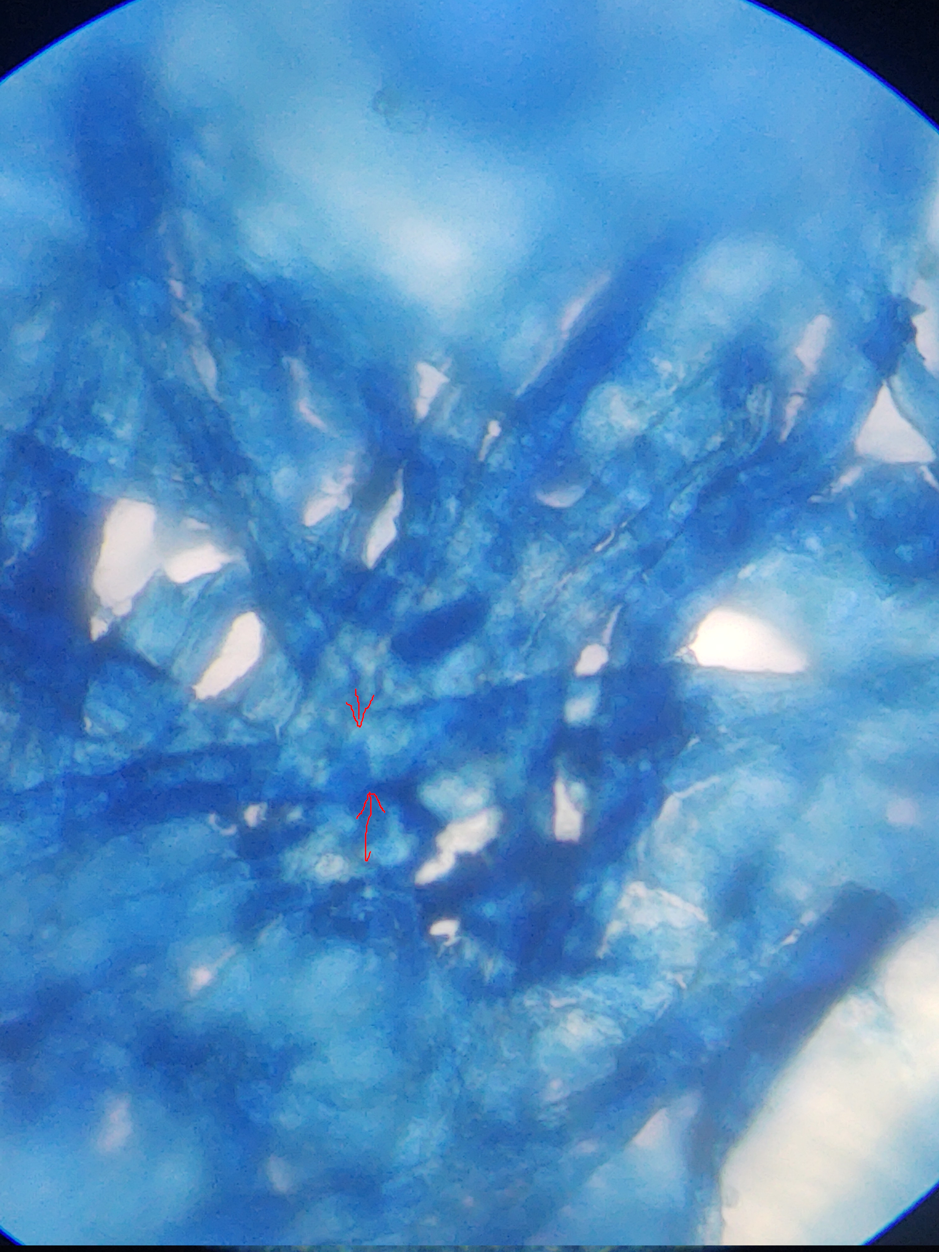

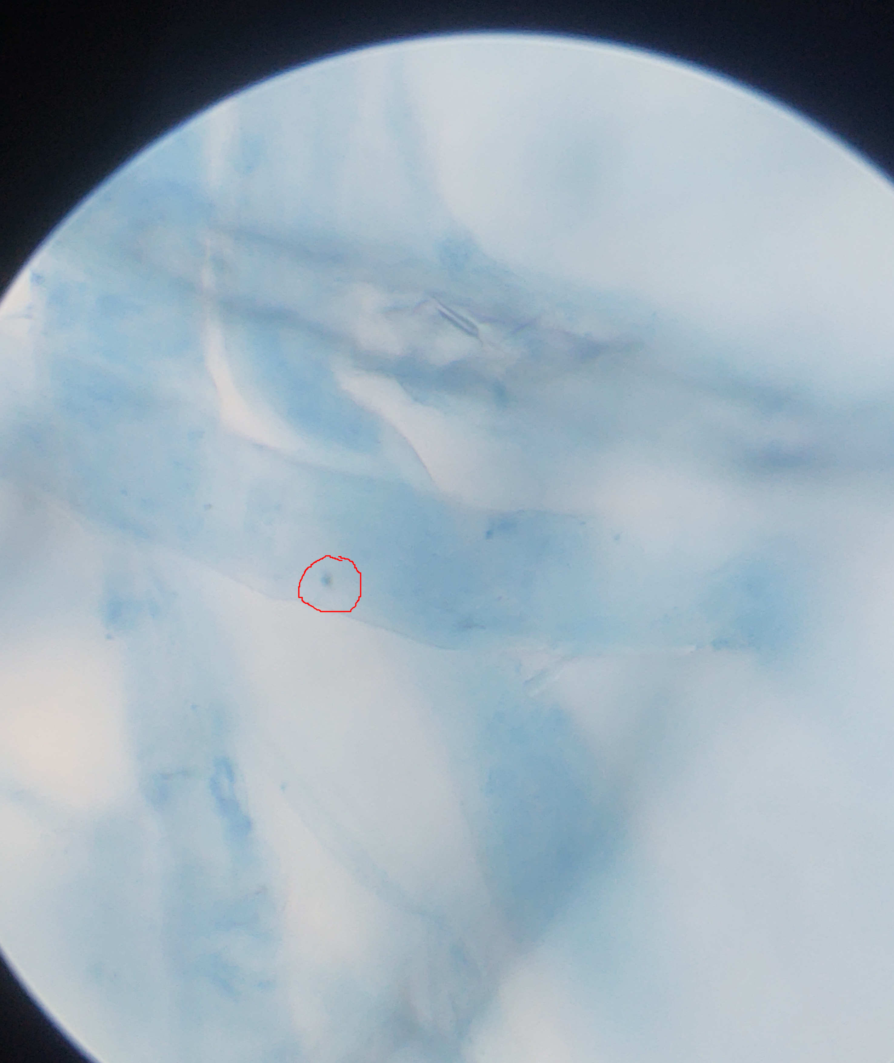

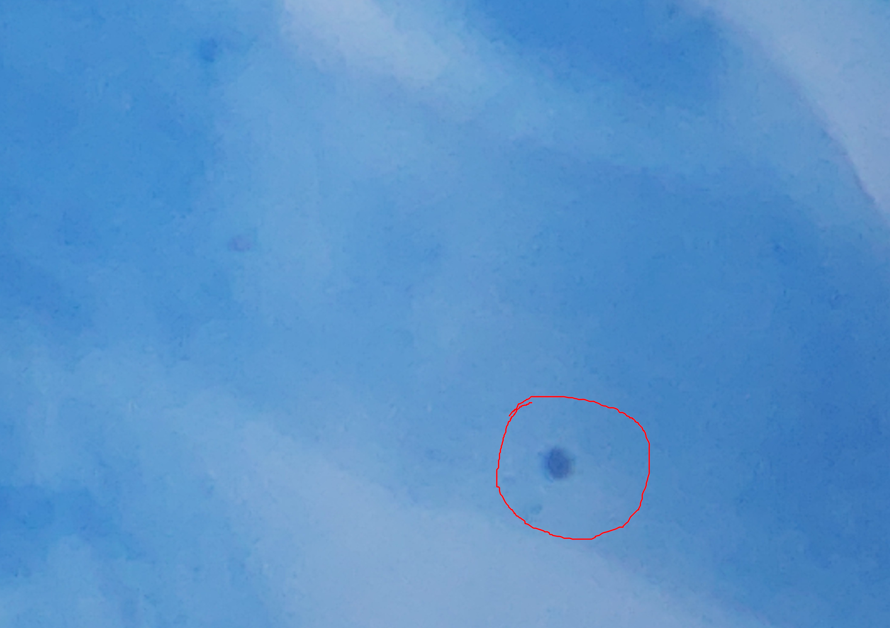

There's a number of things you hypothesize in your post about the size of pigment particles.
From what I've learned so far, one cannot see the liquid gel, its transparent, but as a mechanical engineer I can only assume that the velocity of a very viscous material at the microscopic level will be 0 near the wall which is at the paper. The sharing forces due to surface tension would largely overtake any kind of flow....thus if you wash it and it didn't come off, that particle in deep inside the various depths of the paper fiber web. Its pretty cool that you can actually travel thru the paper using the microscope since the light passing thru the almost transparent paper fibers actually forms an image as the focus place travels thru the paper. There are lots of crevices in between the fibers. Below you can see a well developed graphite ink PVAtype (LOL) on watercolor paper. As we zoom in 100X you can see that the ink is composed of a yellow chemical stain which we cannot see but gives the paper its yellow color and particles between 5 and 70microns. I circled two particles that I measured. Then we take a look at a 400X view of a NewCyanotype on regular 90lb printer paper. I marked the thickness of one of the fibers there and measured it to be 19 microns. so the question is where is the cyanotype particle? It has to be much smaller than 1 micron, possibly 50 or 100nm in size? And then another question I had was where is the gel? so I looked and looked for "floating particles", particles that would not be attached to a fiber but to the gel. I couldn't find anything like that. So if have stuff suspended to PVA and then you paint that over paper and wash it off after exposure, you are looking for particles attached to the fibers with a PVA film that is within the thickness of the fibers. the fibers look really big in the photos and really solid, but they are not, some are composed of smaller fibers, and in between those smaller fibers that's where you get staining that cannot be removed. Also in between fiber layers where there isn't a clear path for flow to happen. The only mechanism for removing stain is the shear forces created by the gel as it absorbs or releases water. Brushing helps but it only clears the top of the layers and not very well. These are just observations and hypotheses. It would be pretty cool to point the microscope at a sample thru the entire process some how with a mini exposure unit with built in wash lol just to see where the particles go and what they do during the various steps. I'll go take a look at the link about pigments, I can image that a few decades with better equipment than mine have been quite an eye opener.
What you're pointing out in the photo is particle agglomerations/clusters that are likely far bigger than the dispersed pigment particles.
Prussian blue molecules are the particles. But you're comparing apples & oranges here. The Prussian blue is formed in situ through the exposure of a sensitizer that was applied as a solution - which means that it's by definition way more finely divided in the print than any pigment-based print can ever be.
They're adhered to the paper fibers by means of the gel. If there were no binder, your fingers would turn black if you rubbed the print.
If you calculate the weight of the binder that you deposit in a print like this per square centimeter, you'll end up with figures in the mg/cm2 range. That's not a whole lot. You're not going to see a thick, yoghurt-like gel layer because there isn't one. What's there is basically just a thin lining that sticks to the paper fibers.

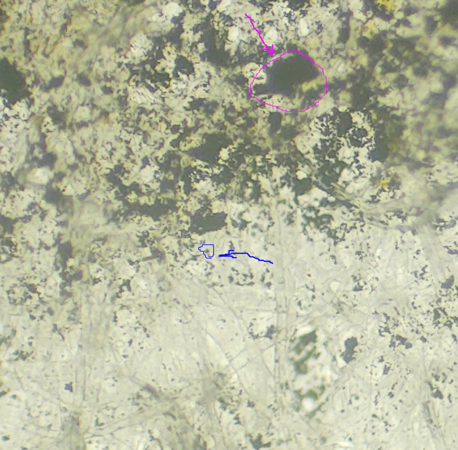

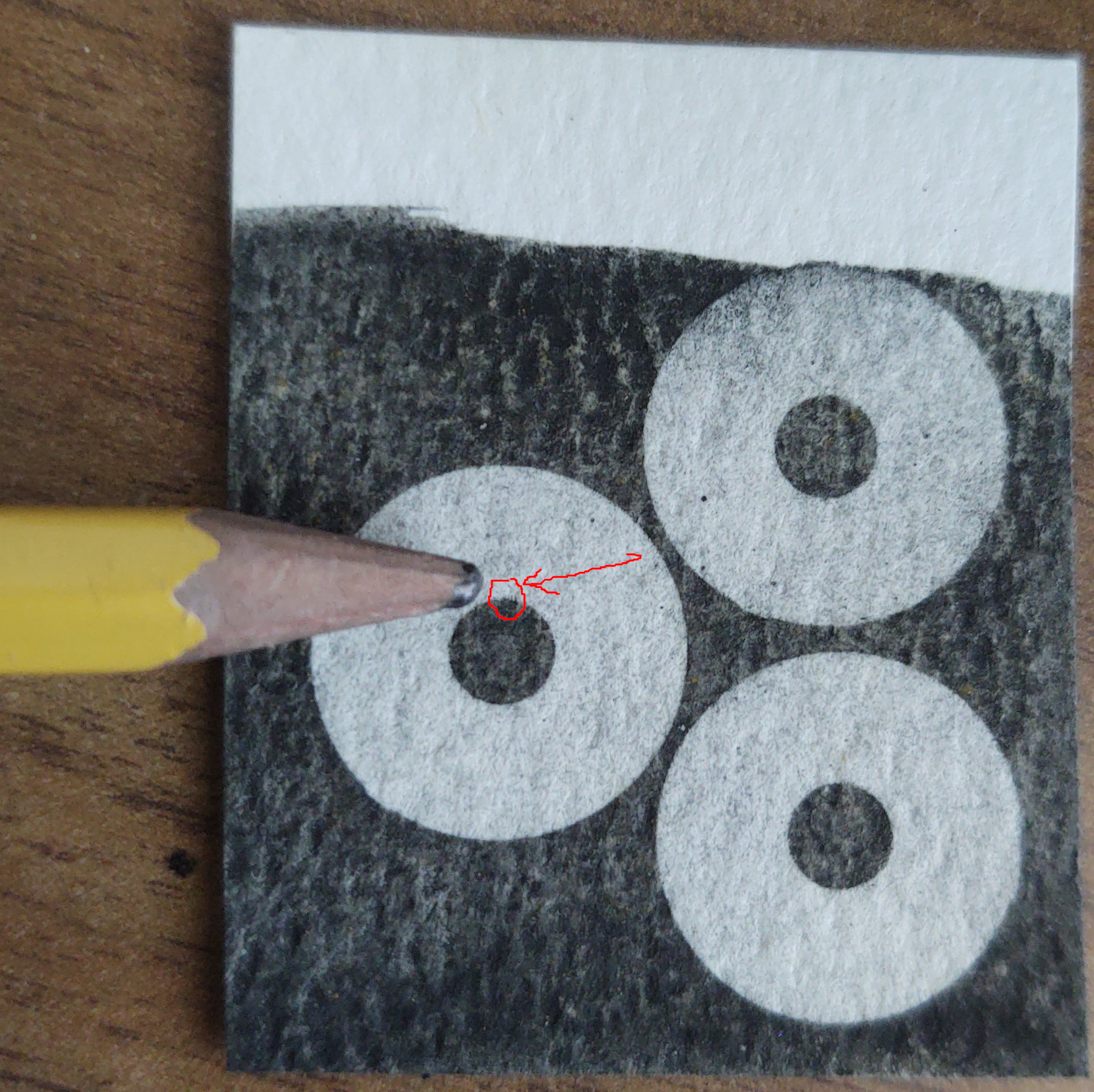

well with the graphite, those are definitely graphite particles. I just sacrificed an old failed cyanotype to see if I could find anything smaller than a micron. and I think I can. This one particle shown in the photo below was clear as day to the eye. my phone camera makes it pixelated and such, but to the eye, its still well resolved. I measured it to be 1.4 microns across. So I think .5 microns would still be obvious to see... however look at that fiber, its blue and no particles in sight lol, yup new Cyanotype is molecular level. its awesome to be able to observe stuff up close like this.

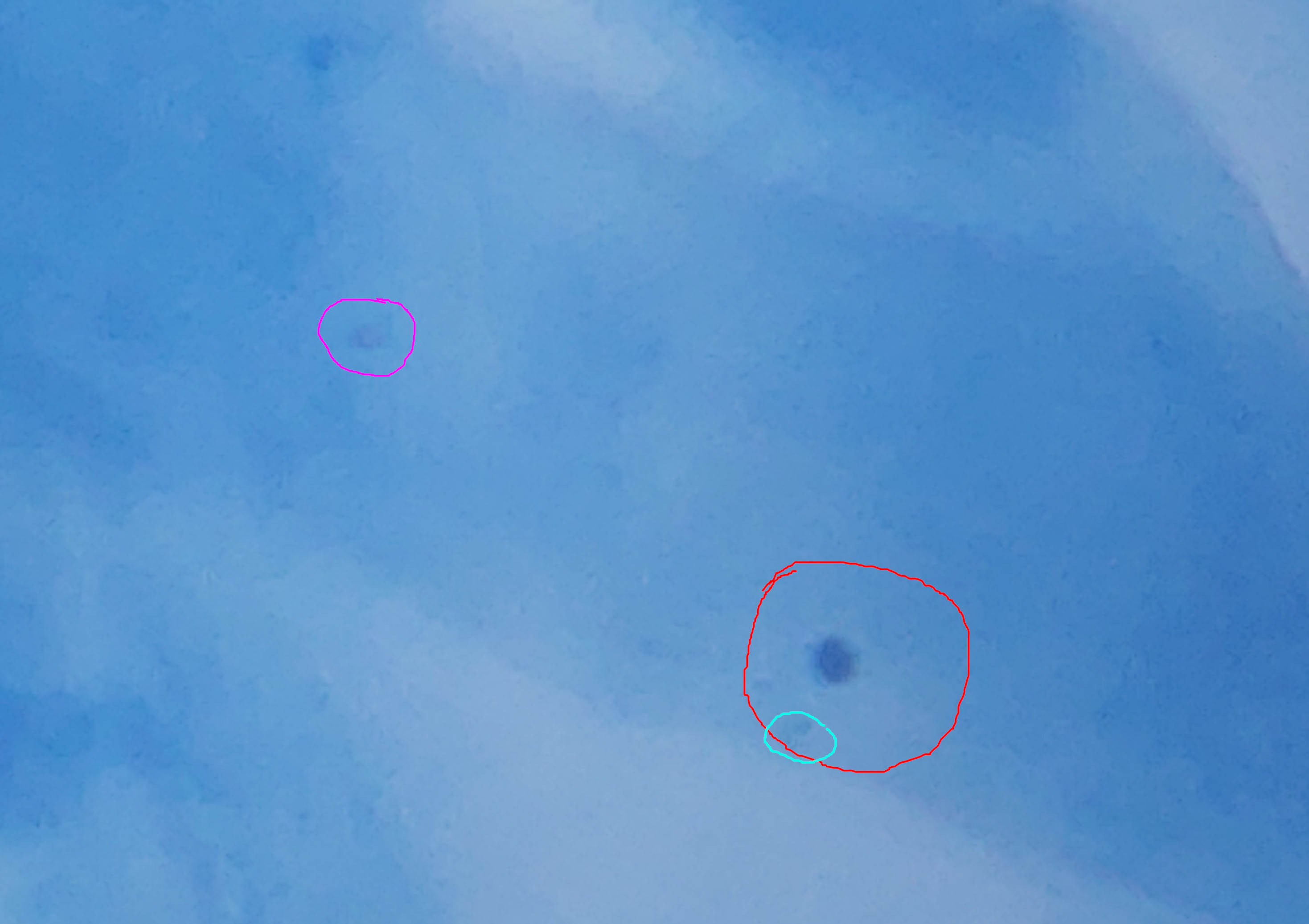

Oh I found a 0.75um (magenta) and a 0.5um (cyan) particle or more like agglomeration here:
Graphite is rather coarse and may indeed show up as clearly visible particles. This is also what makes graphite as such not a very suitable pigment unless it's further ground into a fine carbon dust. One of the problems with graphite is also the particle size distribution, which will be rather broad.
The specs you're finding are likely inclusions in the paper base from some kind of contaminant. This can be ink from previous uses of the same paper fiber or foreign particulate matter from another source.
Given the nature of a cyanotype sensitizer, which is a solution and not a dispersion, the resulting pigment will generally be very finely divided, especially with the New Cyanotype sensitizer. Classic cyanotype may exhibit clear pigment clumping due to pigment moving about after it has been formed; this is indeed one of the main reasons why Mike Ware developed New Cyanotype to begin with.
Note also that cyanotype as such will not form magenta or cyan (more so than its natural color) particles. It can go in the direction of magenta upon bleaching, but this would evidently affect a rather broad spot in the print, not a single cluster/agglomeration of particles.

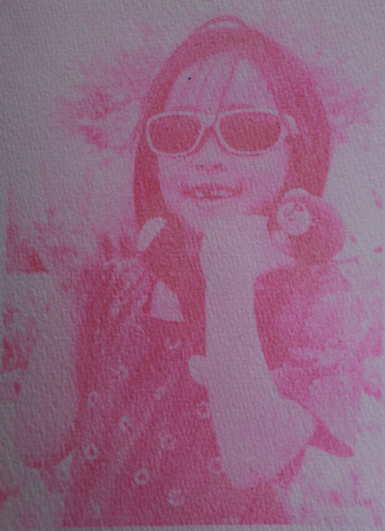

Okay I'm going back to the safe PVA only formula and I have a really good mix. Perfect sharp circles in 1 minute 380nm exposure:
2g 5%PVA
0.51g FAO
0.6ml og 0.01...dilute riboflavin into 50ml water
+Citric to pH 4 (before adding as 0.6ml
I don't know if this I'd necessary)
Lots of pigment
Add CMC to thicken liquid
Apply with brush and let it dry.
Expose for 1 minute
Spray with dilute 3%hydrogen peroxide
Immediately
Spray with with dilute citric+boric acids.
Wash in water. Depending on how much CMC you added it will clear within a few seconds to a minute. It clears to paper white and is very resistant to water. The boric acid polymerizes the exposed PVA after the peroxide magnifies the the ferric radicals.
imgprojts
May 24, 2024
189
Seattle WA
It seems to be working for images using bright white light from a projector. For sure that includes some UV or at least strong blue light.

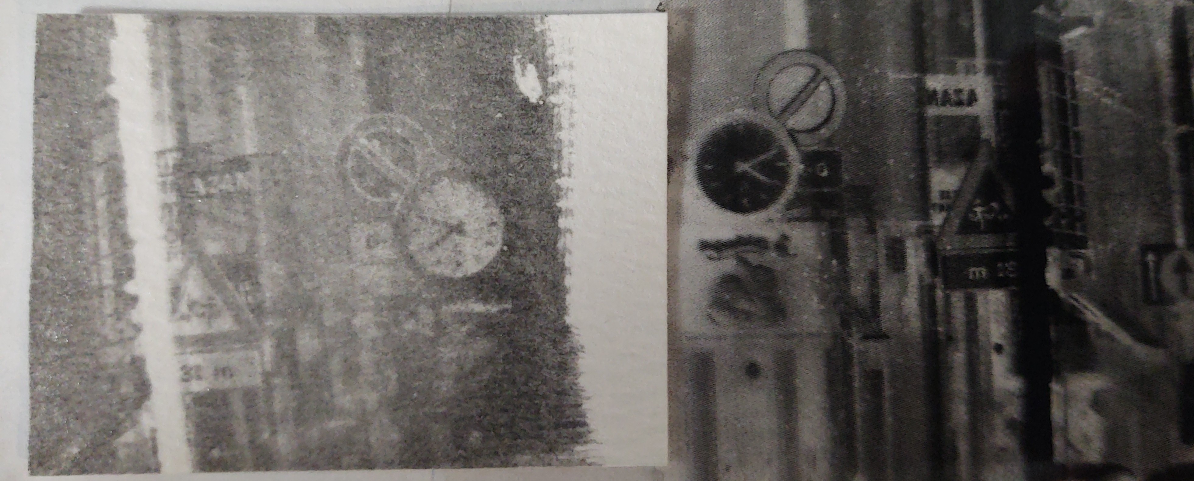

My laser printer cannot print on normal transparencies but I ran a sheet just to try it out. Its a new brother printer. With the emulsion side facing the print it kept getting jammed. Flipping it over worked but the ink was smeared. So I just made a sample near the clock. I get all the clock details and the text. I even get sharp microscopic patterns from the laser print pattern. I think we got this. My light source and negatives suck but maybe someone else can try it. Its all safe non toxic chemicals.

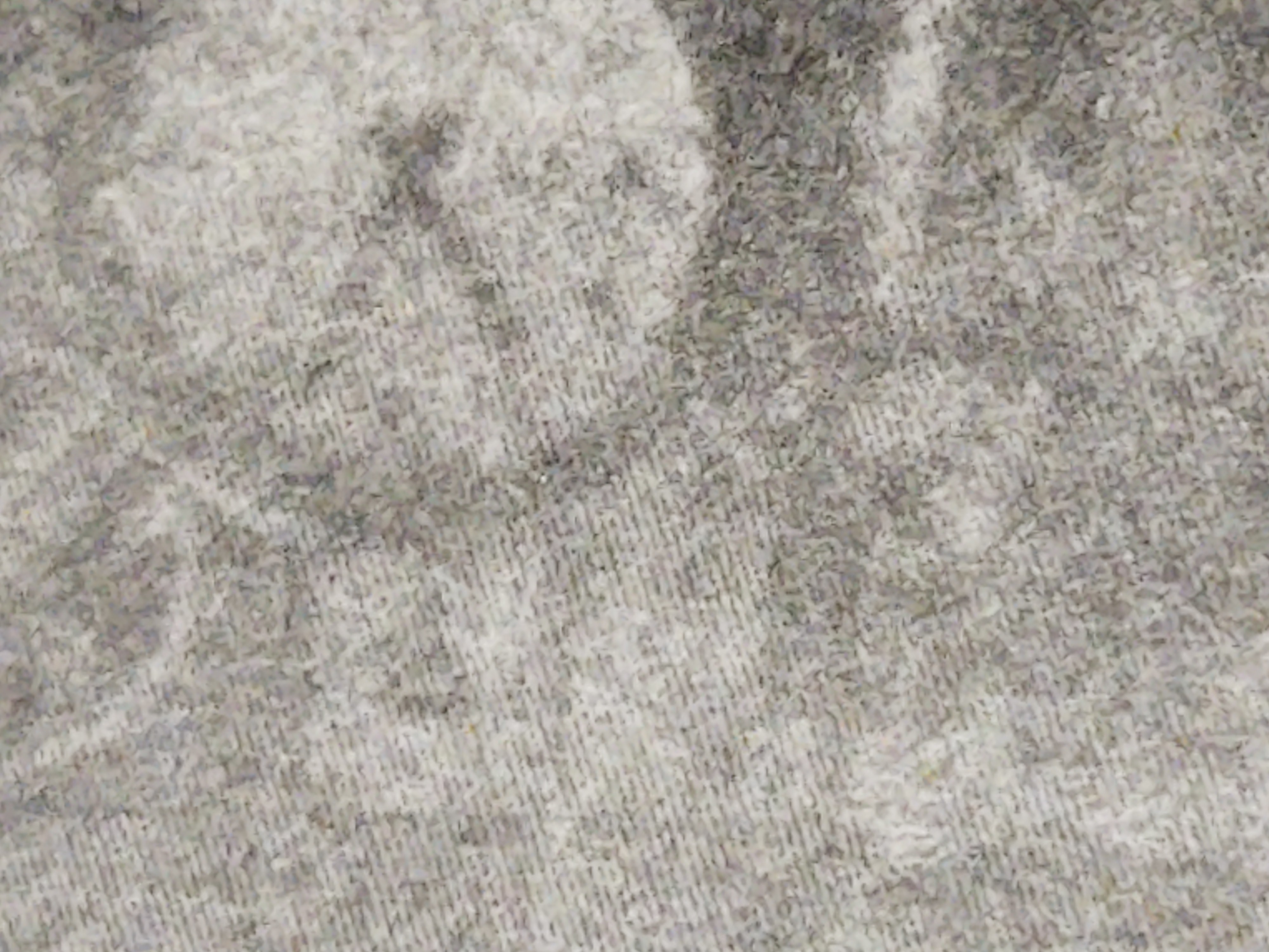

Here's a Better zoom into the print pattern.

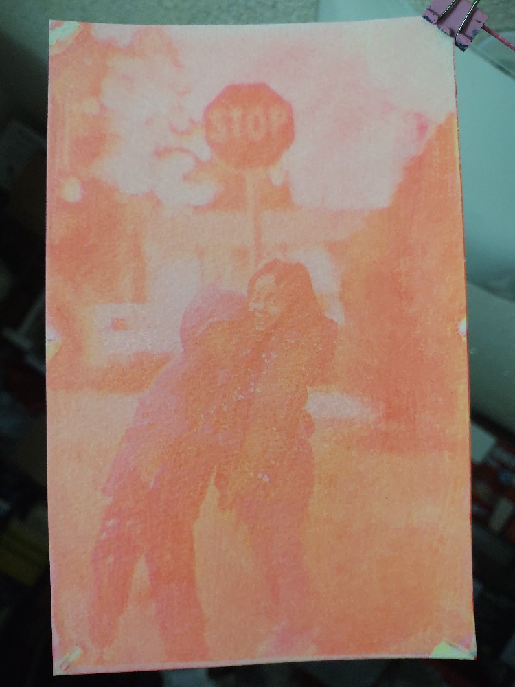

Its 2am and I'm having a hard time sleeping, so here's a thought I just had. The nice images made by exposing my various CMC, PVA etc mixes have been using a 50W, 380nm LED lamp from fairly close distance ~2 to 4" away. The ugly test prints were all made using a 4000lm projector with no special modifications. The projector clearly outputs some light close to 400nm because it can do cyanotype however the power output is miniscule. I measured no voltage using a 365nm LED, no voltage at 380nm and a tiny voltage at 395nm. All that makes sense, you don't want people getting cataracts from watching movies at home. So now, I'm close to the finish line upgrading the projector to 385nm. Before it could make a cyanotype in 15 minutes 7x10". I've thus far made a 385nm cyanotype 3"x4" in under 10 seconds. So my hope is that I'll be able to expose the polymer mixes to 385nm images to really see their image making potential. If the projector made images that are barely visible at 400nm, it might make more acceptable images at 385nm. Currently I'm just trying to homogenize the light with as much power as possible on the projector's chip. Once that's working, I'll be making cyanotypes again and then come back to the polymer mixes.
imgprojts
May 24, 2024
189
Seattle WA

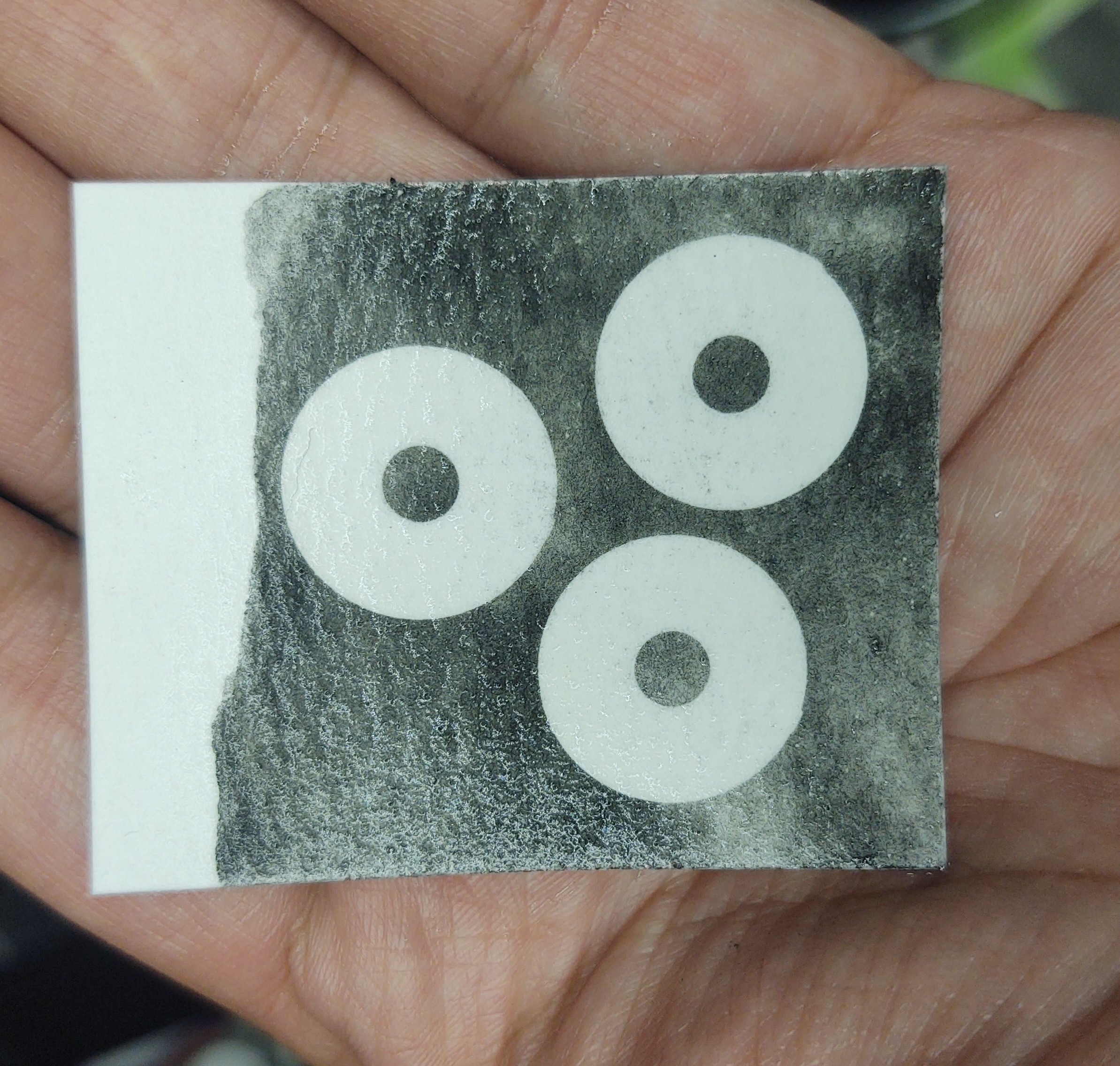

Now that my UV projector is working I've given this thing one more shot. I've personally never made a gum bichromate print but I think understand what its supposed to look like.
Today's experiment:
2.73g CMC
4.63g PVA
0.6FAO
1mini spoon of magenta mica
1 drop of hand soap to dissolve the mica
Resulted in a very well cleared image with the 3 washers on a small coupon at 3 minutes 365nm exposure. So then I moved on to 3 minutes on the 385nm projector. I could see an image in the darker burnt areas but not as pronounced as it was with the washers. So I let it go for 15 minutes checking every so often to see if the image was getting darker. I then sprayed peroxide .3% which immediately darkened the image's burnt areas really well. Next a spray of dilute boric and citric acid. The image was coming up pretty good. I think that if I kept shaking it, I would probably loose the image completely. However the process gave me a good minute or two of reveal time. I then proceeded to dry it. It looks like this works well. The digital negative is very contrasty and dark.
imgprojts
May 24, 2024
189
Seattle WA
Its almost the last day of the year but I managed in a few experiments today:
similar to the previous combo
3g CMC
5g PVA
1.5FAO -> maybe 3g.. I doubled doubled the amount accidentally due to my great memory.
0.29g ~1mini spoon of mica plus a similar amount of graphite powder
1 drop of hand soap -> optional only if the mica doesn't mix
1tiny spoon of citric acid to control the PH
This resulted in a good image, this time in Black mica with some graphite powder. I exposed for 1 minute and that was not enough resulting in an image that had some missing areas. Next I tried 5minutes. this resulted in a good image. The edges are not super sharp. I might have added too much FAO. Trying the exposure for 15 minutes in 365nm I could see the image burnt of the 3 washers onto the paper. immediately after spraying with peroxide you can see the brown burnt areas turn various shades to gray, its very much like the effect of peroxide on cyanotype. When sprayed with dilute acid mix the sample again changes colors quickly in various ways. Finally rinsing revealed an image not too different than at 5 minutes exposure. I'll have to take some video of the color changes. I think a good amount of ferric ammonium oxalate is probably 1g.
I have a bunch of questions about the process like is the peroxide and acid really necessary. Those are simple tests. But then there is also the question about whether this is in any way equivalent to gum bichromate. For that I want to try to do a 3 color layered exposure. Ultimately my goal was to print a few color prints to decorate the living room, but this has sort of grown into a...hobby. Along the way I've uncovered a few mechanisms surrounding the process that don't seem to be mentioned anywhere. For example PVA and CMC mixed or PVA alone will react with Boric acid to form slime similar to what the kids play with. So I took that idea and tried to develop in boric acid and of course that didn't work. You get a solid film of slime on your paper which is mostly water insoluble. But as I tried a few things, if you mix Boric and citric and spray it after spraying the image with peroxide then the image develops in water. If you spray the chemicals in reverse order the image just washes away. if the mix is too strong you get a solid color slime film. Citric acid seems to clear the image to paper white. Without it you get color staining. So these conclusions are drawn from observations but I could be way off. All my cyanotypes using the newcyanotype formula have been by replacing the mica powder with the cyanotype formula in this recipe. When its wet you can see incredible detail in the cyanotype. once dry that detail is still there if you look in the right light, but its mostly hidden. I may look into spraying the image with a clear coat or maybe laminating to see if the detail comes back. I'm scattered brained about this thing just thinking of what to do next.

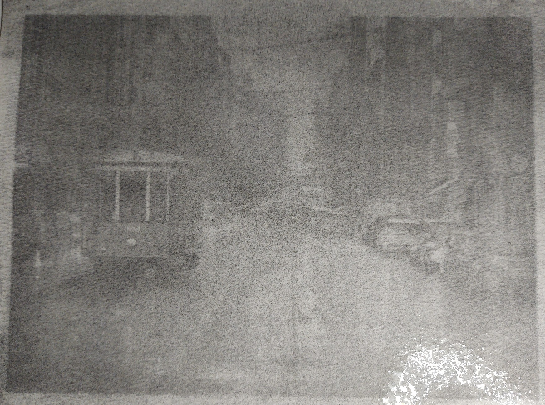

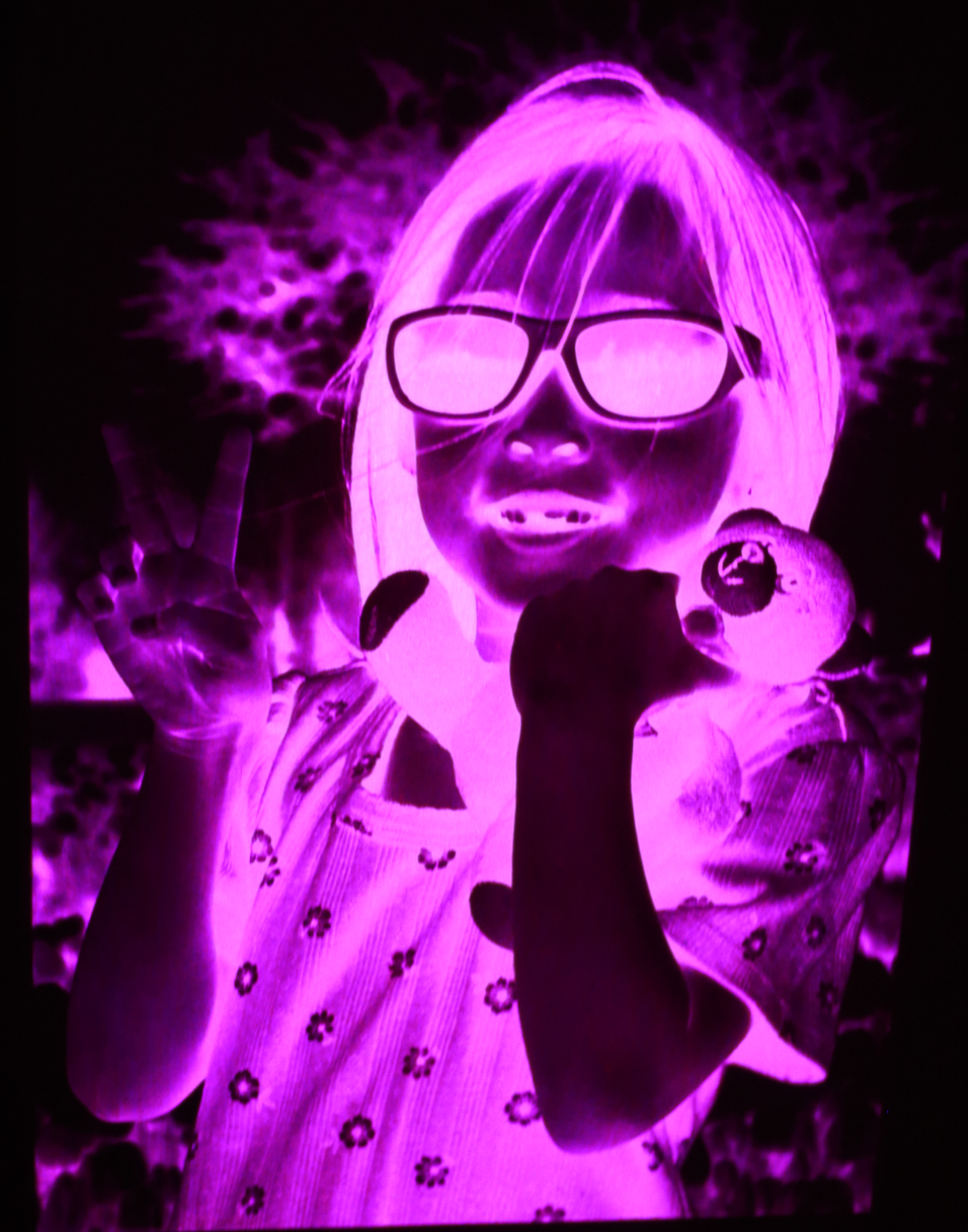

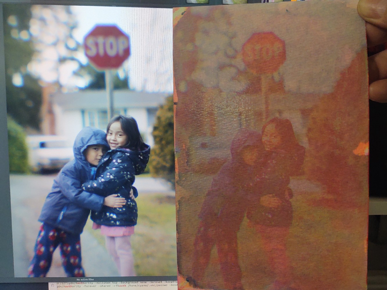

I'm excited again. Today I did 2 layers with the PVA-CMC process. I did a yellow bottom layer and magenta layer. The top layer will be a cyanotype. The family wants to watch a movie so final image (or screwup) tomorrow. What amazed me today is that there's visible relief in the wet image. I thought that was a gelatin thing only.....a few hours later. I prepared and exposed the cyanotype layer and I am totally floored. I had my yellow glasses on and couldn't immediately grasp the magic.
The final result looks far beyond my expectations. Its far from a fancy print. This is just a proof of consept showing that the color CMC/PVA-FAO system works. For me its the very first time I've made something that looked like a color print. My first and previous attempt was a horrible looking mess. This time it does look like a color print.
imgprojts
May 24, 2024
189
Seattle WA
I tried adjusting some of the colors. It looks to me that there was a color imbalance because more detail shows up when I play a little with the colors. For example the white hearts on her sweater and the spider-man faces on his pjs. I thought my registration was really way off but I think maybe it was in the +-1 or 0.5mm range. The lens is supposed to have crazy color aberration all around away from the center. The way I aligned the layers was pretty simple. Just turn on the projector and align the projected image to the previous dry layer at the center since the two faces are most important and sharpest. Then I would turn the projector off and paint the next layer in. Then I just let it dry and expose it.
