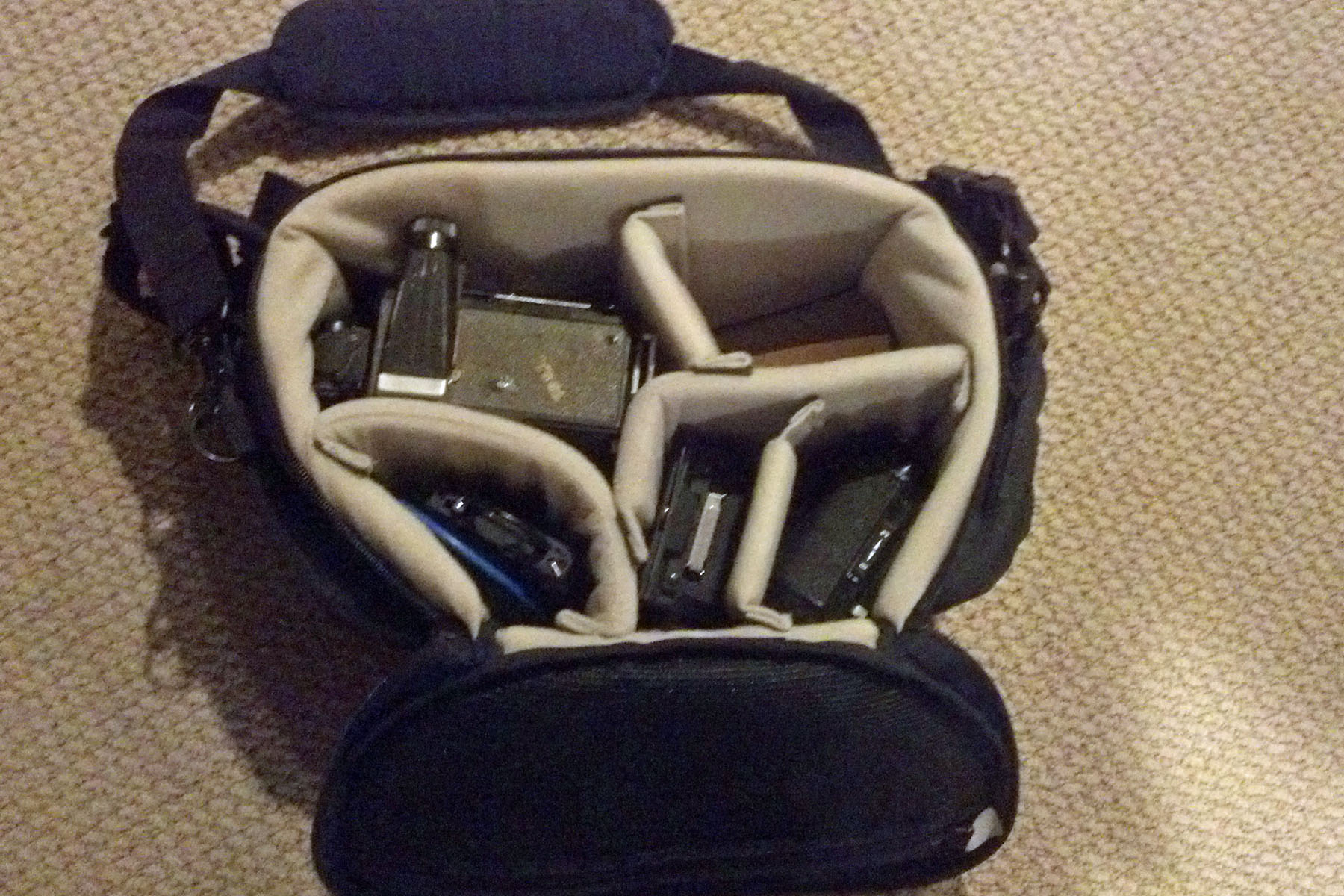

You're right about the sheet film availability. And what is available is only about 10-20% cheaper than 4x5. But you're wrong about "only a bit" larger and heavier. Here's my 2x3 century graphic in a hip pack.

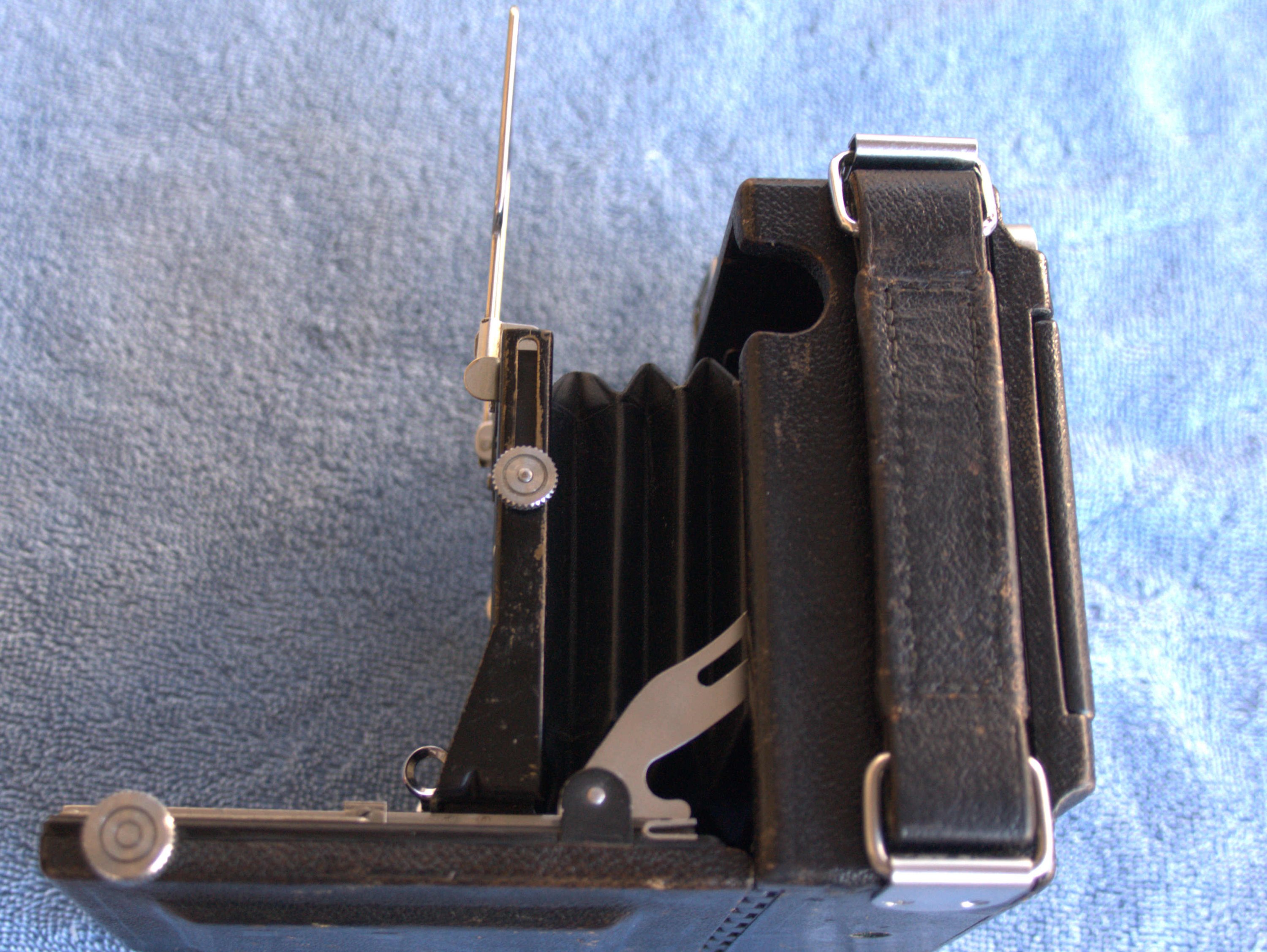

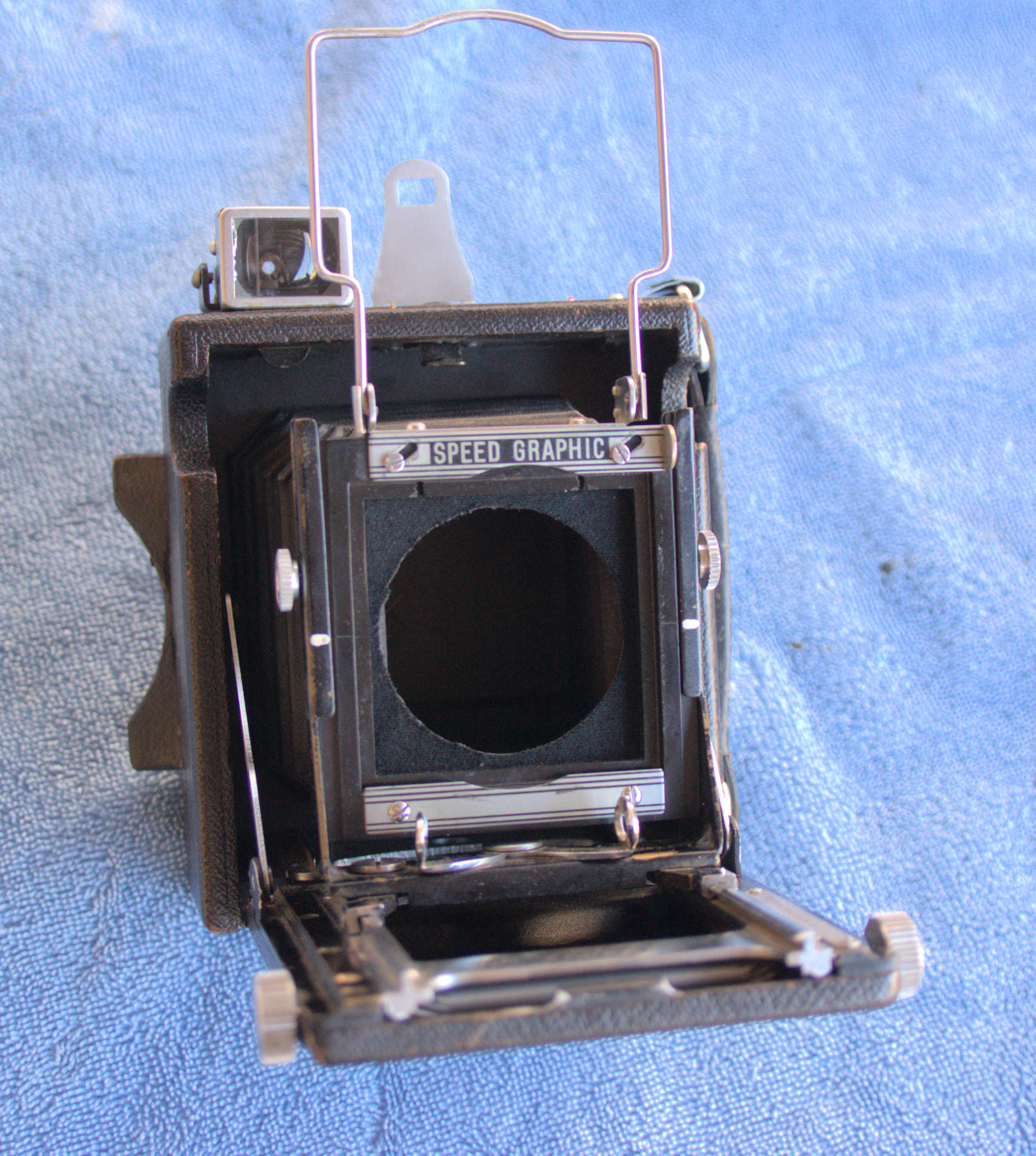

I like the compactness of the Speed, here are a couple of images, maybe you can help with ID. I don't see any way to tilt the from standard, the rails are channels, cant be moved forward or back. It seems to be a speed design with the focal plane shutter.
Paul, your Speed is a Miniature Speed Graphic (that's the official name), not a 2x3 Pacemaker Speed Graphics.
Odd, my Baby Speed Graphic has the focal plane shutter. Did someone swap out the front standard from another camera? Is there a Miniature and a Baby? I assumed they were the same thing. I think my manual refers to the Baby Speed.
Mine is also 2 1/2 inches deep, the same a crown. I don't see drill holes that would indicate that a focal plane or rangefinder had ever been installed.

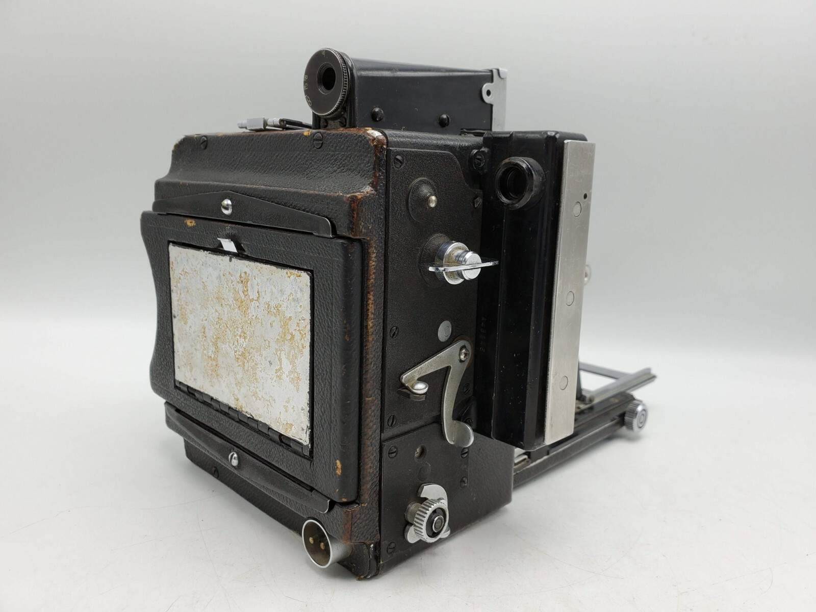

Found this image of a miniature speed with the focal plane shutter. Not that it matters, it is light, not as much movement as I would like, otherwise will make a nice filed camera.
Did not notice, upside down as well. I think your right, my version has scale focus for a 90mm, on the miniature speeds and crowns that are listed in the Montgomery Ward's 1952 Photography Cat have 101 lens. So a striped down body with somewhat wide angle for a 6X9, interesting.

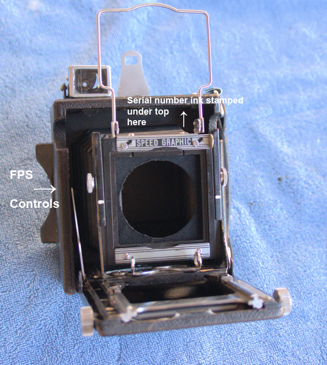

For the second and I hope last time, you have a Miniature Speed Graphic. The camera in the picture in the post I quote here has the shutter winding key, slit width selector and shutter release of a Miniature Speed Graphic. It is a Miniature Speed Graphic, not a Pacemaker Century Graphic.
The last picture is an image I picked up from the web, my first images I took are of my camera, no winding key, no selector, I've owned a 4X5 speed for over 50 years, I know a focal plane shutter. I might be just confused, did Graphic ever make a sell a Speed model without a focal plan shutter? All the examples of miniature speeds I found have had focal plane shutters. The body looks like the picture of a 2 1/4 X 3 1/4 Crown I found in my 1952 Montgomery Wards Catalog, but the front standard is a Speed.
The last Graphic model introduced was sold as the Super Graphic and Super Speed Graphic. 4x5 only. The difference between the two was the SSG's normal lens, which was mounted in a Graphex shutter than went to 1/1000.
All other Speed Graphics have focal plane shutter. The Pacemaker Crown Graphic is the only Graphic without a focal plane shutter.
The name "Speed Graphic" on the camera whose picture you showed us in post #1 above is on the upper lens board slider. It is as it should be. That camera is a Miniature Speed Graphic (official name). If it has no focal plane shutter (not focal plan), the shutter has been removed. I'm out of this discussion, there's no point wrangling with a person whose mind is firmly made up.
