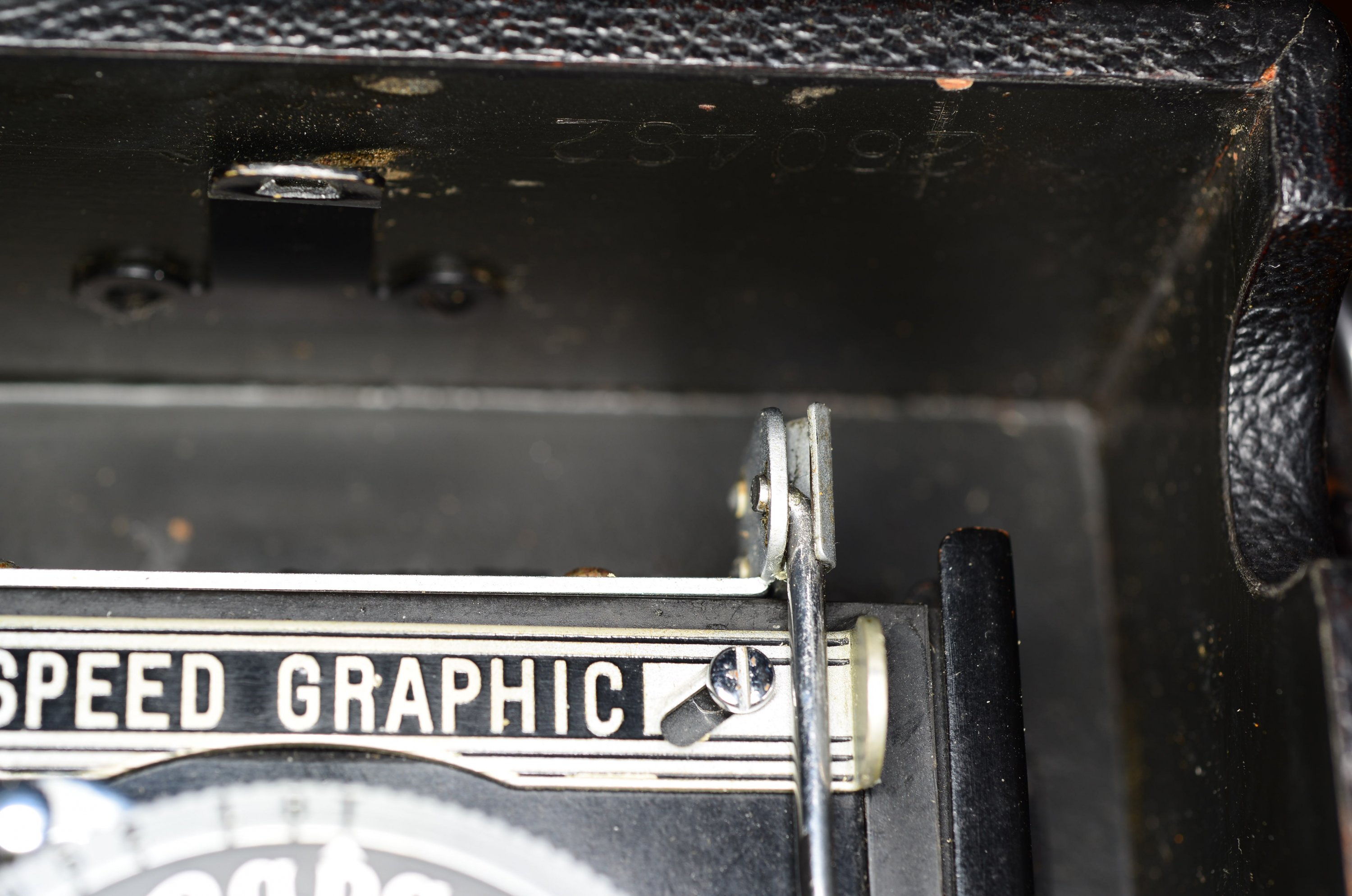

I found the manual for the miniature speed online, and only one line concerning the shutters, "The Speed Graphic is usually provided with 2 shutters; the focal-plane shutter, and a between the lens shutter." Usually means that some were produced with only one shutter? My speed is 2 1/2 inches deep to shallow for the focal plane shutter, there are no drills holes for one either. On the top of my example is what I think is a a store decal, Flaton.
Stop dreaming. Accept reality. People have been know to remove Speed Graphics' focal plane shutters.
I don't see one. BTW, it's not a store decal, very faint, on the front of the rails, the cross bar, engraved G. Flaton, the name of the owner.
Read post 19 and click on the thumbnail.

My Miniature is 2 7/8 inches deep from front edge of the body to the back mount edge; it is 1 3/4 inches deep from the front edge of the body to the bellows mount plate; and its serial number is shown in the attached picture.
