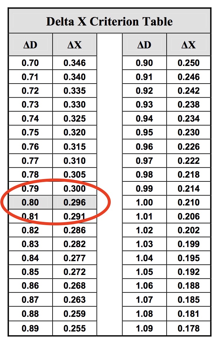

As it turns out, the fixed density method has a direct relationship to the fractional gradient method when certain parameters are maintained. From a paper that should be required reading :smile: "Delta-X Criterion"
My spreadsheet broke a little when I changed software, but in its last version, after calculating W-speed, it displayed an ASA triangle. But required user to OK the curve fit inside.
The next version was to use that table (or similar) to iterate the numbers and by the spreadsheet's trial-and-error logic operator, find the Delta-X criterion that fit the film curve, thus the ability to automatically get the Delta-X speed from any curve, the same way it obtains W-speed from any curve.

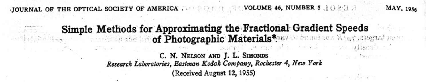

Attached is my article on Delta-X. The scientific paper is Nelson, C.N. and Simonds, J.L, Simple Methods for Approximating the Fractional Gradient Speeds of Photographic Materials, JOSA, vol. 46, n. 5, May 1956.

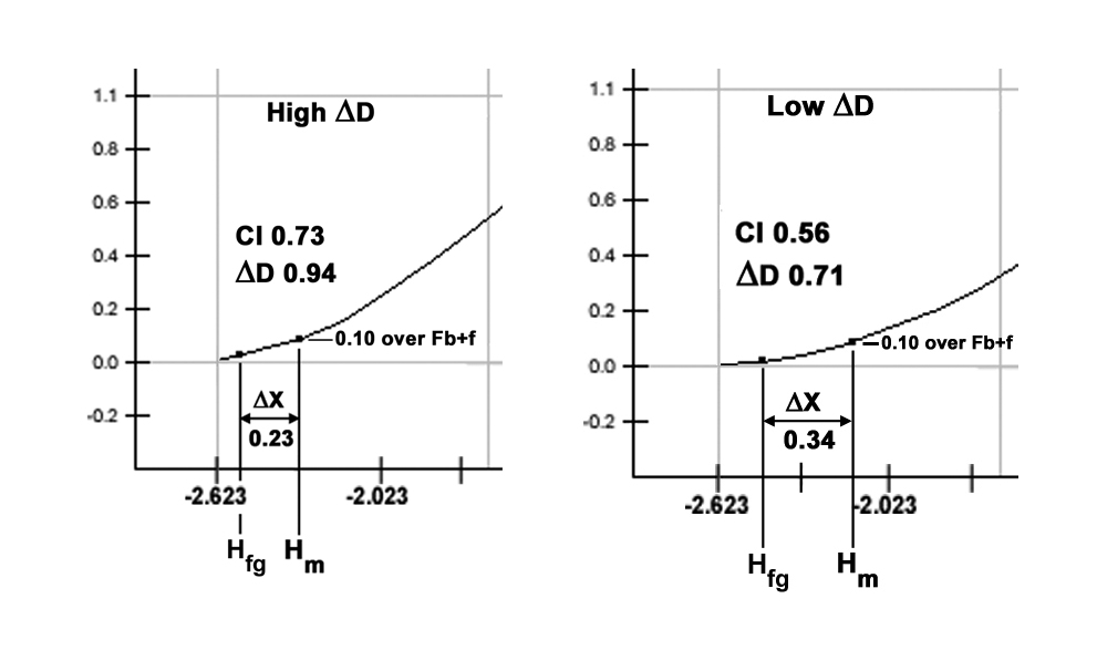

One of the concept I find interesting about using a fractional gradient method is that there is an inverse relationship that exists between ΔD and ΔX. With higher than normal processing, the distance between the two points is reduced and the reverse is the case when the processing is lower than normal. The results is the film speed doesn't increase or decrease to the degree it would if using fixed density method.
Notice in the table above how a ΔD of 0.80 produces a ΔX of 0.296. This is the ISO standard. When the film is processed according to the parameters of the standard, ΔD = 0.80, the fractional gradient speed point will fall 0.296 log-H to the left of the 0.10 fixed density point.
With a ΔD of 0.70 resulting from reduced process has the fractional gradient speed point at 0.346 log-H from the fixed density point effectively producing a higher film speed than what would result from the fixed density method.
With a ΔD of 1.09 coming from increased processing, the ΔX is 0.178 log-H or about 2/3 of a stop shorter than with ΔD of 0.70 and about 1/3 stop less than with ΔD = 0.80. This will keep the speed from extending processing from raising as quickly as it would with the fixed density method.

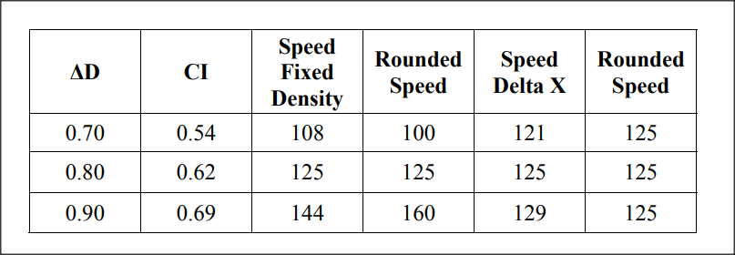

The table below is an example of how speeds compare between the two methods. Please keep in mind that the film speed equation is different when calculating from the fixed density point and the fractional gradient point. So just because the fractional gradient point is almost a stop below the fixed density point for the ISO standard, doesn't mean the film speed is one stop faster.

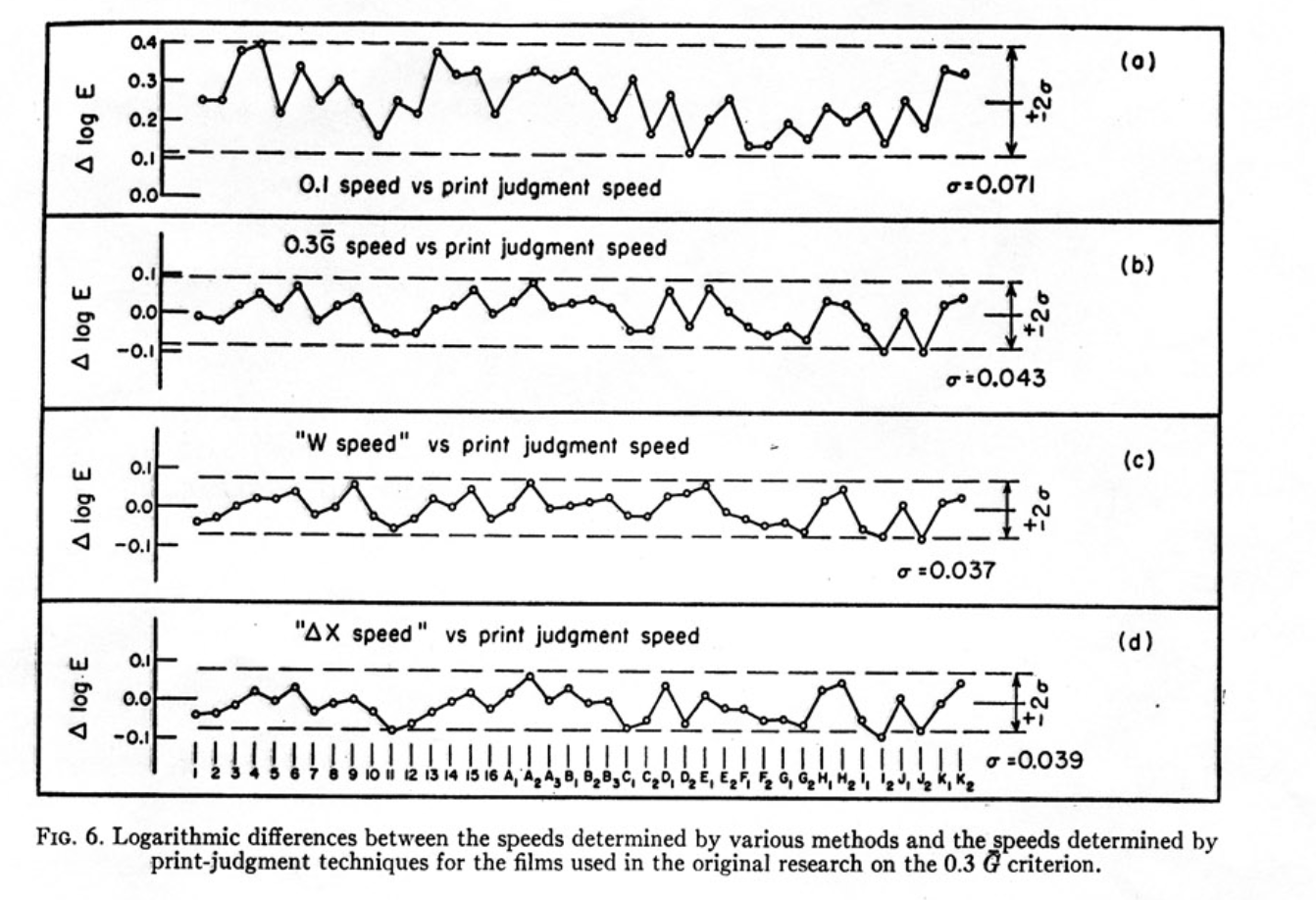

Here are some results of the 'film speed shootout' comparing the speed formulas to observer's choice of best print.
0.1 was the worst. In this chart, Delta-X and W-Speed were both actually BETTER than 0.3G.
Those charts look a lot like quality control charts, depending on what the x axis signifies? What is the x axis in these plots?
It looks like there is a high correlation between the charts in b, c, and d, but less so in a. Also, the 2x sigma of b, c, and d are quite close (perhaps the same within statistical error(?)), and a lot less than a.
Also, it looks like there is an offset (bias) in a, but not in b, c, or d. It looks like b, c, and d are probably just about equally good.
Notice how each is a "vs Print Judgement Speed"? Print Judgement Speeds are the results of the psychophysical testing from the First Excellent Print test. This was an incredibly laborious effort so a sensitometric method needed to be determined which would most closely approximate the results from the psychophysical test. Different methods to determine film speed were applied to each of the negatives. The graphs represent how far each came from matching perfectly to the print judgement test, point 0. The tighter the spread, the more accurate the method over the various film types and curves.
Does each point on the horizontal scale correspond to the evaluation of an individual print?

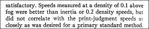

This also comes from the paper Simple Methods for Approximating the Fractional Gradient Speeds of Photographic Materials. These examples shoe the inability of the 0.10 fixed speed criteria to predict the effective speed of film with different curve shapes. The difference between the 0.10 fixed speed point, S', and the print judgement speed, S, ( the fractional gradient speed point is indicated by the small arrows) varies depending on the curve shape. In these cases, toe characteristics, left 3 examples, as well as average gradient, right 3 examples.
The individual negatives that produced the prints that were judged, yes.

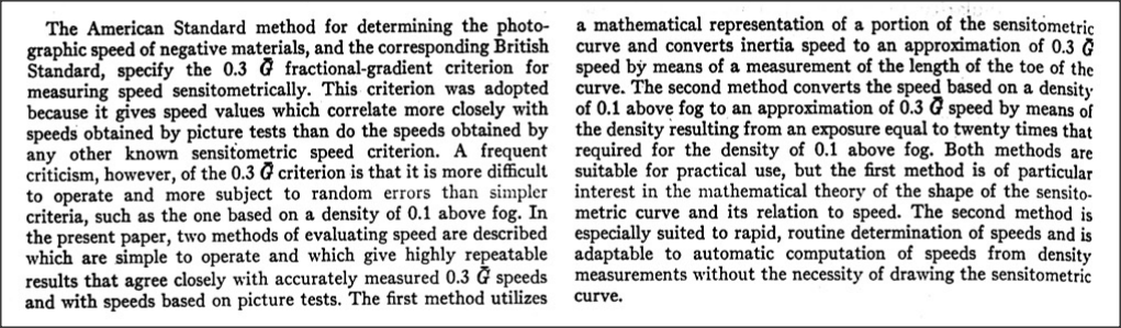

The abstract and first two paragraphs from the introduction.

The vertical axis is log-E or today log-H which I have to believe is the difference in where the film speed fell from the aim of 0. 0.1 would be 1/3 stop. The plus and minus would be considered faster or slower speeds than the judged speed.
Stephen, I found the paper you referenced (Simple Methods for Approximating the Fractional Gradient Speeds of Photographic Materials) and downloaded from my university library. It should make for interesting reading.
Enjoy.
The internet these days. You know how long it took me to track down all these papers? Searching through the stacks at USC and UCLA, and all those hours standing over a hot copier machine.
