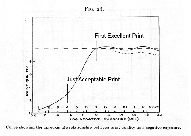

The vertical axis is log-E or today log-H which I have to believe is the difference in where the film speed fell from the aim of 0. 0.1 would be 1/3 stop. The plus and minus would be considered faster or slower speeds than the judged speed.
How about the x-axis? Does each point represent a photo that was evaluated?
At the bottom of the ΔX chart, there are number codes that represent the print or corresponding negative from the tests. There is a lot more detail on the materials and how they were handled in the papers associated with the first excellent print test and it's conclusions. Like The Evaluation of Negative Film Speeds in Terms of Print Quality, parts 1 and 2. One is more on the conditions of the test and two on the results. And The Brightness Scale of Exterior Scenes and the Computation of Correct Photographic Exposure.

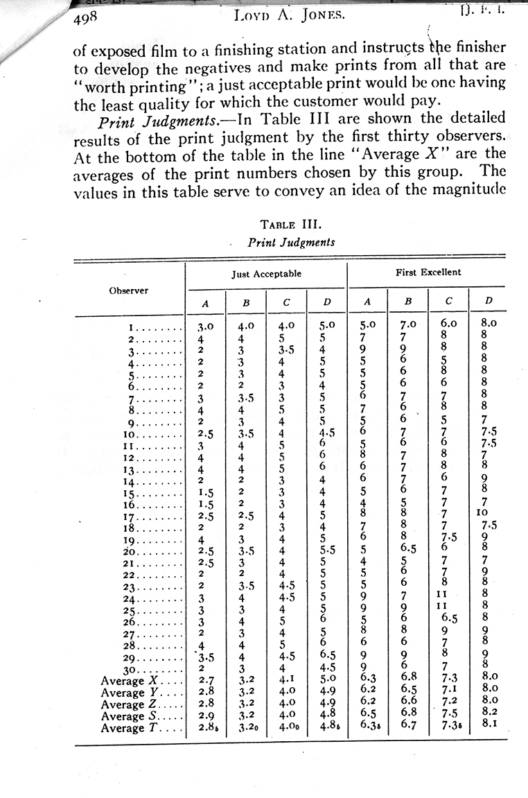

I decided to skim through Jones' paper The Evaluation of Negative Film Speeds in Terms of Print Quality as it's been many years since I last read it. I found a number of really good quotes that might be of interest.
Print Judgements
" The long and laborious computation of tone reproduction quality and the attempt to establish a satisfactory correlation between sensitometric results and the statistical results derived from the print judgements was begun."
Evaluation of Speed
"The speed of a photographic negative material should be evaluated in terms of the minimum exposure which will yield a negative from which an excellent print can be made."
"Statistical Evaluation. - The most direct method making the evaluation as defined above appears to be by the direct judgement of print quality by a sufficiently large group of observers so that the average may be relied upon to agree with the average opinion of the photographic public at large."
"While there is no question that the statistical method already described yields results of satisfactory significance, the operation of such a method of speed determination in practice is quite impossible. The amount of labor involved in making a series of negatives and prints therefrom and in having them judged by a sufficient number of observers to establish the desired certainty in the statistical average is prohibitive. It is essential; therefore, that some sensitometric method be found which will yield results in close agreement with those obtained by the statistical method. As already pointed out, speed values based upon inertia are not proportional to those given by the statistical method of direct print judgement, nor will the use of a low fixed value of density accomplish the desired end."

Some results from the Print Judgement method:
The number of the negative that yielded the print is used in the following evaluation.
Here are the negatives that produced the four examples. I emphasized the inertia point which was one of the speed methods used. Depending on the curve shape, it's relationship with M (approximate 0.3x) varies considerably. It's also interesting to note the negative preferred for print D has higher exposure than the others and that it belongs to a long toed curve.

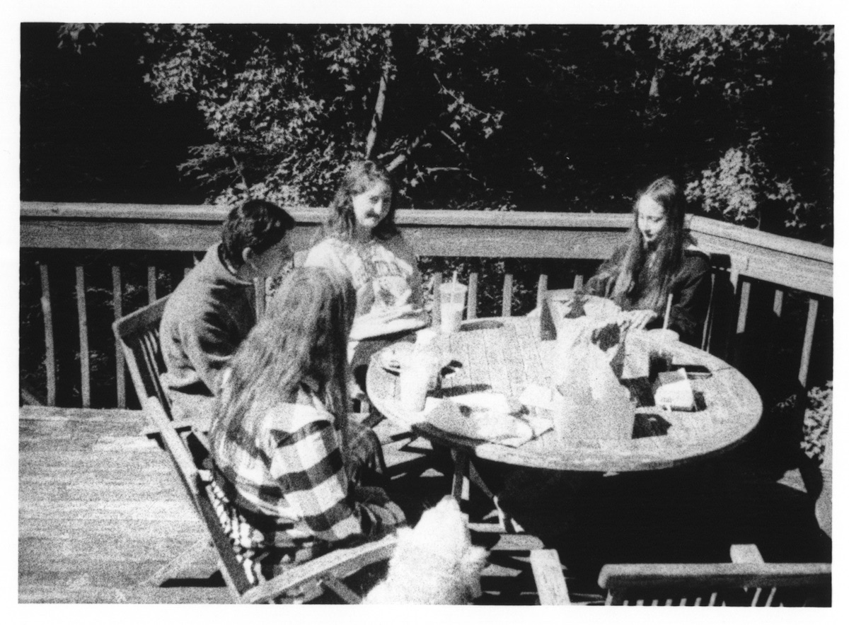

This shows that over-exposure and over-development are horrible for small format negatives.

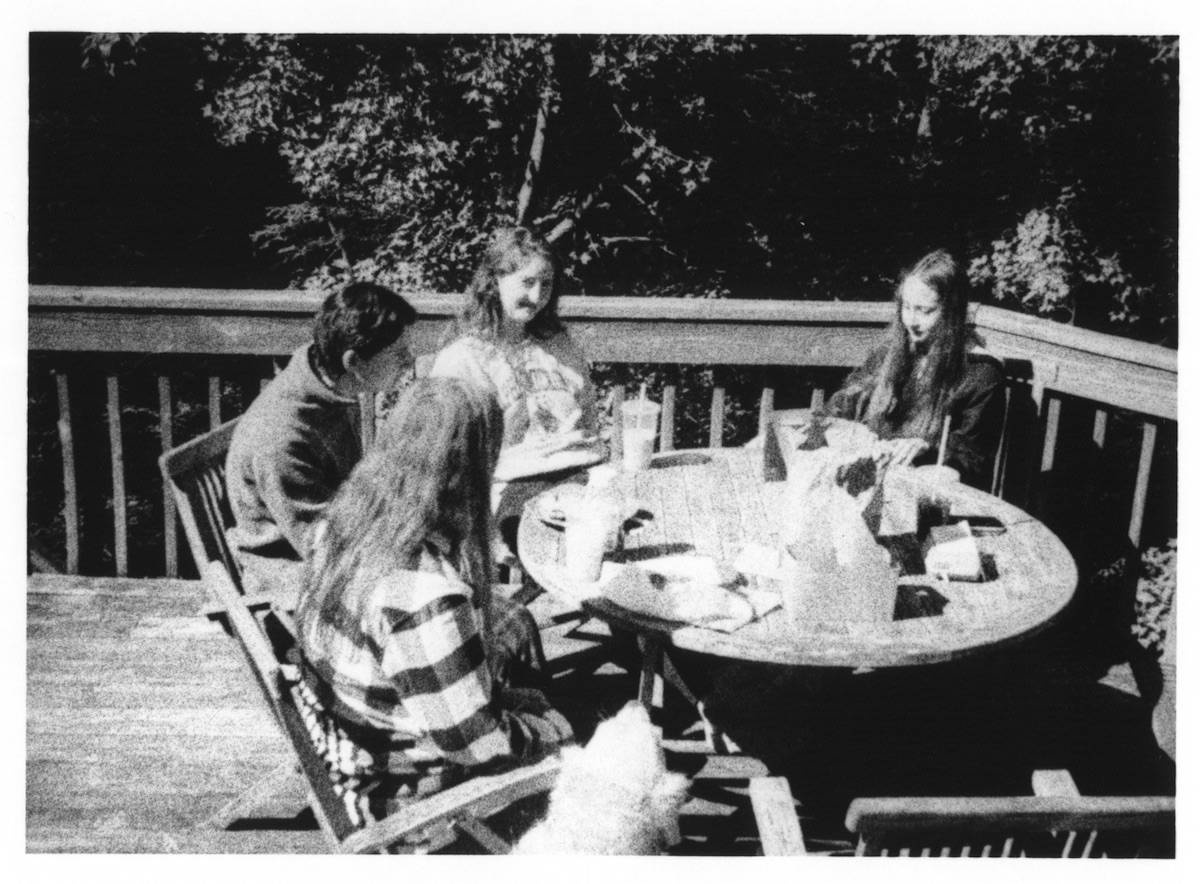

I just printed some HP5 Minox negatives. Exposed at EI 200 and inadvertently processed for 6 min, instead of my normal 5 min for that film.
The image is in focus and the shutter speed is 1/2000, yet the resolution has diminished quite substantially from what would be achieved under ideal conditions.
Is it decreased resolution you are seeing or increased grain or both?

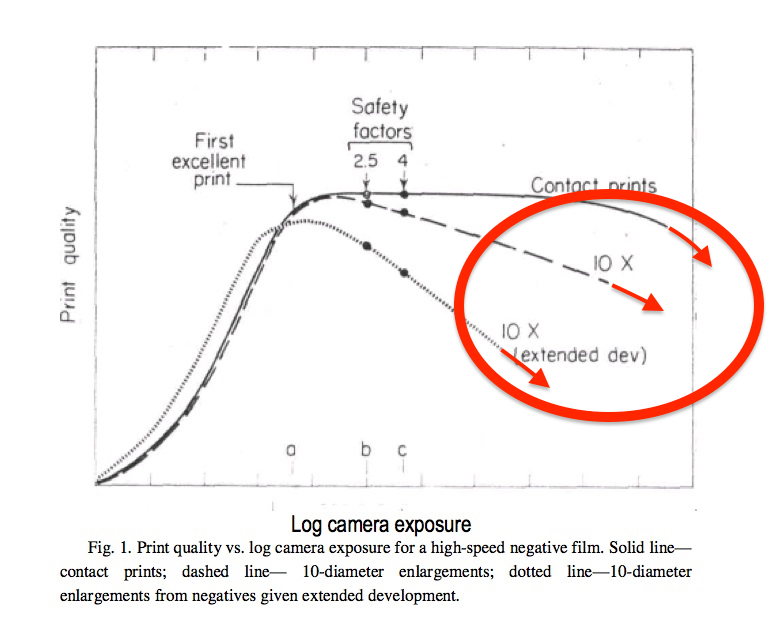

I never knew there was a second peak!
Found an answer to that. "In the region to the right of A, there is considerable disagreement among observers as to whether the general tendency is somewhat upward or somewhat downward, or possibley oscillation about horizontal line, as indicated by the solid curve. While there may be some doubt as to the exact shape of this function, there is no doubt whatever as to its general shape."
I believe this indicates there is little noticeable difference in quality beyond a certain point.
Thanks, that's likely contact prints, The other chart that show degradation for 10x enlargement is good to keep in mind. For 35mm you will want to hit close to the sweet spot.
