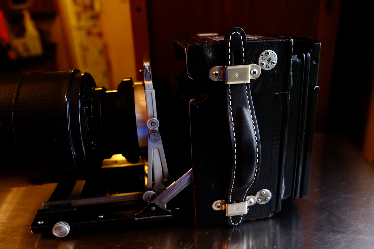

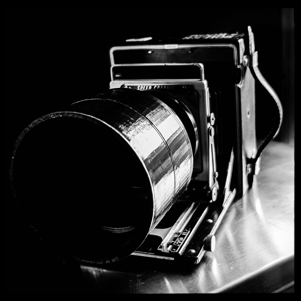

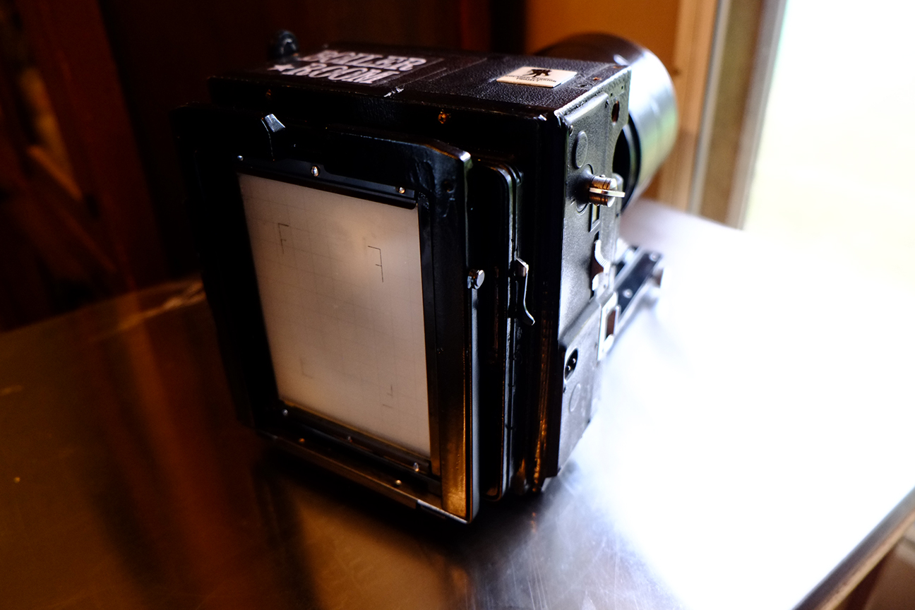

I've been making several changes to my Speed Graphic 4x5. I use the Aero Ektar lens on it almost exclusively. I've recently added a Toyo rotating back, doing the fabrications myself. Also added a leather handle that is a replacement for amps.
I picked up a cheap lens and wanted to give it a go, but am truly crashing and burning on the lensboard. Is there someone that makes these at a decent rate? The lens is a Konishiroku 21cm f/4.5. Might not even be worth the trouble, but was wanting to mess around with it.
Any thoughts?

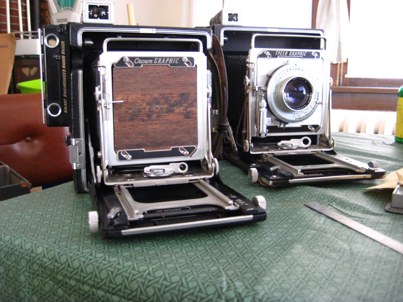

I have also seen (somewhere) a file to make boards using a 3D printer with the usual caveat about finish and light blocking, any lensboard I 3D printed would get a couple of coats of black Krylon spray paint. I have made boards for my 3x4 Graphic (a much rarer beast) that are flat and have a step on the back of the board to trap photons. The board is a piece of wood grain Formica with a backer of thin plywood. I would not hang a heavy lens from it but it's fine for lighter lenses.
