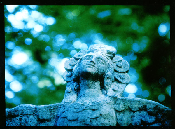

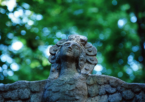

My results - e100vs / endura metallic
paper scan (not too much representative - scaner couldn't correctly scan gloss metallic, the lights are almost here in reality)
film scan
Thanks bvy for method and PE for answers.
