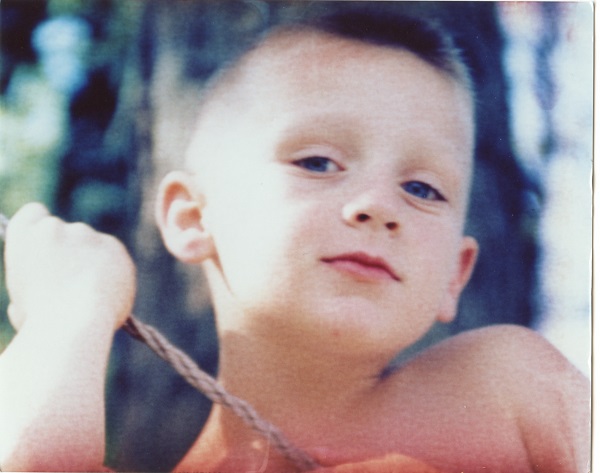

Looks beautiful. Beats doing an interneg. But since is RA4, is the contrast is lower than Cibachrom or to old Kodak R-200 process?
Contrast is extremely high, but it's possible to reduce it by adjusting the color developer (RA4 chemicals). One of the links I posted earlier this thread has a elaboration by PE.

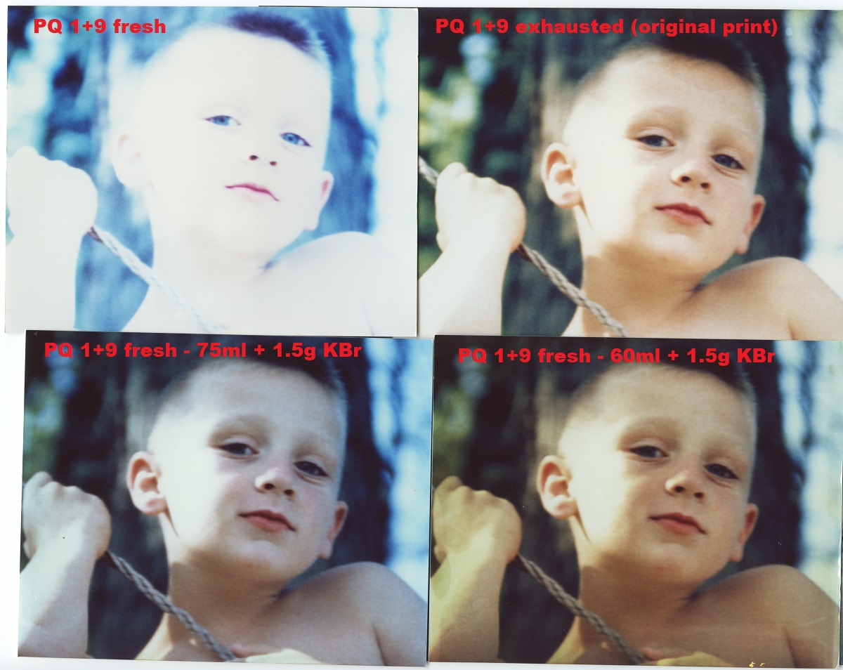

Welcome to how I spent my Sunday afternoon. Using freshly mixed PQ developer (always one shot) I did a series of test prints adding varying amounts of potassium bromide. My results are below. The original print is in the upper right. The "control" print is in the upper left, and I can reproduce this result pretty consistently using fresh PQ at 1+9. The bottom images introduce potassium bromide in the indicated amounts. I was able to get reasonably close to my original print at the 1.5+60 dilution, and I wonder if the only difference now is some exposure. I should mention, all other variables were kept the same -- in particular, filtration and exposure (35M+40Y, f/4 at 18").

This approach does seem to have a positive effect on mottling. By way of comparison, here's an older test print using fresh PQ at 1+17.5. The mottling is excessive.
Finally, pardon the uneven development in some of these. I'm processing in drums and using the minimum amount of first developer to try to economize since my supply of PQ is quickly vanishing from all this experimenting!
I am following this thread with great interest. I don't understand thw notation used in the photos for dilution and salt addtion. 1+9 - 75 ml + 1.5 gr KBr??? ml of what?? gr are per liter??
Can you clarify, bvy? Thanks in advance.
That's 60ml (or 75ml) of PQ 1+9 to which I added 1.5g of (solid) potassium bromide. I have a 1.5g measuring spoon, and it's easier to vary the amount of liquid. Sorry if I'm mixing units.
Thank you! That looks promising. Relatively small variations in the concentration of KBr apparently make quite a difference in the result ...

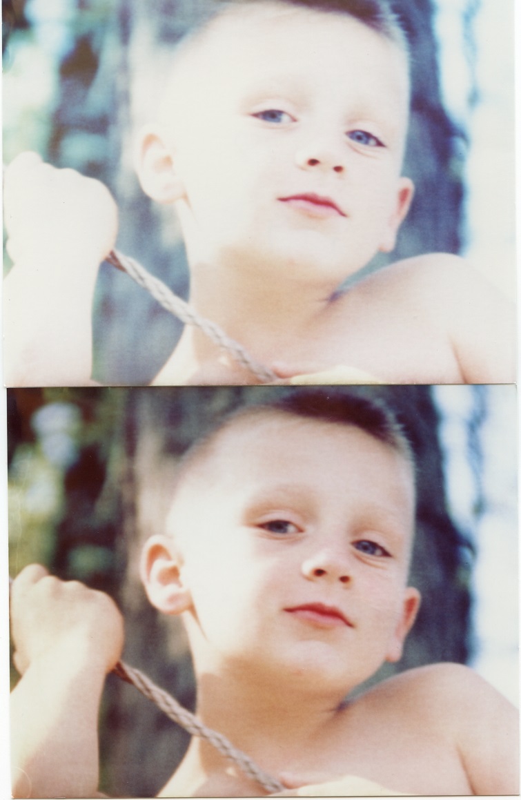

These may be my best results yet. Unfortunately it entailed burning several sheets of fresh paper to manually exhaust small amounts of developer. The top image is 60ml of developer (PQ 1+9) in which I developed two full 8x10 sheets of Ilford RC paper (so 1/30). The bottom is 72ml of developer and three sheets (1/24). The paper was fully exposed to room light and tray developed over two minutes.
The bottom image may be the sweet spot. The contrast is even better than the original shown in the first post -- there's shadow and highlight detail not visible there. The whites are just as white, not too gray or dark. And the mottling is very much under control.
