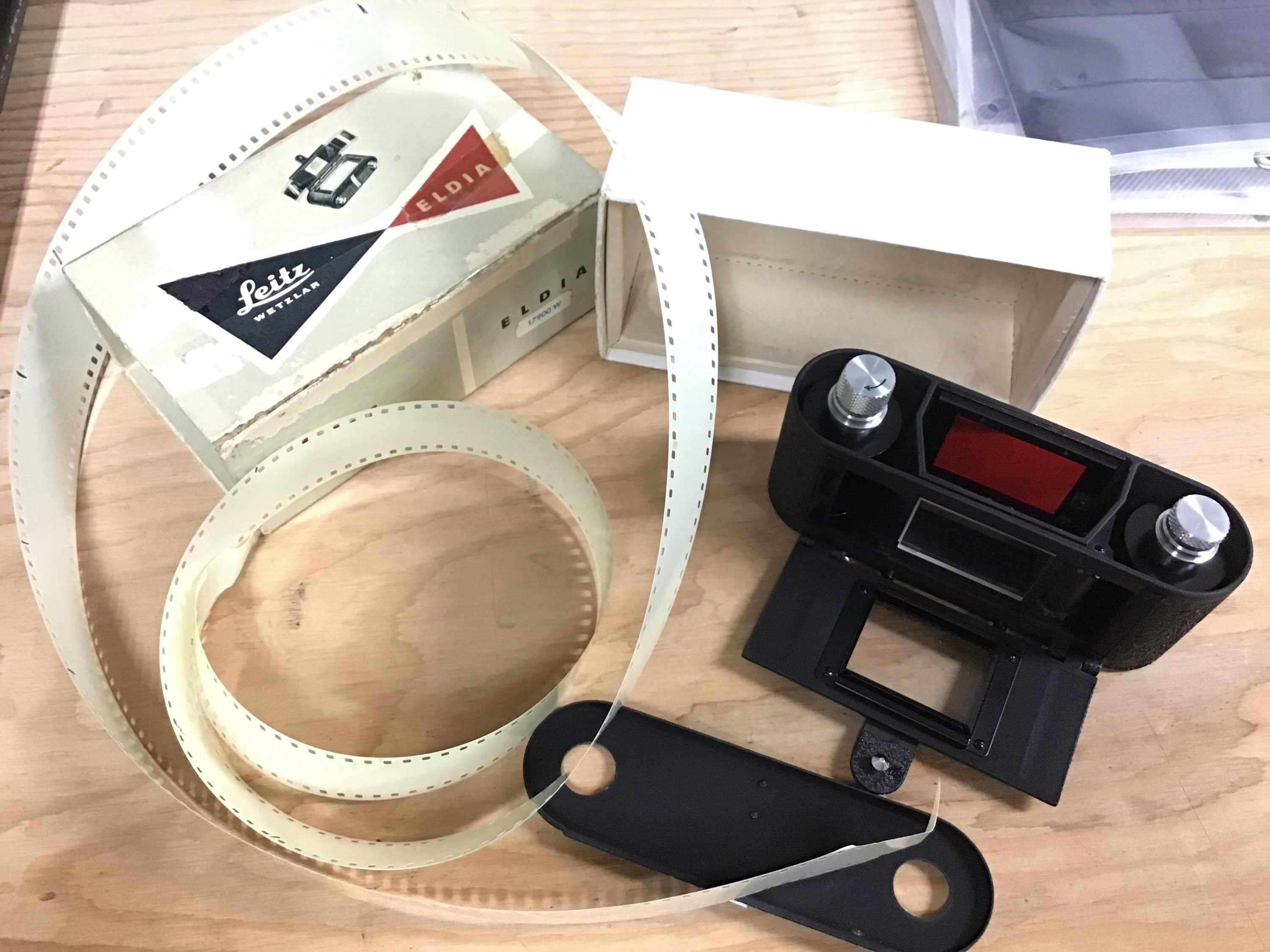

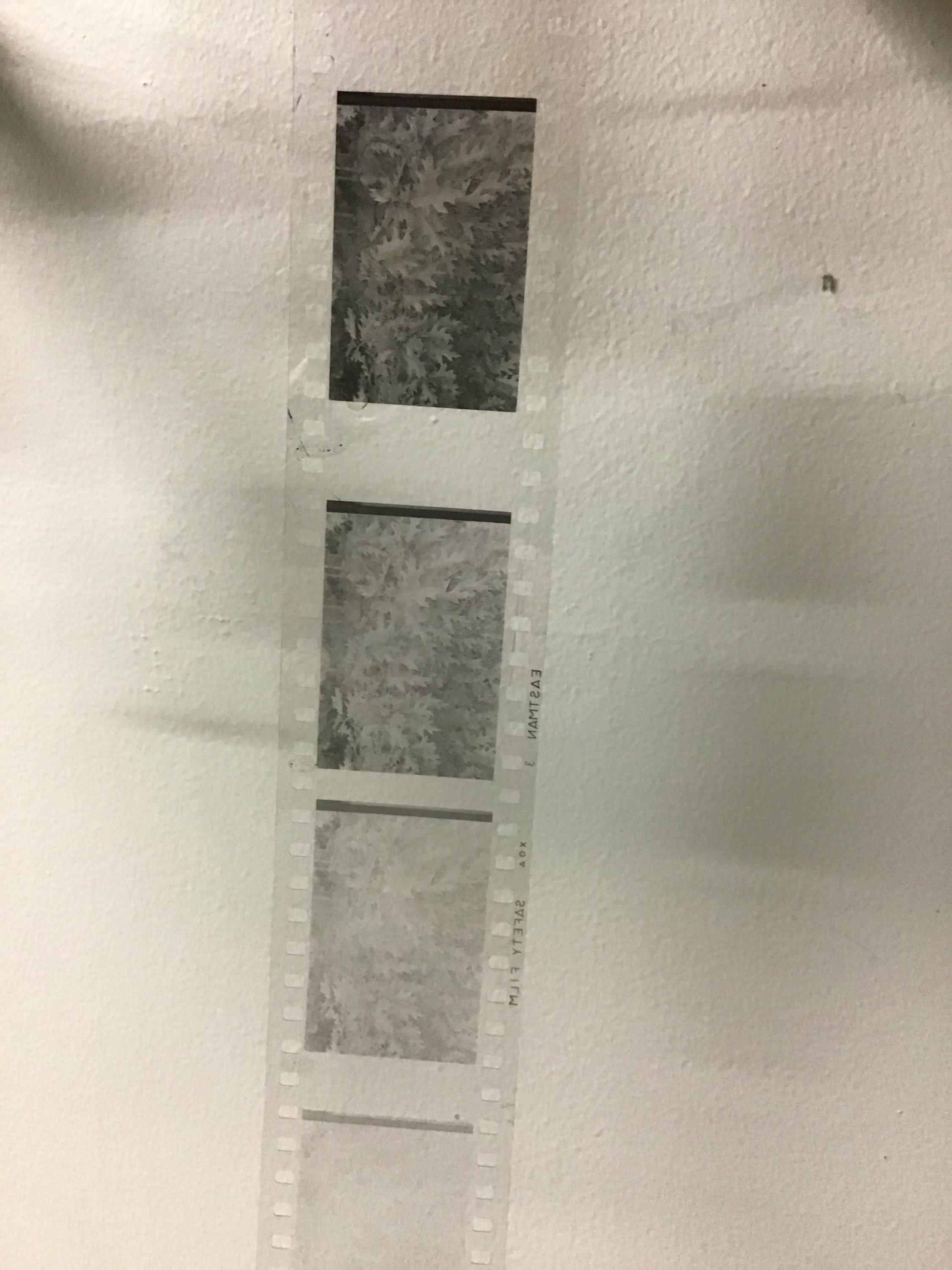

I took out the ELDIA film strip printer tonight to do some quick tests, and with 5 mins in D-97, the 5302 looks pretty dang good when contact printed on the Double-X developed in D-96.
Now I just have to do this 129,599 more times, and I have a feature film ready.
If you've never seen an ELDIA... It's like a Leica body with a transparent back. The back holds your negative, and you contact print on paper or film, emulsion-to-emulsion. Then you take out the positive, and process as usual.
