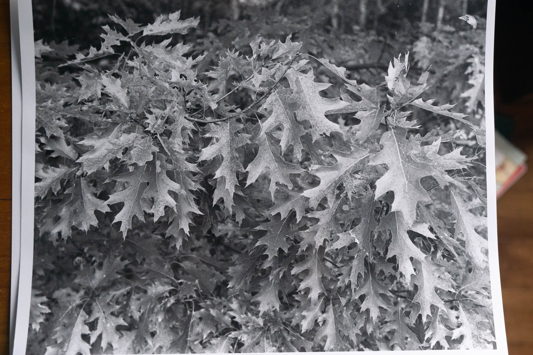

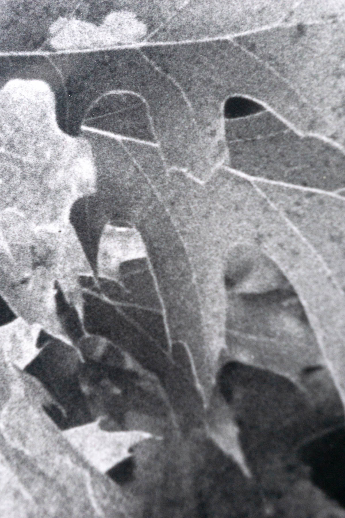

I managed to take some macro shots of the print. Same as usual, Kentmere 8x10 VC in Dektol 1+2. I used a 1.5 filter.
Double-X was developed as per Kodak's recommendations in D-96 at 21C (not 20!) for 7 mins. I agitated every 30s.
On the light table, the negative looks beautiful, aesthetically pleasing as an object in itself. I have found my stash of 5302 and I think I will mix some D-97 and print this as a 35mm slide.
On the grain side, we're still talking subtle differences. I find the grain of D-96 to be less lumpy, more uniform. I'm not sure if I can say finer. I would say D-76 is crunchy peanut butter; D-96 is smooth PB. But I can clearly imagine the impact this difference would make in projection when grain is magnified and projected at 24 fps.
In conclusion: if you shoot Double-X, get thyself a scale and mix from scratch, or get a bag from Cinestill.

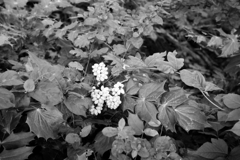

Double-X (in Df96 monobath, I've only done the one roll so far) at EI 400 gives grain that seems very similar to what Tri-X gave in the 1990s. I have five rolls of new fresh-dated Tri-X in 120, but haven't even opened the box yet. It's been my understanding, however, that Tri-X benefited along with most other Kodak still film stocks (B&W and color) from the formate doping discovery/patent, allowing double speed with the same grain (or same speed with significantly finer grain). That to say, modern Tri-X is most likely significantly finer grained that what I've got experience with. Double-X, on the other hand, is claimed to be effectively unchanged since 1959. It might well be that due to technology changes, fresh Double-X will give coarser grain at "box speed" (EI 200-250) than modern Tri-X at its box speed.
I will say this: the grain in current Double-X is very much not objectionable.
Cinestill packaged Double-X Negative, EI 400, Df96 monobath
