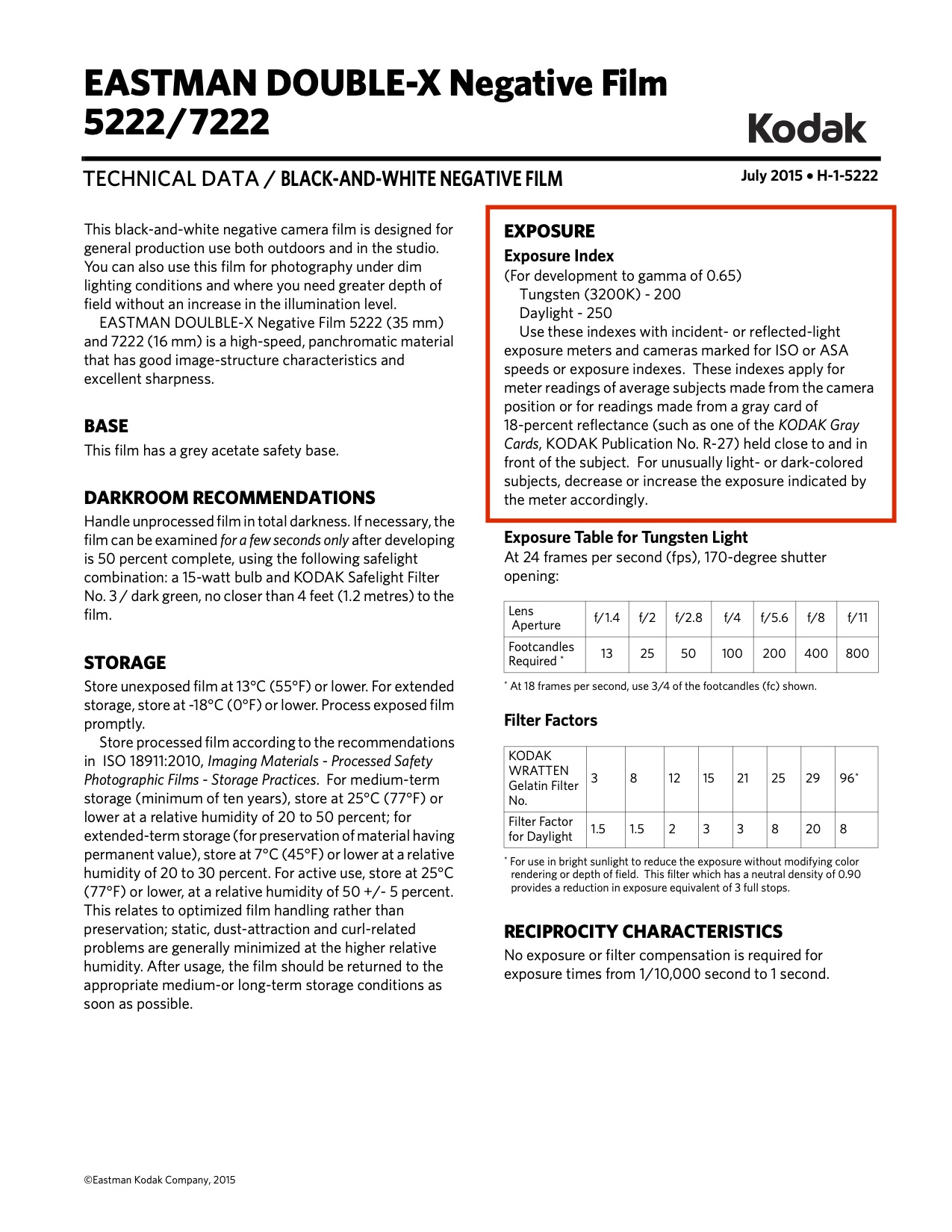

I shot at EI 200. Kodak recommends 250 in daylight and 200 in tungsten. A full sunny summer day at my latitude gave me f/11 and 1/500.

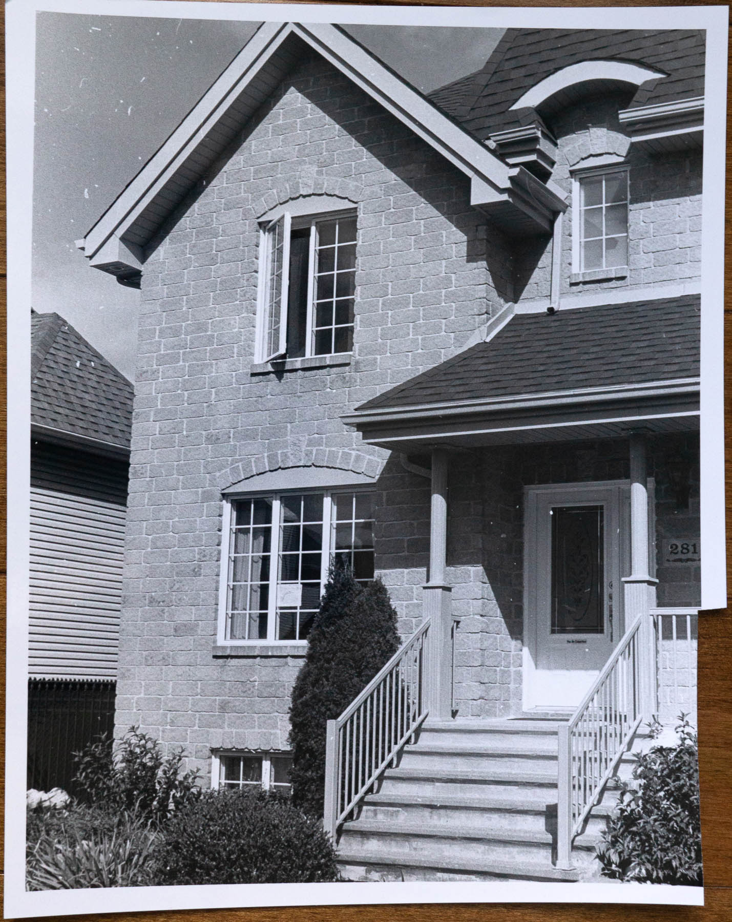

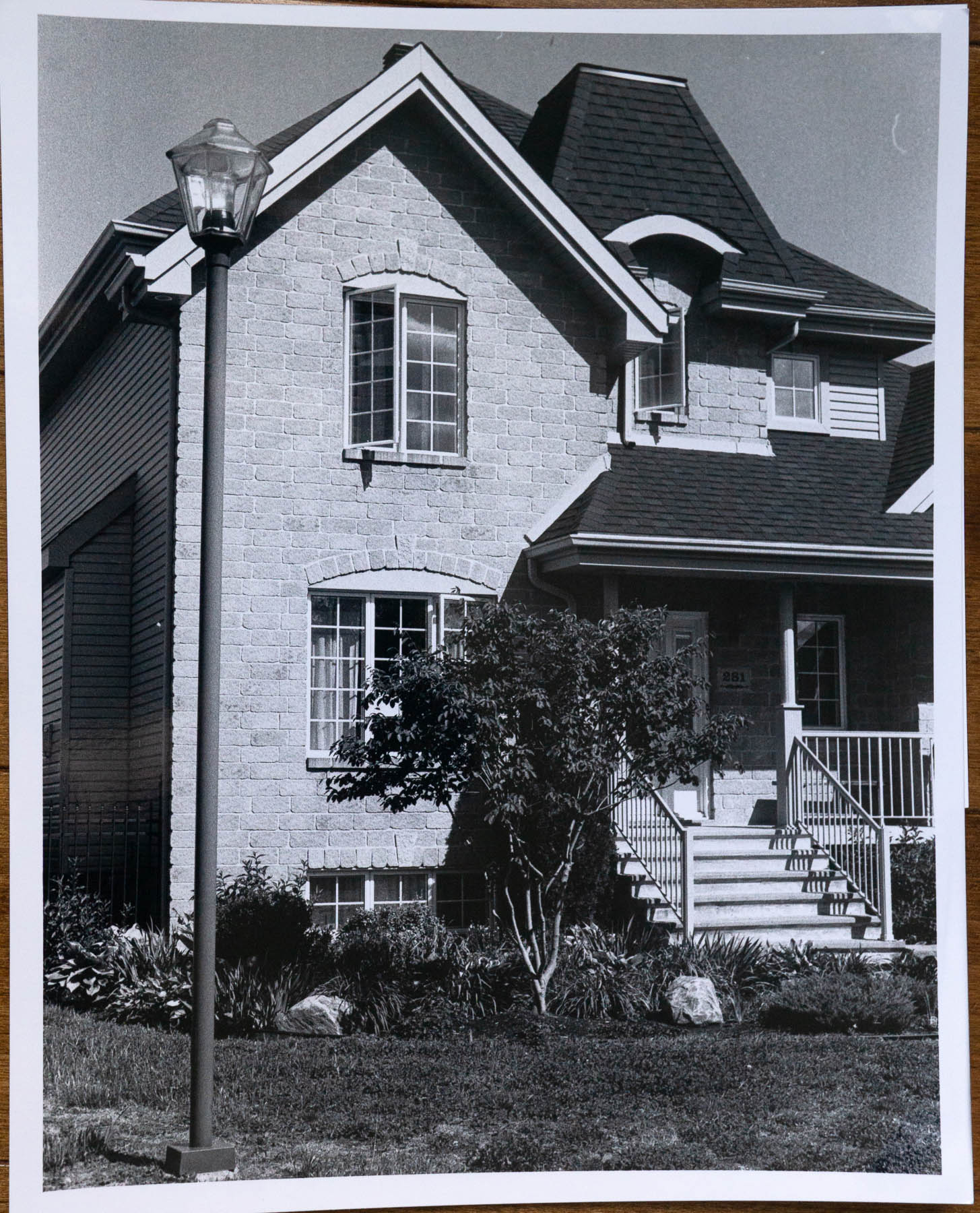

Here's the best I can do without a scanner. 8x10 prints on Kentmere RC VC. Top is Double-X, bottom is Tri-X. As I said, rather similar in this context.
EI and ISO are not the same thing. EI tends to lower then ISO then its number suggests. If the EI is 250, then ISO should be closer to 400.
That's a complete misunderstanding, or at least a very poor explanation.
ISO (like ASA and DIN film speeds) is a figure arrived at by testing methods promulgated by international standards bodies (ISO is a French name, but can be thought of as International Standards Organization). Nothing you can do to a film (other than leave it on the shelf for years) will change its ISO speed.
EI, Exposure Index, is a statement of what speed you shot (or intend to shoot) the film at; it's an adjustment to metering (and often development), not a change in film speed. "I only had ISO 400 film, but it was so bright on the beach and the light was so harsh I decided to shoot at EI 100 and give a pull -2 in processing." That statement is saying the user "overexposed" the film by two stops (allowing the harsh shadows to retain detail), but then subsequently developed to a lower Contrast Index to "pull" the highlights and mid-tones down the curve, away from the shoulder. In terms of technique and what's accomplished, a "push" or "pull" are roughly equivalent to Zone system expansion or contraction, respectively (Zone system is also heavily built around establishing an EI to use for metering scenes instead of the ISO speed).
EI does not tend to be lower than ISO -- in fact, one could argue that it's more commonly higher, because more people naively "push" their film, without really understanding what they can actually expect, than "pull" it in order to get a certain look, compensate for lighting conditions, or preserve additional shadow detail beyond what the ISO speed can.
5222's actual ISO means very little unless you plan to use it as movie film (it's intended purpose). Movie films' ISO ratings are often a bit slower than their actual speeds turn out to be when used as still films as I understand it, but I haven't done any scientific testing so I'm hardly an expert.
I usually shoot 5222 at EI 250 and develop in D-76 1:1. I've tried some other developers and speeds with decent results but this is the combination I've been happiest with.
I like the look of this film a lot. I learned to shoot with Plus-X and an older version of Tri-X and 5222 has a look that, to my eyes, is right in the same ballpark in terms of tonality. I also appreciate its wide exposure latitude.
It's a good, solid, old-technology film that, if bought in bulk, is quite economical to use. What's not to like?
Dude, seriously.
You don't "rate" a film at an "ISO." The ISO just is a standardized measure. The EI is your empirical measure. Kodak recommends that your EI should be around these values.

Michel, thanks for the two pics which were good examples of the differences between the films. What struck me from the comparison of the two pics was that the Double X 5222 looked more substantial. On first glance it seemed to give the better look to me but on close examination the Tri-X gave more shades of grey so more shadow detail but looked somehow blander because of this. If I was wandering around an exhibition of pics I'd be drawn to the double X one first which indicates that higher contrast with apparently deeper "colours" is more appealing initially. Difficult to say which pic would be favourite after say several weeks on my wall
It may be that when newcomers to film photography ask about how to replicate "old days" photos it is as simple as preferring high contrast to more tones in the mid to lower zones.

Ok. I stand corrected. Only thing is when using 5222 as a still film, the camera wants to know an ISO for the meter. There is no EI setting on the camera. This is where Im having trouble, especially since I have no control myself over the developing stage.
The settings on a camera are just that - light sensitivity settings. They are often labeled ISO, but that is really just to make it easier for people who just set the camera for the number on the film box.
You choose which exposure index (EI) to use - the manufacturer's specified ISO setting, or another setting that works better for you.
As motion picture film has an ISO light sensitivity rating that is related to use as a motion picture film, not a still film, you need to choose an EI that works well for you.
It is actually simpler for you if you are having your film developed by a reliable and consistent lab like The Lab, because the variables are limited to your meter, your metering technique and your desired contrast.
You don’t have to be confused about this
ISO as marked on the camera is just a mark on the camera telling you where the film speed goes - the number that you dial in for any particular film would be ISO if you use the number on the box or the number you dial in will be EI (exposure index) if you choose to dial in a different number than the one on the box.
Like if you sometimes push an ISO 400 film to EI 800. Or what I do is set the meter to EI 250 for the same film because I like rich negatives. I know the ISO is 400 but I want to get a certain result so I use a different EI
Yes, my reaction was somewhat similar; however both films do not print on the same grade of paper, so the "blander" look of Tri-X might be a function of the neg+grade combo. I'm not a bad printer, but by no means a pro.
That said, I still think Double-X is a worthy object of experimentation for fans of Tri-X. It's easy to use, and has a distinct personality.

I'd endorse your last sentence about Double-X. Just out of curiosity what were the respective grades used for the Double-X and Tri-X prints.
What would be interesting but costly in time and paper is as series of prints from both negs at say grades 1-4 to see if there are two different grades that give close to identical prints. I have no reason to say this except for a "feeling" but it may be as you say that the differences between the two films are there per se and cannot be made indistinguishable by grading
From what I have seen I feel that I can rule out any problems with your printing skills
You've missed another variable that would need to be controlled: negative contrast. If your Double-X is developed to a higher CI or gamma than your Tri-X sample, all you'd wind up doing is verifying that higher negative contrast will require lower paper contrast to compensate.
So, you start with sensitometry testing, to get development times for both films that give the same gamma (I'd use that instead of CI, because it norms out differences in curve shape a bit more); THEN you make a series of prints from each at best exposure from grades 1-4. Wouldn't be too terrible in terms of paper -- use half sheet of 8x10 for the prints, you'd need a test strip for each grade to get your exposure right, at worst (some filter set and paper combinations will hold constant exposure over that range) -- the whole project would take no more than ten full sheets, plus a roll or so of each film for the sensitometry, and one of each for the test negatives.
Sounds like a project for a week's vacation time.
I used 0.5 for Double-X and 1.5 for Tri-X. My paper is Kentmere RC VC, so the grades on another paper, let's say Ilford, would be slightly different.
You've missed another variable that would need to be controlled: negative contrast. [SNIP]
Anybody wants to lend me their $1,000 X-Rite densitometer, and I'll clear my schedule. :wink:
