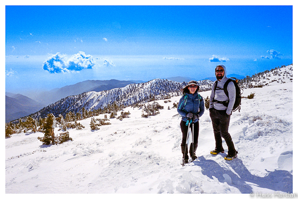

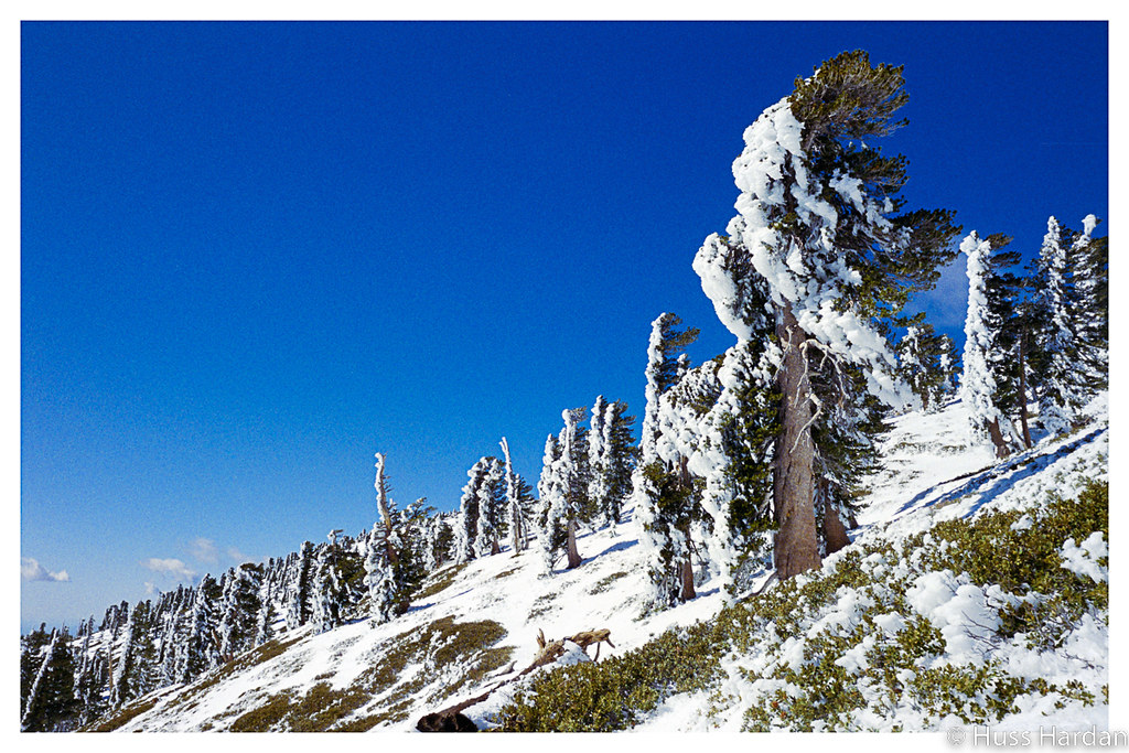

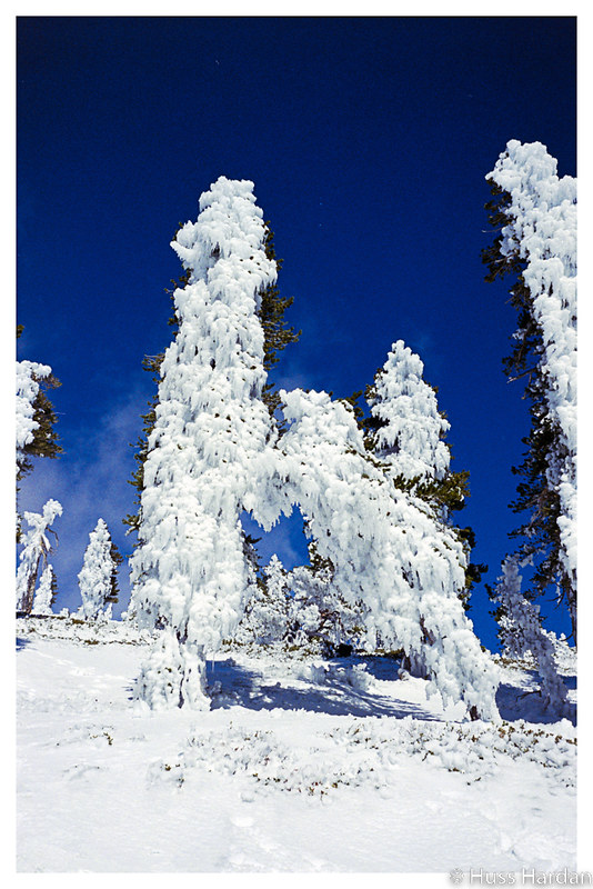

I just climbed Mt Baldy two weeks ago, which is one of the tallest mountains in southern california. Lots of snow and bright sunshine. I just dialed in an extra 1.5 stops exposure on my Fuji Klasse W.
Don’t over think it.
Those are some beautiful images!
Great images! It's been over a half century since I stood on top of Mt Baldy...late 60s.
