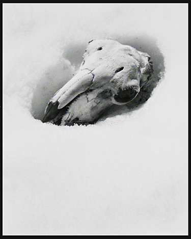

Some good advice all around. This image was found while wandering around in the snow in the upper Mono Lake basin a bit snow-blind -- I ended up with the darkcloth over my head, peering thru a slit. Almost stepped on the skull -- I had to get at least this close to exclude my bootprint.
Pentax Digital Spot readings: snow 18, skull in sun 17, darkest on skull 14. Given one extra stop exposure for bellows extention (as insurance, and certainly did not hurt). So exposed at 16 plus 100% for bellows (f64 @ 1/4 sec), 150mm lens, TMax100. Developed normally in HC-110.
The photo is a decent reproduction of the 16x20 print (from 4x5 negative, 1991) printed on Grade 3 Ilford Gallerie.

Thanks, Greg. Has the 'what' question been answered yet? (metering for transparency film vs B&W neg would require different approaches).
But my example does show that sunlit snow scenes are not necessarily high contrast, and minus development is not a given.
