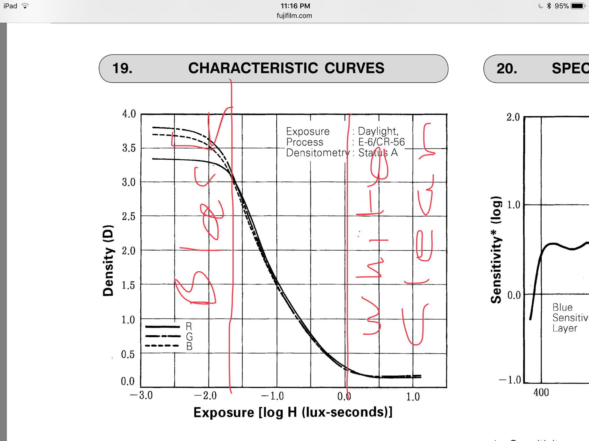

Okay Les Sarile, here's the curve for Velvia. Direct from Fuji's mouth so to speak. http://www.fujifilm.com/products/professional_films/pdf/velvia_50_datasheet.pdf
The vertical lines I've drawn show roughly the range of usable exposure from the scene. One log equals 3 stops. The difference between my lines is about 1-2/3 log, or 5 stops.
The RGB lines diverge radically to the left of the "black' line. A divergence like that means a highly skewed color rendition compared with the rest of the photo where the RGB lines track together. This color relationship is at normal development. Changing development (push/pull) also skews the way the colors track so color shifts naturally follow development changes.
Thanks for that but I am already familiar with that datasheet and all the others for films that I have used.
