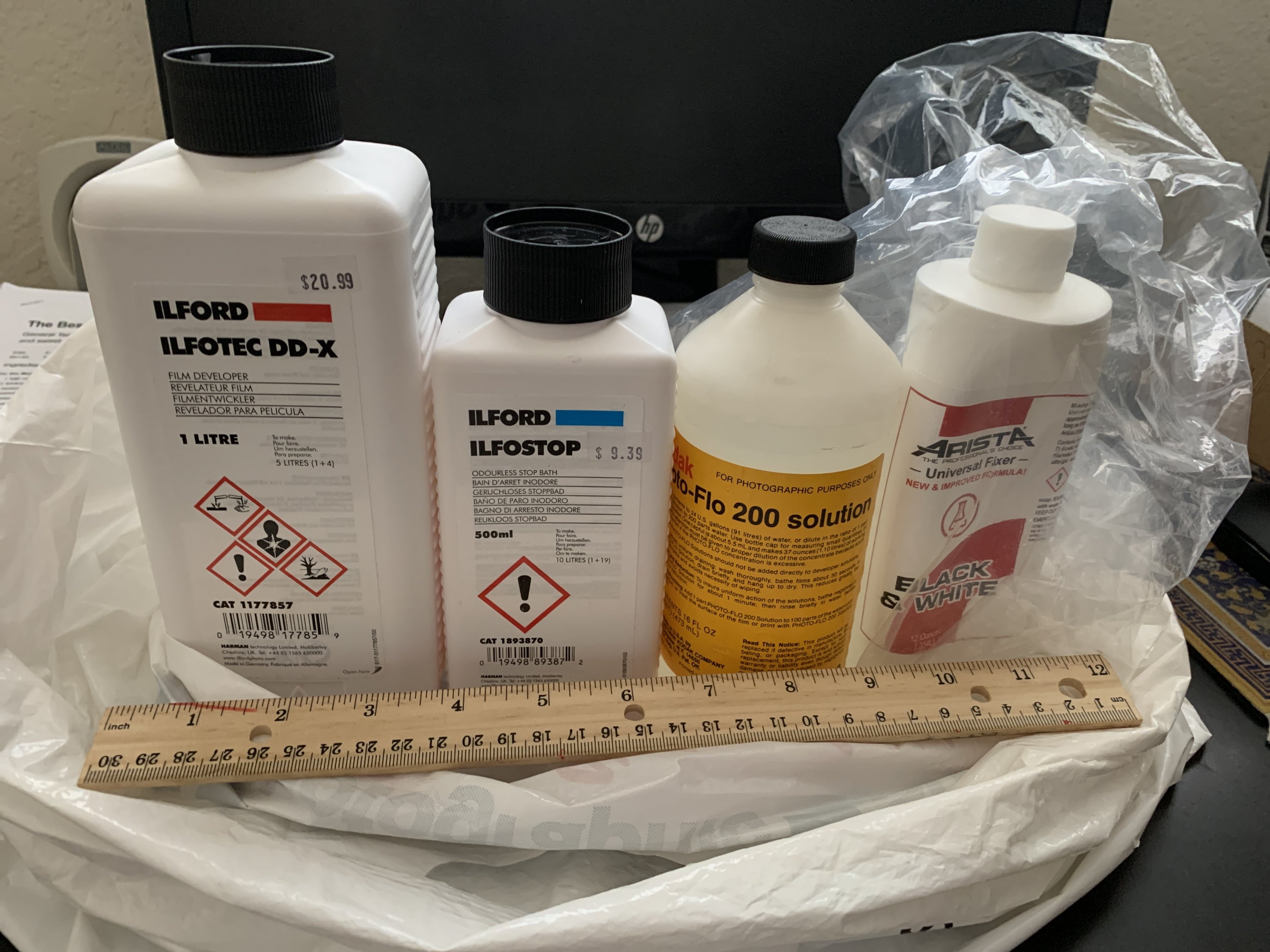

Do you have room for two one litre bottles of re-usable working solution - one for developer and one for fixer?
Plus another two one litre bottles - one for concentrated liquid developer, the other for concentrated rapid fixer?
And a small bottle of rinse aid?
That combination will give you lots of capacity, and excellent economy.
Three developer bottles at most, including the rinse aid + photoflow and a gallon jug of water.

Why not consider a liquid developer that easily mixes into a one-shot... like DD-X? Fixer mixed as one-shot too. Very little to store and very easy to use.
