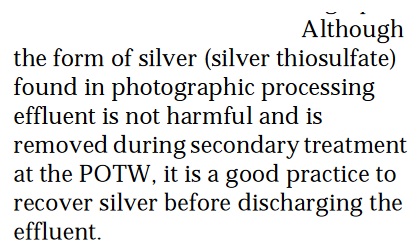

includes the following:
For those wondering if the silver was harmful - which is not the same as saying you should dump anything anywhere,

Also, landfills are not the same as they were 50 years ago. They are now lined with very heavy mil liners to prevent seepage in to ground water tables and streams. I'm not saying this is a perfect solution or to not take all precautions, but at least it's not like walking out the back door and dumping your chemicals. The newer landfills are pretty well regulated now and sure seem a lot better than putting all the waste, good and bad, on a barge and dumping them into the ocean. Also, many cities and county municipalities have hazardous waste drop off sites. Don't ask me where it goes from there as I don't know for sure. Maybe a high-temp incinerator? I have a soft spot for Xtol, but do use Pyrocat-HDC from time to time. Shame on me. Oh well at least I don't use it 100% of the time. JohnW
