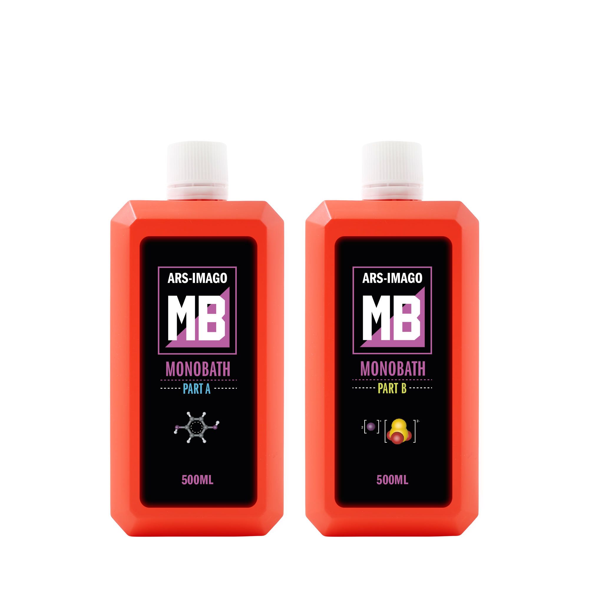

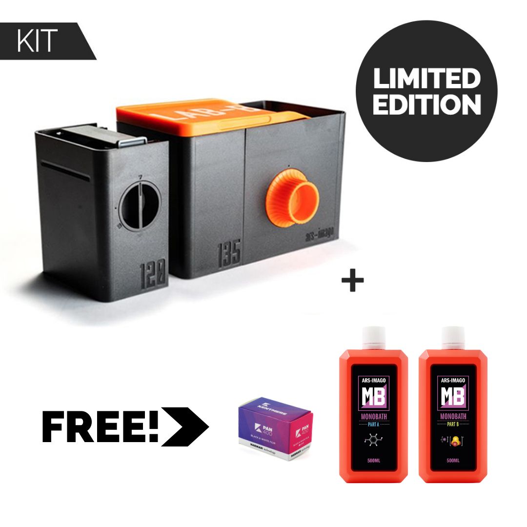

To my personal opinion, I have the impression that ARS-MAGO from Italy can be a solution to your situation.
They have a monobath film developing kit, and a very handy daylight tank system too.
See the images I found on their website: www.ars-imago.com (I am not affiliated to them, nor am I payed by them).
Freestyle, a Photrio partner, is selling these.
Very interesting! TFS.
I see that their monobath comes in two bottle of 500ml each and not in a single bottle. However, their datasheet says that once mixed, the working solution remains active for two months and can be reused to process 15 rolls. So if OP premixes the working solution at home, he can carry just the working solution in a small bottle and bring back the exhausted solution in the same bottle with him for safe disposal.
This makes it essentially the same as Df96, though it might well produce a different H-D curve, grain structure, or "look". Df-96, as sold in liquid form, comes pre-mixed in a bottle that can be used for storage while using it, and then to store the spent monobath after it's used up. The Imago product comes in two smaller bottles, making it sensible for the OP to mix before leaving town so as to carry only the single working solution bottle.
Interestingly, Bellini also has a similar product. So several monobath options are available to OP. And this Bellini monobath apparently has a shelf-life of six months after opening if stored in full bottle.
