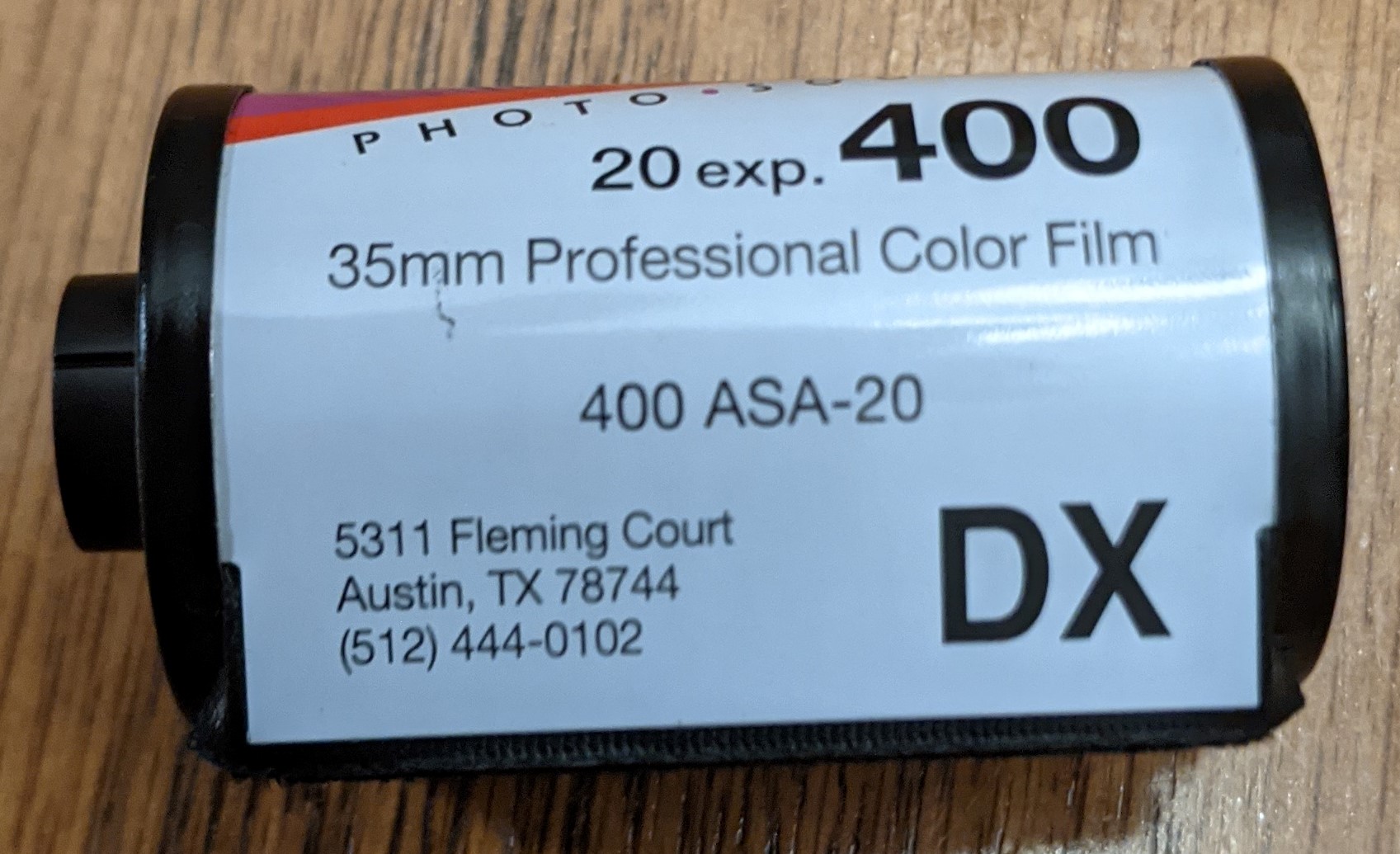

Signature Color film- so it's an ECN II process?

Here's my thought- maybe the 400 speed films are made by someone else, as my 100 and 200 rolls clearly said made in italy, finished in america.
I'd still reccomend sending it to a lab that does ecnII stills just to be safe

The omission of any process code may just mean that their marketing was to sell plain C-41 film but still warrant the reflux of all films to their own lab, as was done with the ECN films converted to 135 in the past.
You got a good result from your films. In my opinion, as someone who does all films in ECN-2, c41 is a better process for these crappy old color films. For some inane reason, the old seattlefilmworks film would completely come out blank, and the newer kind was still thin after 8min in 130F developer. I have amazing results with older kodak color films though, I think they hold up better than fuji / other.
My Thoughts exactly... And with the disaster that awaits if one runs rem-jet film in C-41 - only a few finishers would be willing to accept anything indicating a "special Process. the Dregs of the Seattle film works was c-41. I even sent a few rolls in with the label removed (some had a paper label, and some had a painted cassette if I remember correctly) EARY seatle was MP film.
What do you mean by "the dregs"? The "later versions"?
https://bluemooncamera.com/
https://oldschoolphotolab.com/
https://www.boutiquefilmlab.com/
https://www.thecamerashop.com/imagecenter/seattle.html
Those labs cross-process the films in C41 chemicals, the only two labs in the US I found that process ecn-2 film in ecn-2 chemicals are Andrew's Analog Service (here: https://www.needfilmdeveloped.com/the-lab/p/ecn-ii) and Bellow Film Lab (here: https://www.bellowsfilmlab.com/product/ecn-2-35mm/9?cp=true&sa=false&sbp=false&q=false&category_id=9), cheaper too.
Anyway, If you have 35mm still film that says made in Italy and finished in USA, you can depend that it was made by 3M, (or later IMATION) and has NOTHING to do with Motion Picture film.

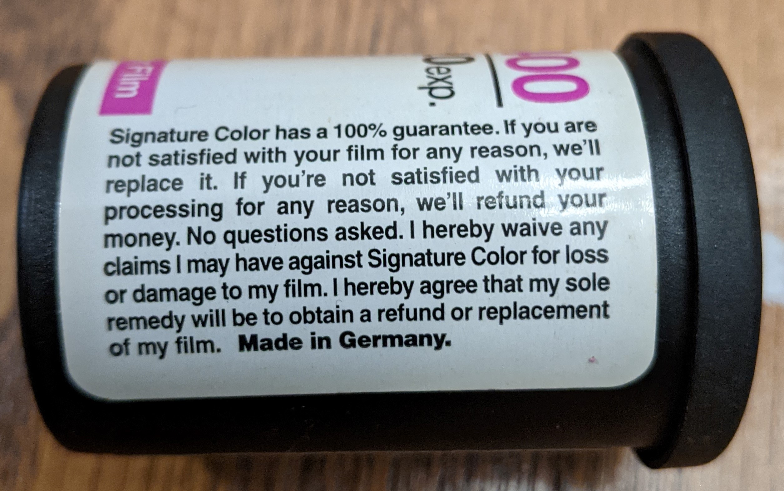

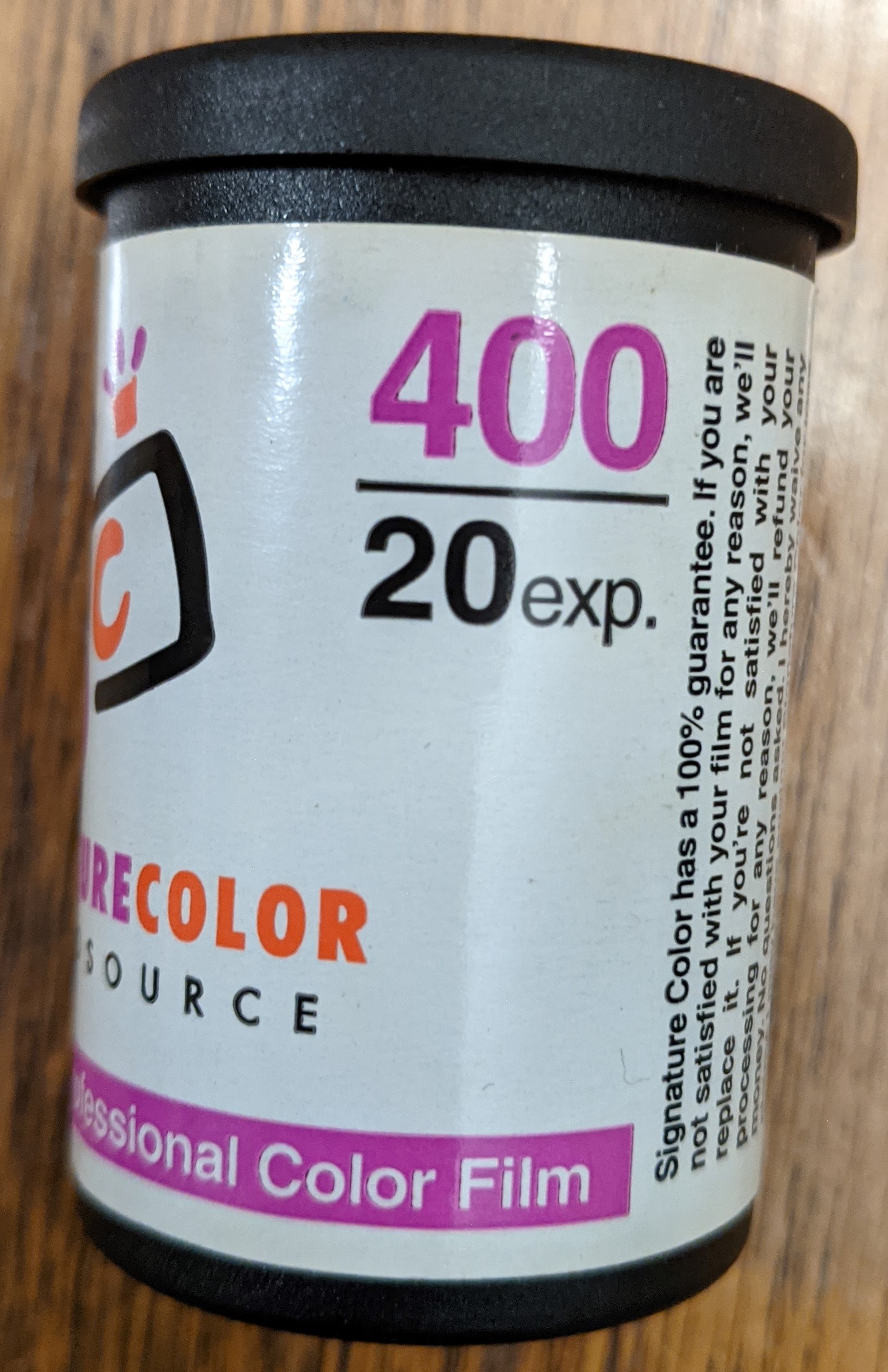

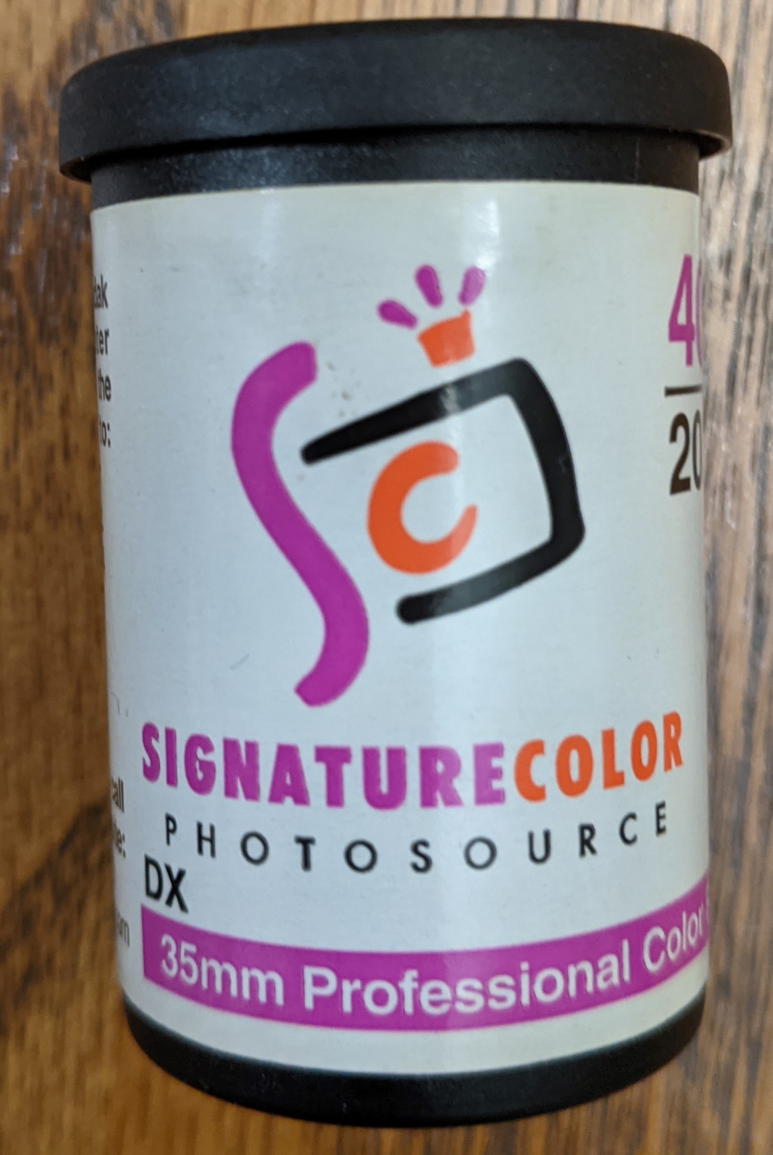

Can someone help me to find a lab where I can process a Signature Color film? It was used in the beginning of 2000s and was never developed. It would be a shame to through the memories out. At the nearest processing center I was told a lab that could process that film does not exist anymore coz none of them have required chemicals. Perhaps someone here knows such place
Welcome to Apug!
There likely are meanwhile some photo labs that accept short strips of cine camera-films (what Signature Color Film is) as recently people started buying such by purpose.
Concerning a processing lab in the USA that state to process your film, "Rocky Mountain Film Lab" comes to my mind. But be sure to search for them at this forum before.
But there also are small kits for making respective processing baths for home-processing such films. You may consider this route.
Welcome to Apug!
There likely are meanwhile some photo labs that accept short strips of cine camera-films as recently people started buying such by purpose.
Concerning a processing lab in the USA that state to process your film, "Rocky Mountain Film" comes to my mind. But be sure to search for them at this forum before.
Thank you for a great reply! Unfortunately I can't develop anything at home. I read about Rocky Mountain Film, you are right, they are completely no good. While reading I came across Seattle Filmworks lab, their order sheet names Signature Color film as one of the films they process. What do you think of that lab?
'35mm Film Size. Process: ECN-II or SFW-XL. Applicable Films: Seattle Filmworks; Signature Color; Eastman 5247 or 5294; Kodak Vision 2 or Vision 3 500T / 5218 or 7218.'​
Welcome to Photrio.
I don't think that Seattle Filmworks exist any more.
Fortunately, ECN-2 isn't the "great mystery process" that it was to most folks in the still photography world in the 1980s.
The real problem, of course, is differentiating between the ECN-2 Seattle Filmworks films and the small amount of C-41 Seattle Filmworks films.
As I recall, cassettes were marked correctly (been a long time since I saw any SFW film of either type, though). Simple test -- clip a short piece off the leader, soak in alkaline solution, and look for remjet coming off.
www.thecamerashop.com in St Cloud Minnesota lists Seattle filmworks as well as signature on their image center page
Thank you very much, Dwight! I looked them up - on their website page they do mention Signature under the tub C. Identifying ECN-II Film :
I called them to confirm and was told they do process Signature Color films if these films have 20 (what that 20 means I have no idea, she named it but it flew right over my head) and than she added 'which most of these films are'. Now I am worried what if my film is not from than category.. Also, this Signature film is mentioned under the Seattle Filmwork header, and I am wondering if they do not specialize on processing Signature Color. My film is more than 20 yo and I would like to make the most of it if possible, which means they should apply the most appropriate chemicals to process it. Can you please let me know what do you think of this?
