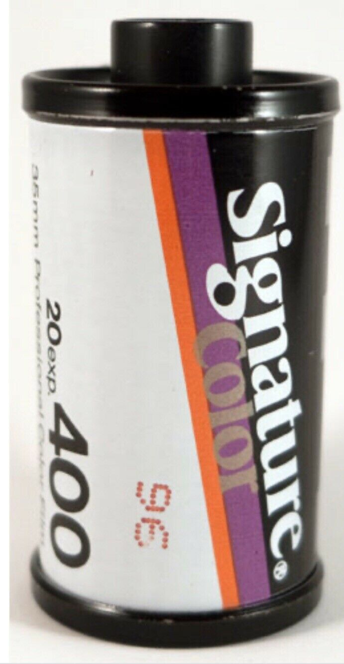

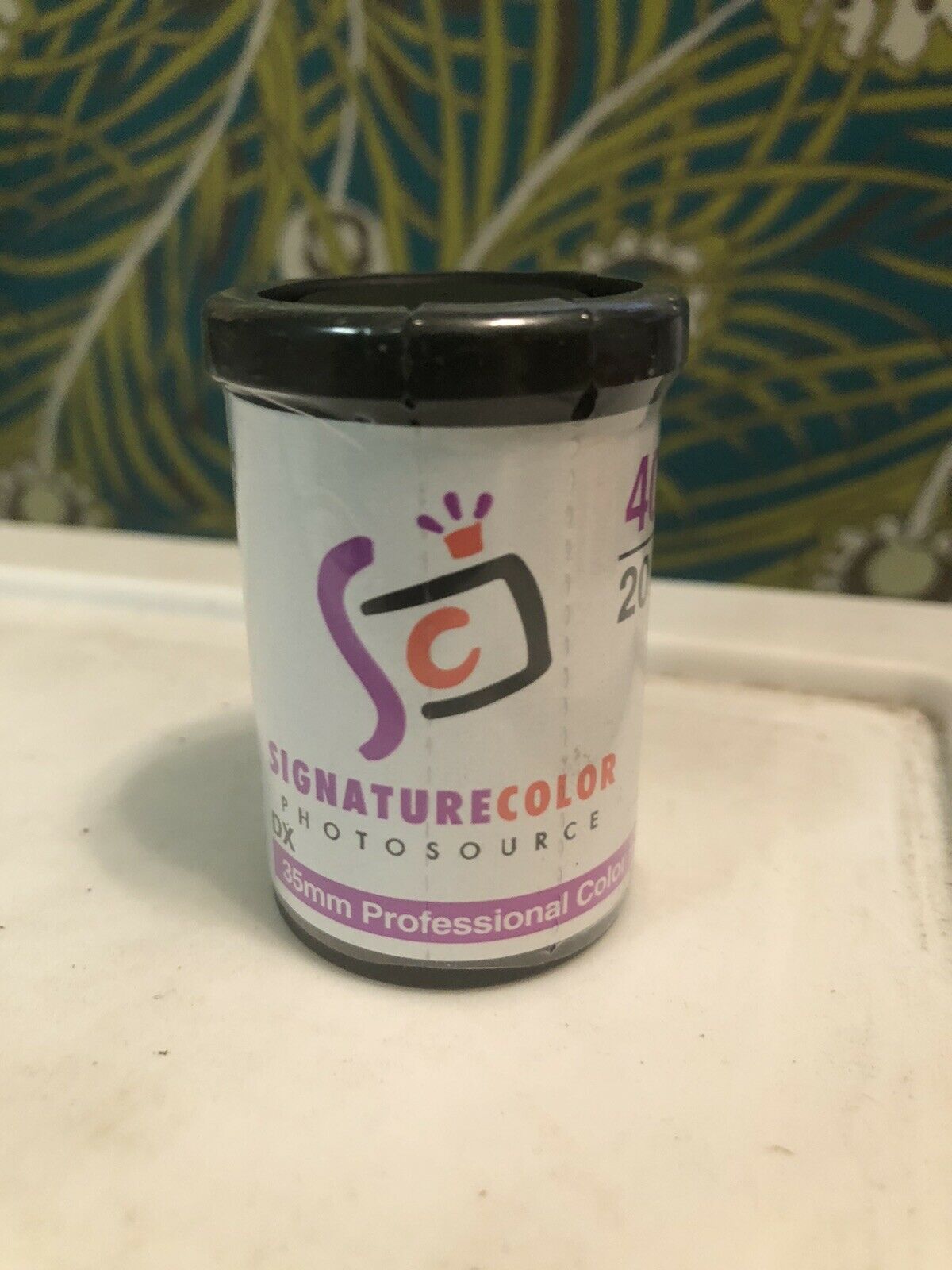

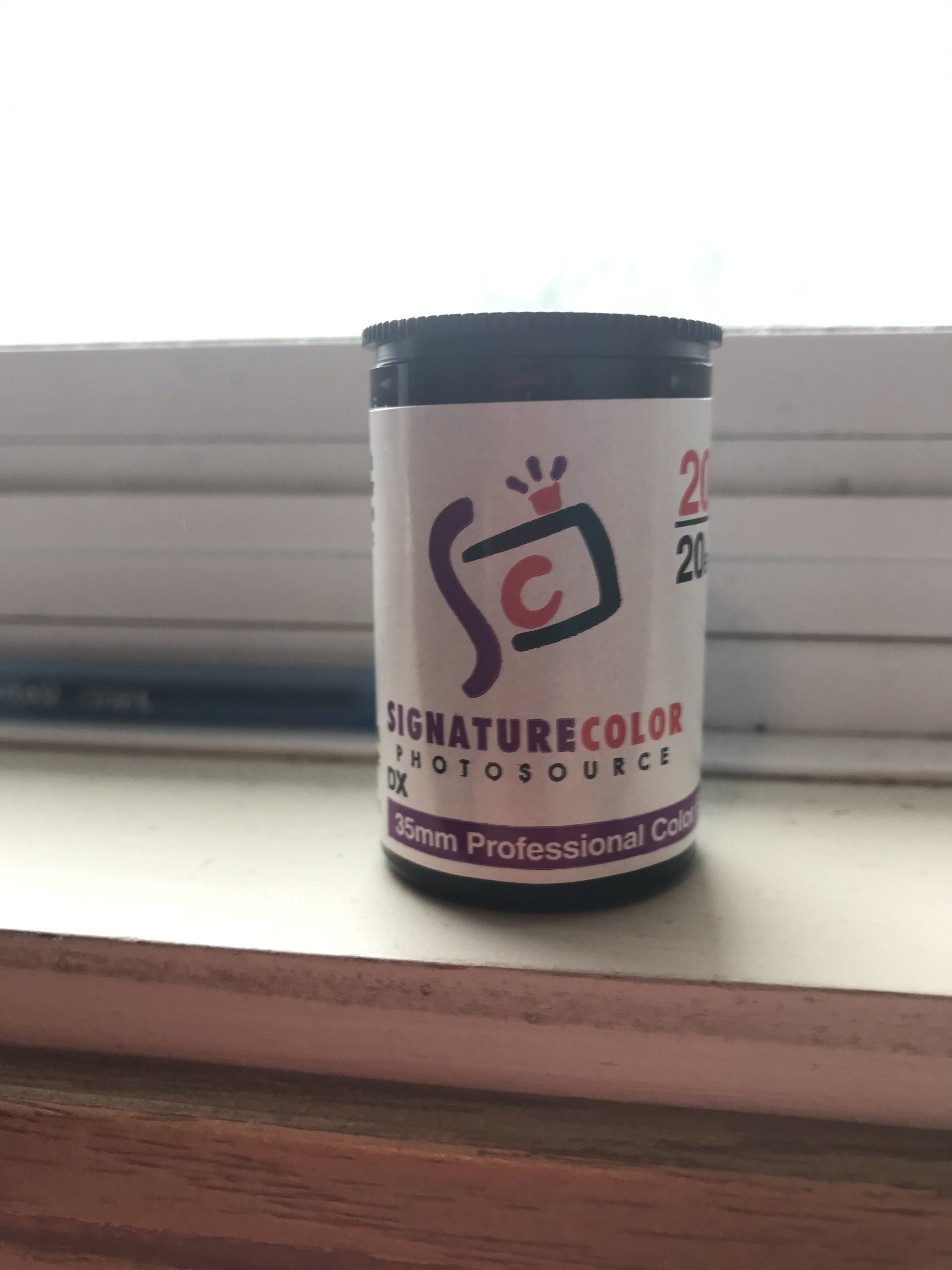

So I've got two signature color 20 ex. rolls I plan on shooting this summer, but upon a little research, it appears that they are actually recanned Cine films like Seattlefilmworks? (except this is Ferrania cine film). Just want to confirm before I unwittingly dump this on my camera store and mess up their V30.
Second, can anyone estimate an age on these films? neither canister is dated, and there isn't much information online.
Finally... anyone know any interesting anecdotes about the film?
can you show us the package, and such, also if possible the back side of the film. 3M Ferrania did not make many Cine films after 3M took over, except for film for making prints. AGFA, Fiji and Kodak Cine Negative generally have a removable anti halo layer which indeed will fowl a regular processing machine.
BTW, Seatle film works did start with Movie negative, but latter repacked a C41 film in their brand cassettes, counting on the user to be unable to get any lab to touch the film in case it was ECN or ECN2

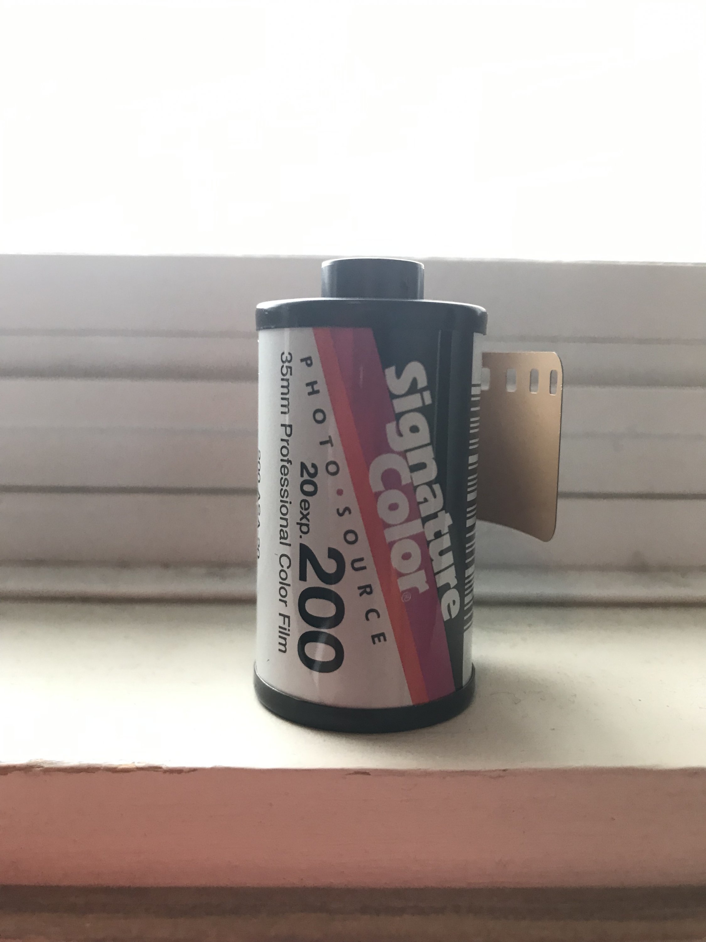

it's too dark for me to get a quality image of my films, but I can put up some similar ebay listing images, except I have a 200 and a 100.

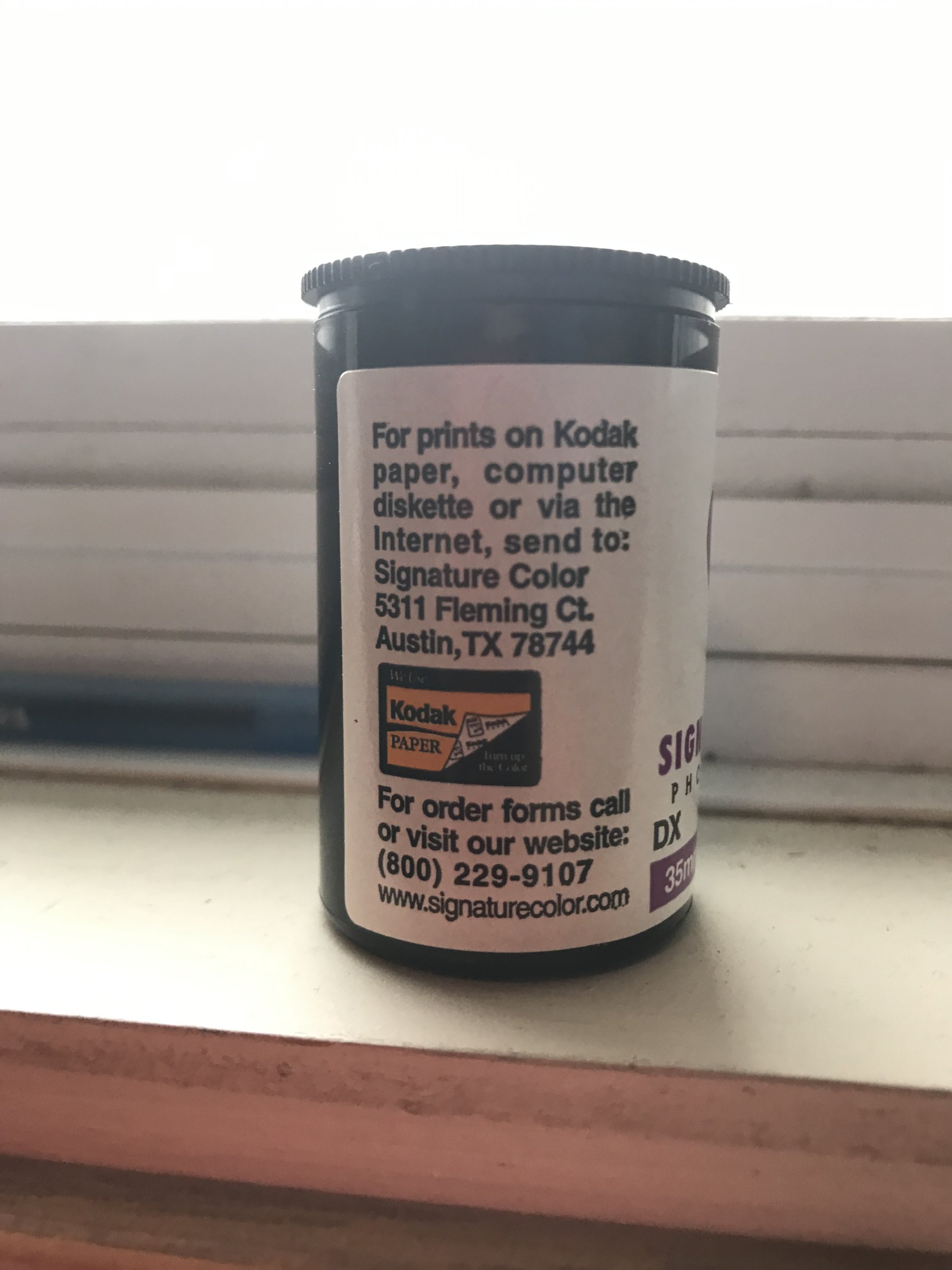

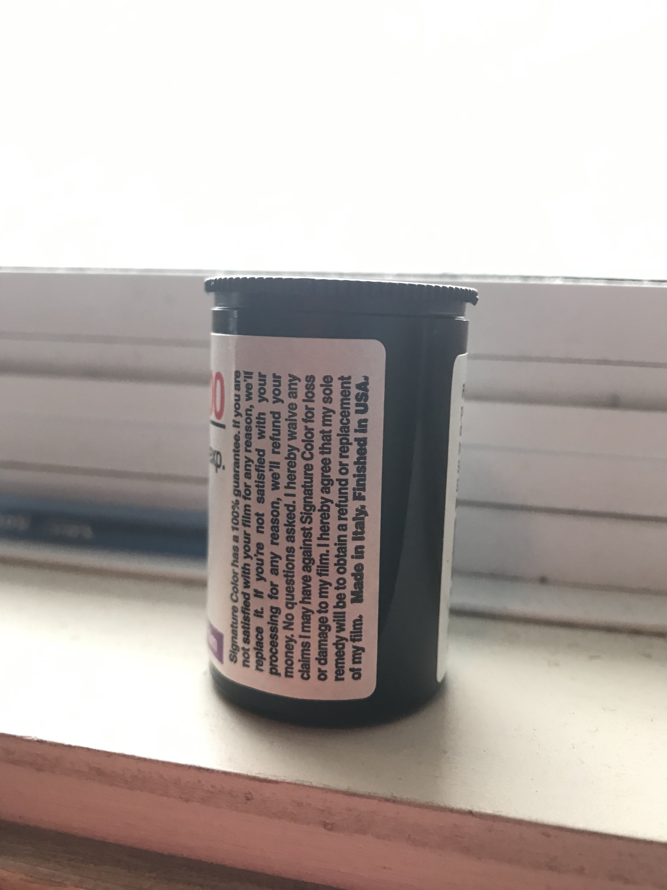

there's no process listed on the canister of cassette, however it does say made in italy, finished in america.
when it's not raining, I can get some images of my films.
You could try cutting off a small piece of the leader and scrubbing it to see if any black material washes off.
Also, look at the film canister itself - this is where processing information is usually printed.

The canister says nothing. Some ecn II still labs do list signature as one such film.
https://www.thecamerashop.com/imagecenter/seattle.html
though the film physically looks like standard c41 film (I may try soaking a small bit later tonight)
If the film isn't black on the back side, it doesn't have remjet. There are ECN-2 films that don't -- duplicating and print films, for the most part. Often those don't have the orange mask, either, and will not print correctly in old standard "One Hour" processes (though they scan fine as long as the scanner has a correct film profile).
For your soak test, be sure the bath is alkaline; I understand the alkalinity is necessary to release the remjet, if present.

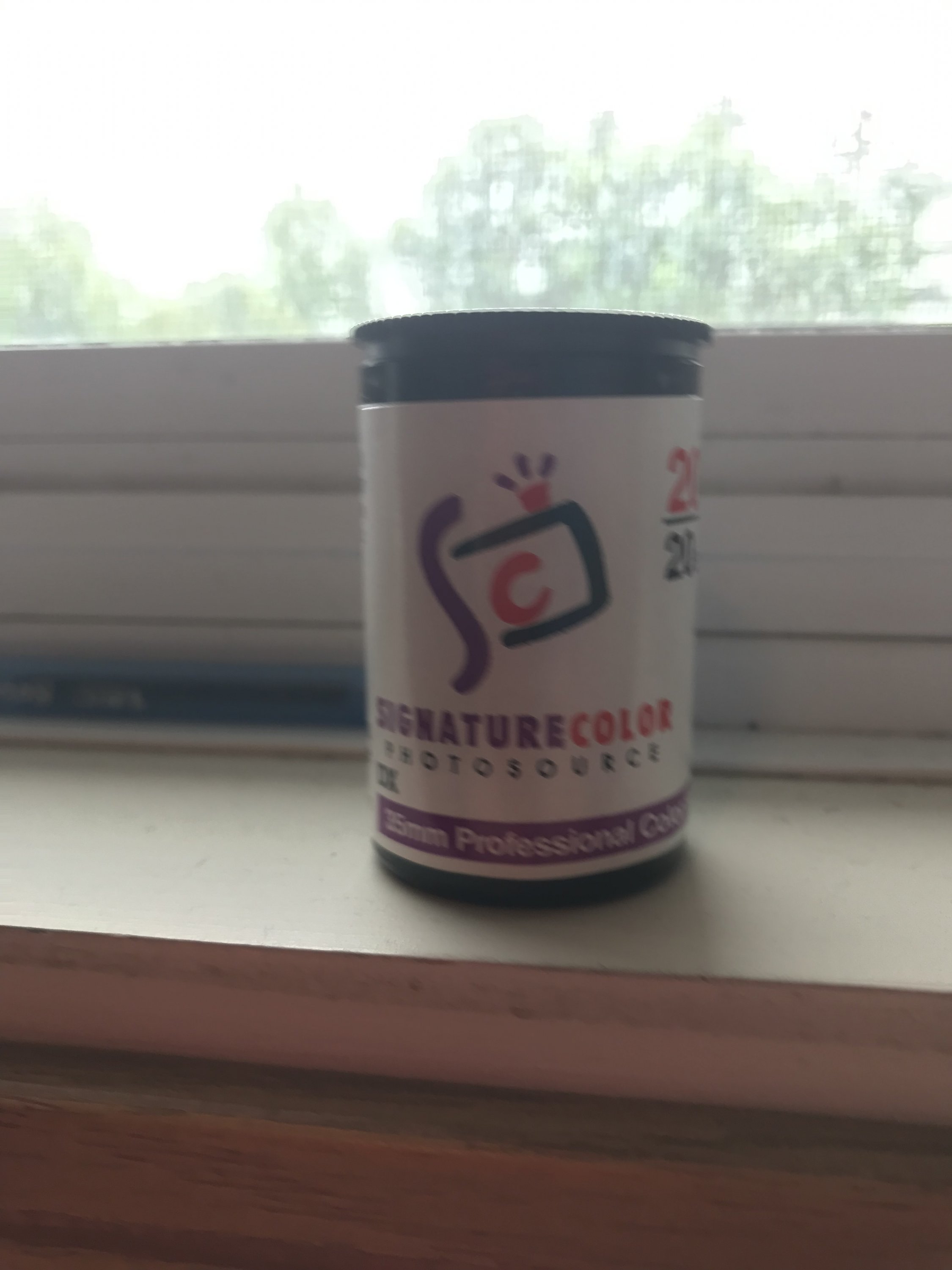

Only firm making colour film in Italy was 3M Ferrania. at one time 3M did have a film finishing line in the USA. the canisters in the picture don't look like 3M, which were tapered at an angle - those are straight.
if it was 3M the film is very likely ten years old by now.

alright, I'm prepping to use the first of the two rolls sometime in the near future. the first one's going to be my iso 200 film. since it looks like signature was founded in 96, you think iso 40 would be a good speed to shoot it? (also, forgot to mention they're both 20 ex. rolls).
both are dx coded, the base of the 200 kind of looks like tmax. the base of the 100 is a light brown.

"Made in Italy" -- that's Ferrania. They produced a lot of store brand films in 35mm, 126, and 110 before their bankruptcy. Like Kodak, their bread and butter was cine film.
yes, 3M had a US based conversion facility when they owned ferrania, (or IMATION) so "made in Italy" almost certianly will give you a Ferrania film. (the shape f the Film Can is also a tip off for 3M/IMATION film. The Business was mostly in private label film, I have used that sort of film from Arista, Zellers, K-mart and Sears..

Ferrania also made the C-41 film sold by Seattle Filmworks in its latter days. It was labeled “Made in Italy”.
