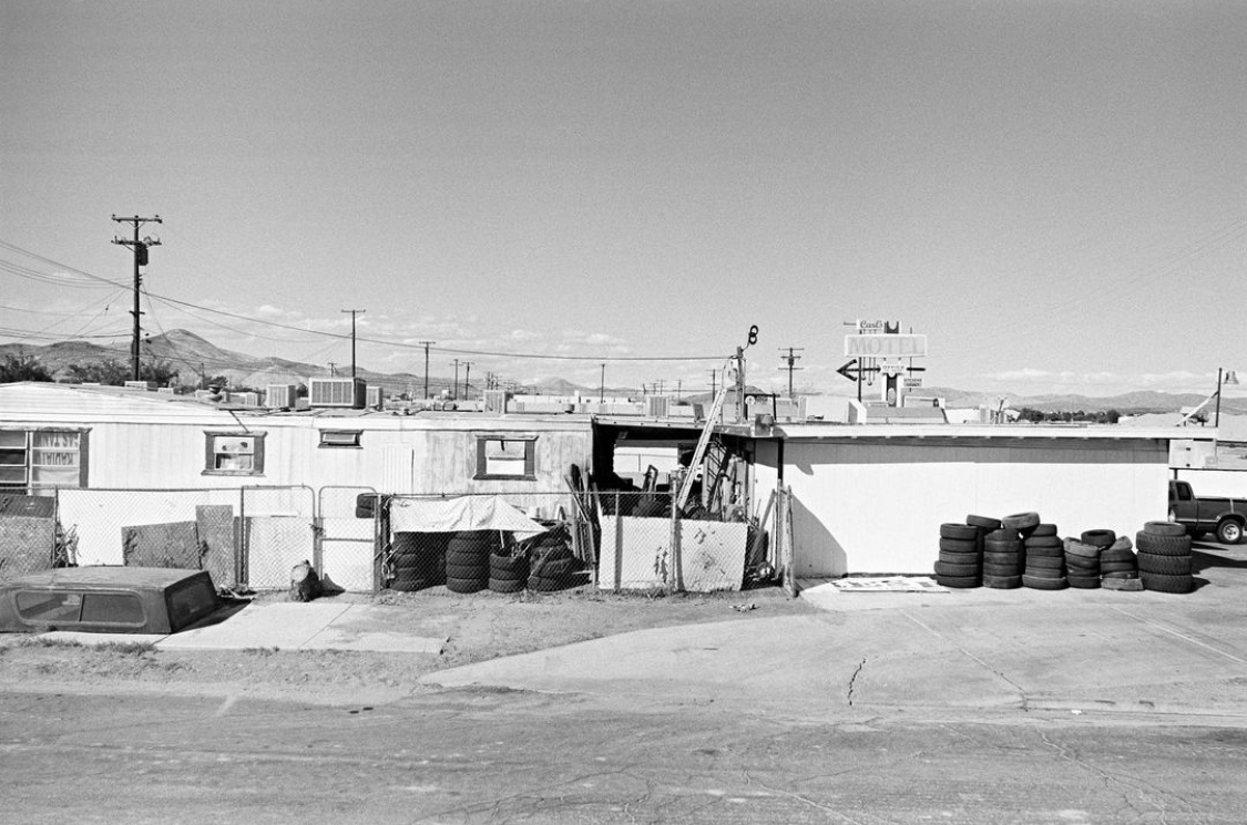

OK, I have a wild theory that I'll throw out here:
At first glance I thought the problem areas of these bands were the darker/negative density areas. But looking closely at the tones in the upper and lower parts of the sky, it is the areas of positive density that seem out of place to me. Now, when I developed this roll of film, I used the 1530 extension to my 1520 tank to allow the tank to balance more evenly on the Jobo roller. This is the first time I've used the tank extension. I'm wondering if the locking ring that joins the two tanks together wasn't completely seated and that allowed light to leak into the tank during development.
Looking at the inner edge of the black locking ring, there are alternating vertical rectangular-shaped 'gaps' in the plastic. Is it possible that an improperly seated ring could allow a bit of light to leak into these gaps and leave rectangular high-density areas on the film?
The fact that the bands are perfectly perpendicular to the edges of the film and that only two frames on the innermost part of the reel were affected seems counter to this theory, but just thinking 'out loud' here...

I think those bands originate at the camera stage.
What makes you think that?
The location and direction of the banding - parallel to the film edge and only within the frame.
Development artifacts don't stop between frames on 120 film.
It could possibly be related to film and backing paper interaction, but it doesn't look like tat to me.

500ml should be enough chemistry.
I haven't seen this issue when using my Hasselblad or the 50mm Distagon lens before, but I guess it's possible. At this point I'd actually rather this be a camera fault than a development issue. Probably easier to track down.

Re: the original negative density marks - have you ever processed c-41 film with your equipment? I have had similar marks on my bw negatives when sharing a final rinse bath with c-41 negatives that were poorly processed and not realized until after I hung them up to dry. A touch of bleach somewhere could lead to negative density spots.
Re: the banding, I have a feeling it’s a shutter problem from your camera. I get similar banding with my M6 in the top left corner if I use high shutter speeds. 1/500 and 1/1000 will give horizontal negative density bands. I’m not familiar with your camera or how that would translate from a 35mm frame to 120. Would be pretty simple to test, just shoot half a roll of sky exposures with 1/30 shutter speed and the other half of the roll with highest shutter speeds.
Picture attached has the banding visible in the top left. It’s faint but enough to make me frown.

This is unlikely, but is there any chance that you are using the same backlight for both visual inspection of, and digitization of your negatives?
If so, try another light source and see if you see any changes.
Sort of like struggling to clone out a dust spot in a scan, only to realize that there is some dirt on my monitor screen!

No, I'm using a flatbed scanner for digitizing my negatives and a lightpad for inspection of the negatives. But I've had similar experiences to your cloning experience. I've also discovered 'defects' in my negatives when inspecting them, only to find that there's a piece of dirt on my lightpad or a small hair inside the Printfile sleeve 🙂

Banding can occur in focal plane shutters not lens leaf shutters.

Banding can be caused by bromide drags. A certain kind of bromide drag can occur with rotational development. If rotation always takes place in the same direction, potassium bromide can concentrate - following the film winding - on the inner turns of the reel and hinder development there. It is therefore important to change the direction of rotation regularly during rotational development.

Thanks. I mentioned early on in this thread that I changed the direction of rotation every two rotations.
Interestingly, when I asked Jobo USA about usage guidelines for the Jobo roller, I was told that there's no need to change directions. I did so anyway.
FWIW, I just scanned a roll of 35mm film that I developed using the exact same technique and there was no banding on that roll.
