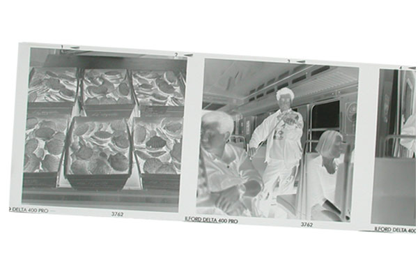

Maybe I am going blind but I can't see any banding in the images.
Could you mark the banding with a red pen in Photoshop?
Also can you show a backlit image of the negatives, please?
Something like this:
On the first image they run vertically through the left half of the cloud formation. On the 2nd image they're also in the same spot, around 2/3rds from the left.

I cannot see the banding on any of the photos.
It's there, clearly visible to me. Sometimes it helps to scroll your screen/window perpendicular to the direction of the bands; makes them easier to spot. Or copy the image in Photoshop and boost contrast. Neither is necessary for me to see those bands, though. They're pretty obvious.
For those of you having trouble seeing the banding in the photos, I've outlined the areas in red below...
