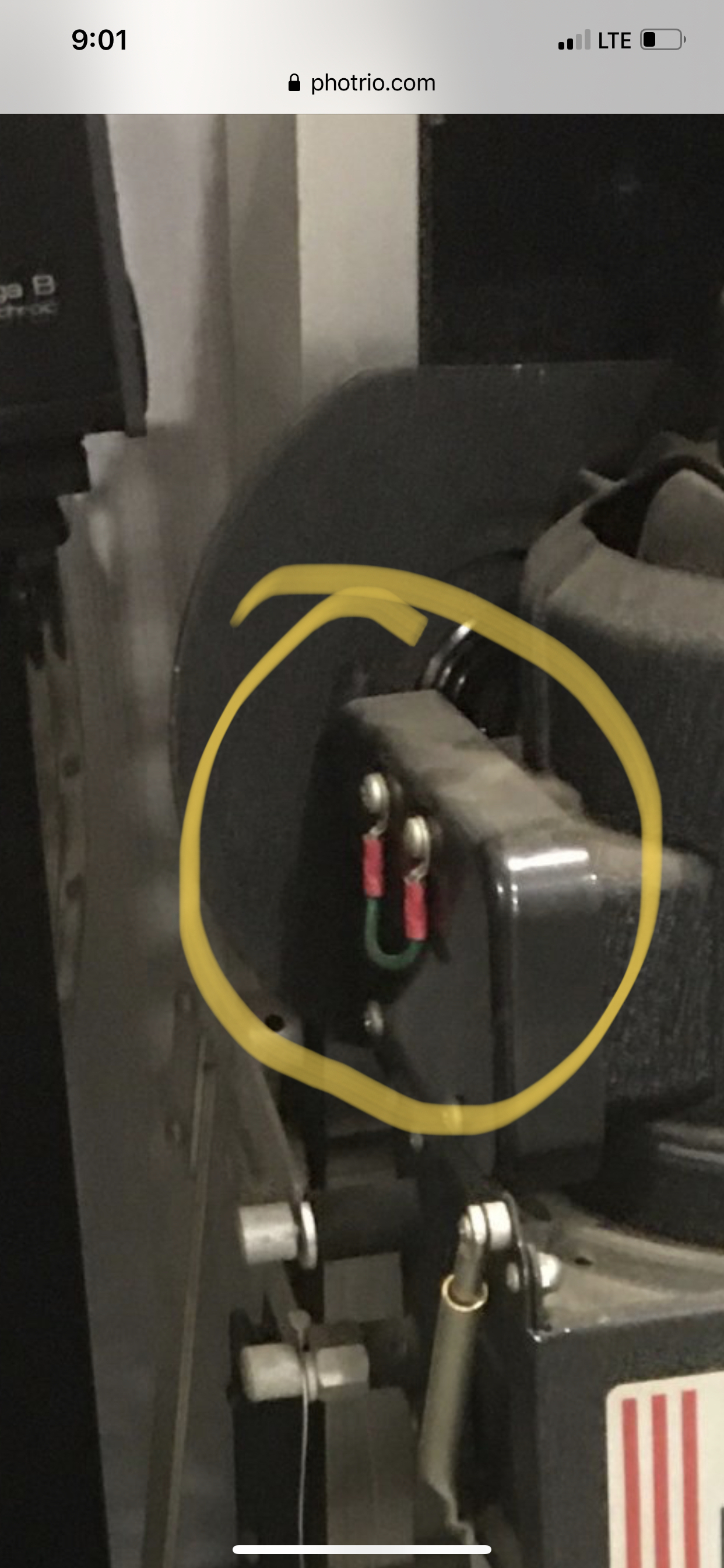

That is a broken cover for the lamphouse power cord connectors. It's made of Bakelite and a lot of these enlargers I run across in thrift stores have just this problem, but a replacement cover can be fabricated without too much fuss...
The light baffle I get. Power cord goes through the top. What is the little green wire with the two red insulated lugs screwed in with it? The baffle looks intact.
There simply isn't enough visual information to determine if it has been modified...
OP found it at a surplus store, State, Federal, U of A? When released in the early 50s the D2 had a two prong plug, might be a ground that was added. To find out the cover needs to come off.
Those side covers are light traps. Maybe the loop of green wire was for hanging something.
My thinking is the loop is a ground, a ground wire was connected to it by one of the screws and then attached to a outlet's mental screw that holds the plastic cover on. My D3 has the original 2 prong plug, last few years I've been thinking about taking to a lamp shop to replace the 50s vintage lamp with a new grounded unit. After 60+ years the cord is still in very good shape and I've never experienced a shock. My Sander's 6700 has a 3 lead grounded plug.
