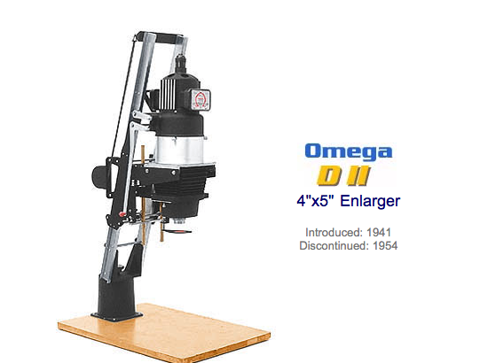

The enlarge pictured in the first post is a D2 not the DII ("old D2 designed in 1941"). This D2 is a direct descendant of the D5 which was produced until recently.
Although [New D2] was effectively discontinued in 1975 when the D5 was introduced, there was one last production run in 1977. It remains popular on the used equipment market since it was solidly built and most of the major parts for it are still available.
Old DII for comparison to the enlarger in the original post (which is the new D2):
