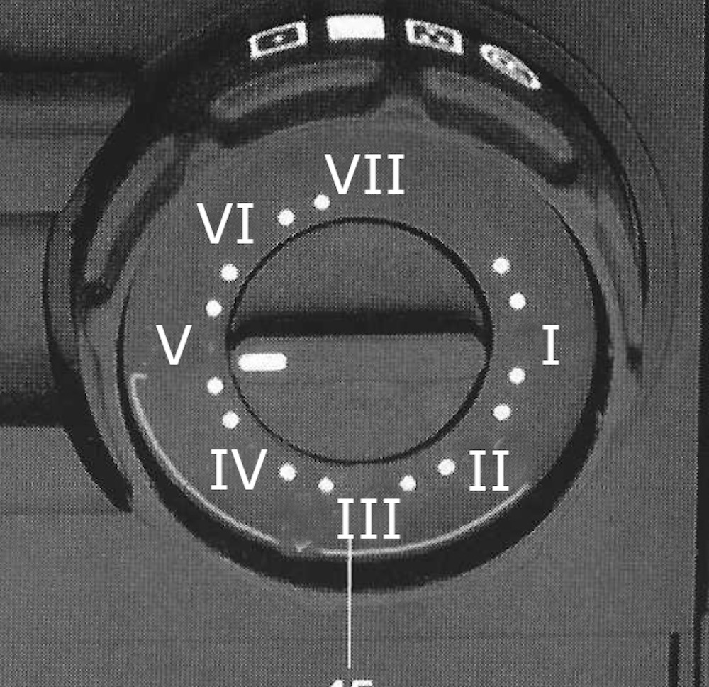

This is how I meter with my Sekonic. The number in the viewfinder is exposure compensation. I use it as my "Zone" for which I am metering using the conversion sticker I placed on the meter*. Due to the wide angle of acceptance (1 degree won't show a uniform value in any scene I have photographed) I almost always meter at Zone 2.5.
*I keep referring to that sticker because this meter is a little backwards compared to my SLR cameras with spot meters. In My Rolleiflex and Nikon cameras with built-in spot meters, one would set the compensation to Negative 3 to read Zone II.
Proposed zone sticker for the exposure compensation dial on a Rolleiflex for Zone metering with the built-in spot meter.
