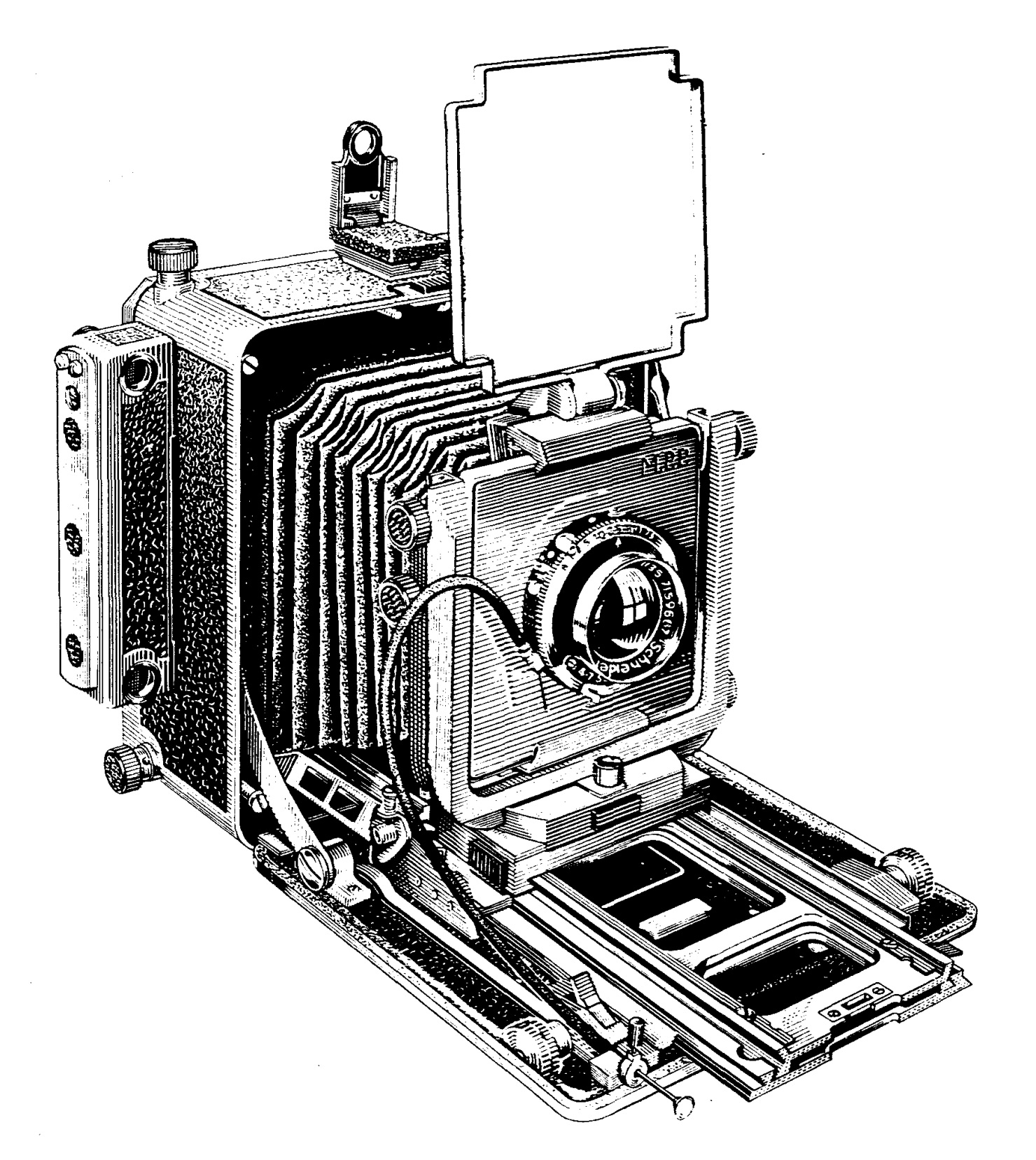

Something like this?
I've used this a couple of times with my MPP. Press cameras often had these wire frame finders.

The one I was thinking of is the Graflex Crown Graphic Press Camera.
Another wire frame viewfinder.

totally what I had in my head!!! does it exist???? my Chamonix has a flash hot shoe on the front element (they prob all do haha) so would have to be something for that.....
I shoot LF hand held, initially using a Crown Graphic (now sold) but then with a Super Graphic. The wire frame finders are built into these Graflex camera, unlike the MPP's where they are add on accessories.
Because the wire finder is part of the front standard it remains accurate enough with 90mm to 210mm lensesm and I can frame quite tight. I focus & compose on the GG screen, then close the shutter, stop down, and add the film holder, it's a quick process, less than 30 seconds.
You can either pan hand held, or use a good tripod head.

In the 40s, 50s and 60s a many action shots were taken with 4X5 press cameras. In World War II Army and Marine Corps photographers shot with Speed Graphics without rangefinder. The wire frame is often referred to as a sports finder. Lens were often somewhat wide, 127 or 135 to provide room for a crop. The trick is use the rangefinder to pre focus on the spot you pick as the point of action. If far enough way just focus to infinity. If you have a Speed Graphic with focal plane shutter make sure the shutter speeds are accurate. With Tmax400, Trix, or Delta 400 or HP5 at box speed in good daylight lighting, 1/500th of a second at F 16, with focal plan shutter at 1/1000 F11. If you are shooting backlit then you will have to adjust by 2 stops or so. Tricker at dawn or dusk, just try to keep your shutter speed up as high as lighting will allow. Unless you are forced to shoot at 125th or lower handheld is best. press cameras were designed to be hand held. If shooting with a monorail, pick a 135mm lens, heavy duty tripod, shutter cable, use the ground glass to pre focus on the point of action, ,make sure you have enough room in the shot for a crop. You have time you can make a DYI sports finder, not sure how you install one ona monorail.
Both my Graphic and Bush press cameras have sports finders, the sports finder is comprised of a front wire frame that fold up or pops up from front lens standard and a back finder that fold out from the top of the camera. Both are use for better accurate framing.
