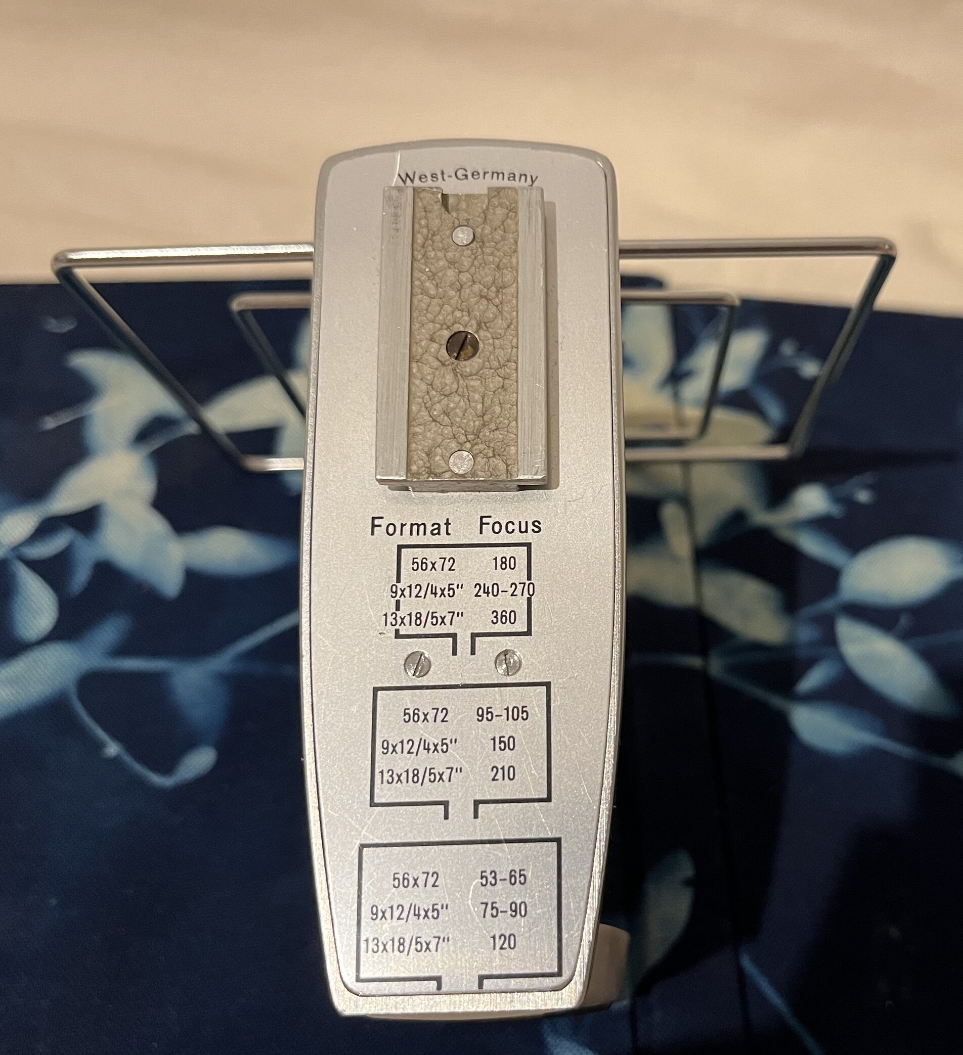

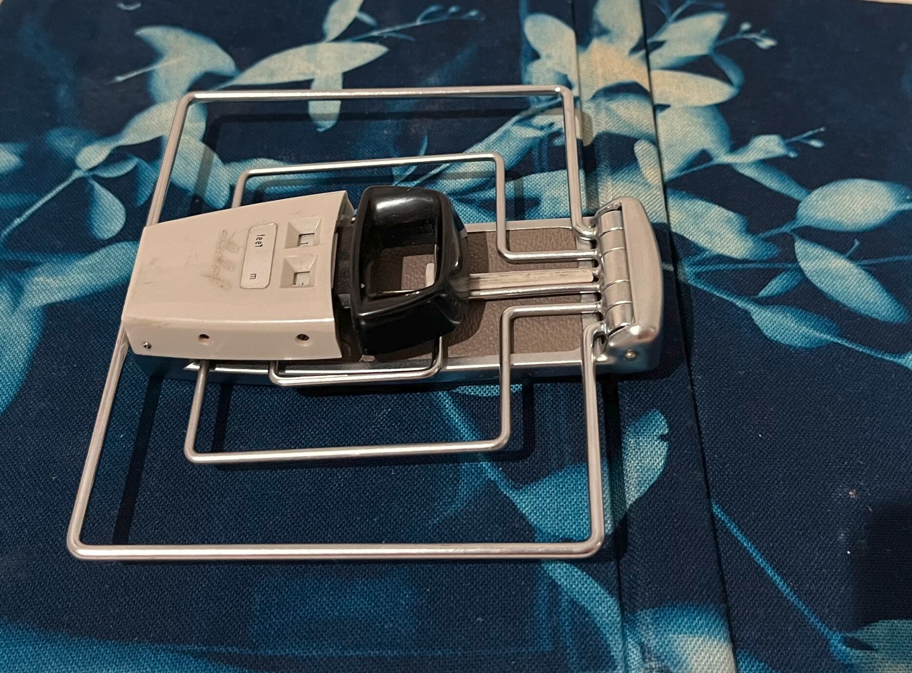

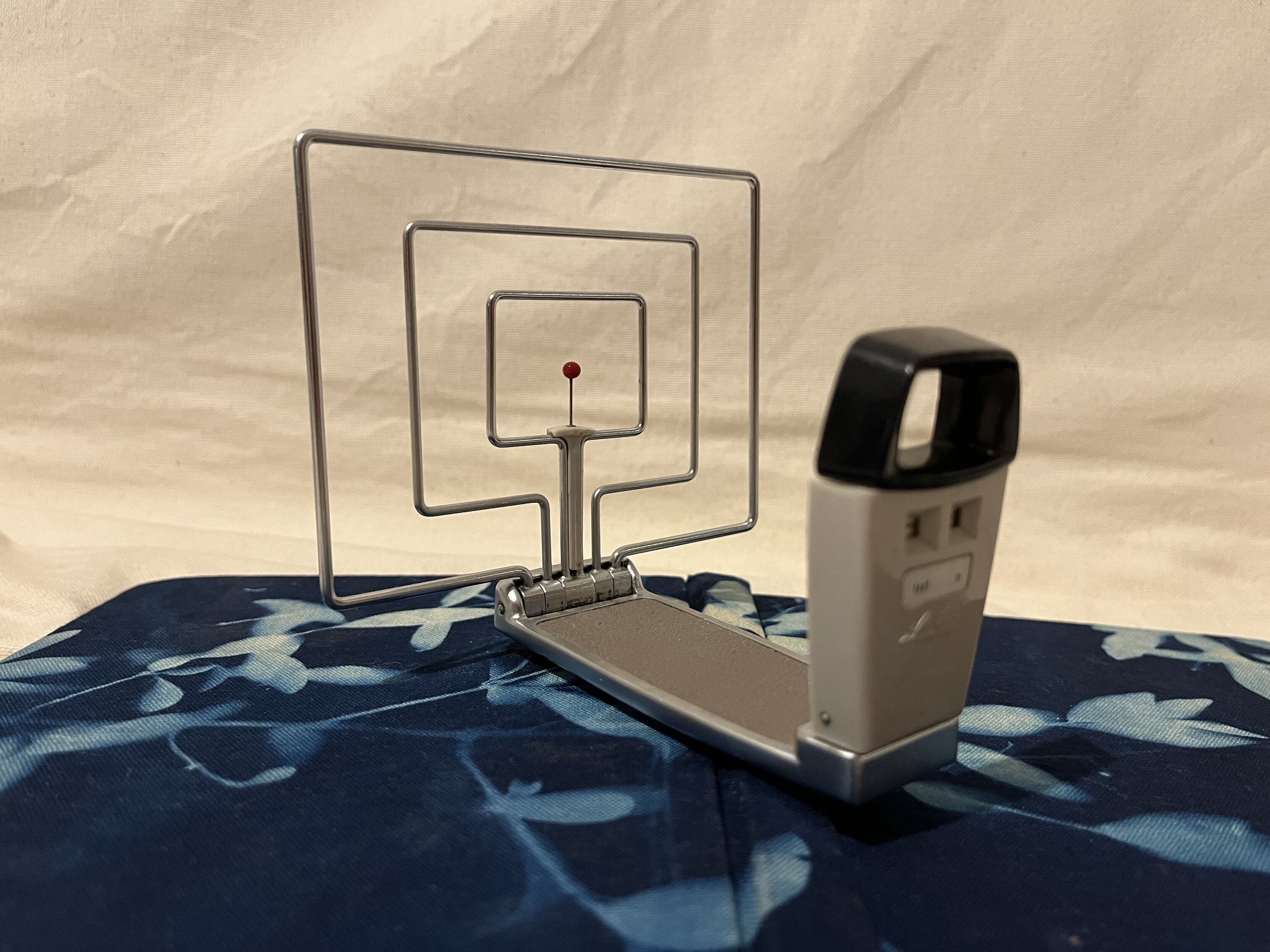

I like the linhof sports finder very much:
I also use mine to frame before I take the camera out of the bag. Mine has an additional frame for wide angle lenses (75-90 mm).

I don't know that guy in the link but it shows the linhof sports finder I like very much:
link to ebay: Linhof Sports Finder
interesting....like a director's viewfinder......
Ian Grant
Aug 2, 2004
23,286
West Midland
MPP made them as well.
